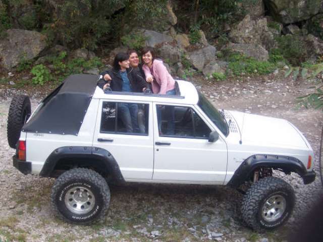

never can tell buttons.....reg cherokee??...hehe
