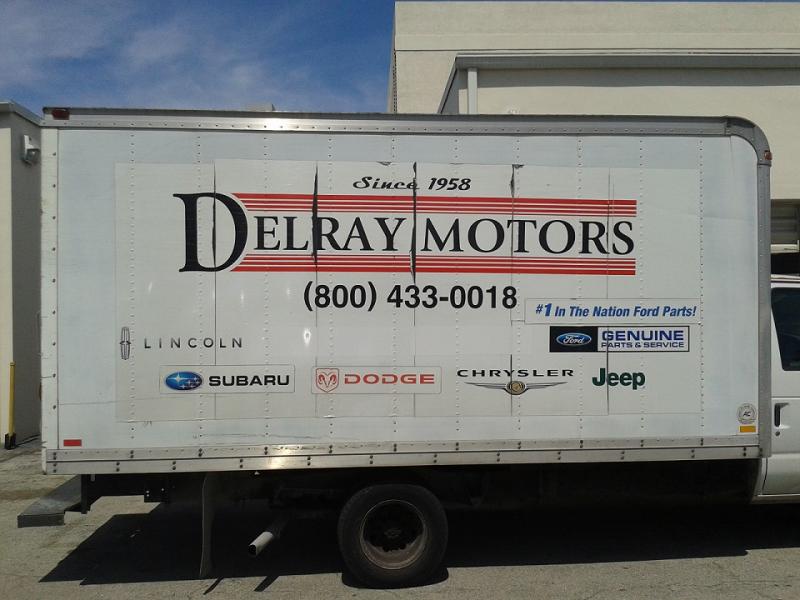

I went to look at a job yesterday from a regular customer and he asked me to price removing the graphics on a box truck. The graphics had started to peel up and underneath there is a black residue. I've never seen this before and have no idea how much of a pain in the hind quarters this will be to get off the truck. Any of you guys had experience removing stuff like this?
I plan on quoting him an hourly rate for removal but I am sure he'll want some sort of estimated time from me.

Give them an hourly rate and tell them it is a 2 hour minimum start. And then after you work on it for 2 hours you will know better how it is coming off and long it will take you to finish. to let yo to let you proceed with the full remov with the full removal.j

The easiest way to remove is a ..Steam pressure washer ..2nd easiest is a Steam Wallpaper remover ...Wagner sells one $50 sure there is others.
Then Rapid-Tac glue removal......
Caution & WARN customer that some areas may peel background paint cause of poor paint prep or base paint... but it will happen any way ya take it off.

My main reason for posting this question is that black stuff behind the graphics. I've never seen that before and was worried about that. I've removed a bunch of graphics before and this is the first time i have seen it. Did the previous graphics guy use some really cheap stuff?
You mentioned he's a regular customer. Was this done prior to his being a regular customer ?? If so, how long had he been a regular customer or how long is that stuff on there ??
If you didn't do it, perhaps the other installer put black vinyl down first for some unknown reason for a starter step of some sort.

The black stuff is most likely just soot & dirt that is sticking to/embedded in the adhesive residue. Heat it up good and pull that wrap off. It will probably come off easier than you think. I like to use the mega torch (weed burner) for jobs like this to quickly heat a large area before pulling it off.
