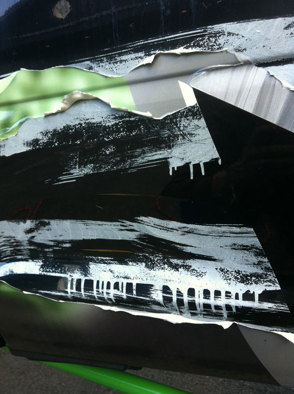

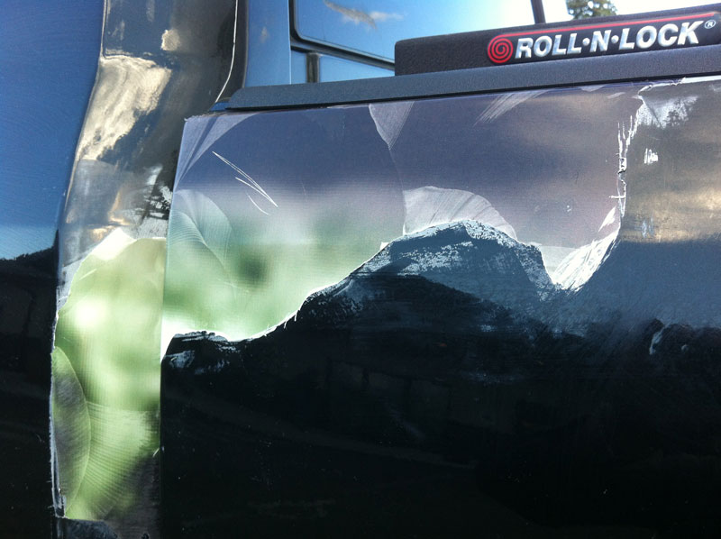

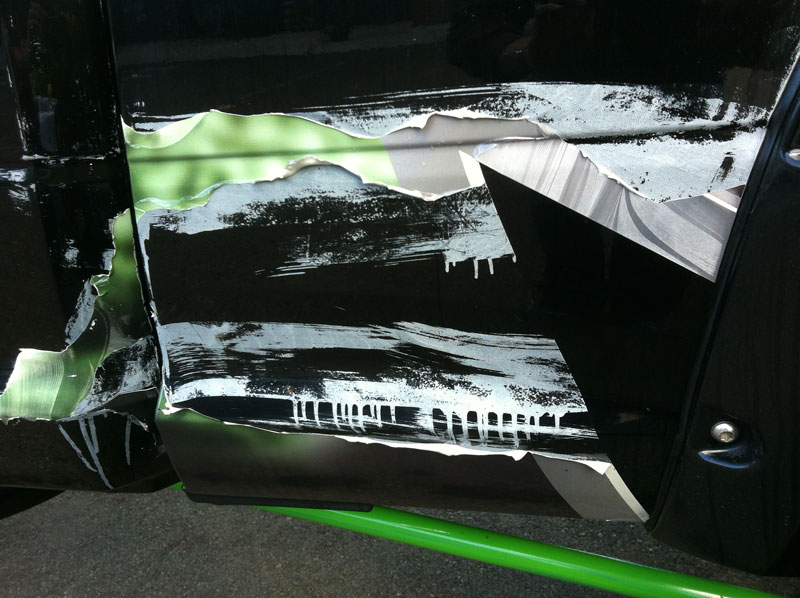

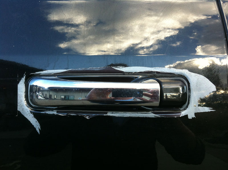

A customer hired me to remove vehicle wrap graphics since they sold their truck. A different sign company in town did this wrap and they used Arlon. One side came off fairly clean, but the other side is coming off horribly. It's like the adhesive and the truck have become one and it will not come off.
I've used heat and it doesn't seem to work. And where it will come off, it leaves the adhesive on the truck. And the adhesive doesn't seem to gel up like most adhesives do with RapidRemover. I'm not sure what to do to remove the rest of these graphics so any help would be appreciated.
I've attached some pictures. In one picture you can see drip lines in the adhesive that makes me wonder if the last sign company used some sort of adhesive along all the edges. Is that possible? Along all the edges is where the trouble is.

Wowza! Looks like someone went nuts with primer 94 using a big dripping wet paintbrush. Lol, that's gunna su"k. Sorry but you have your work cut out for you. Gallon of xylol, get a rag truly sopping wet with it, keep the primer and adhesive wet for a minute or two, use a white chizler and scrape a layer off, repeat many many times. Careful with the xylol around any plastics, rubber trim, etc. The car will be in severe need of a wax job when its done. Hope you quoted hourly on this....

Thanks for the suggestion. I tried he Xylol idea for about an hour this evening. I was only able to get about 8-10 sq/in in about 1 hours time. There are a good 300+ sq/in left. I sent them an email this evening informing them of everything to see how they would like me to proceed.
