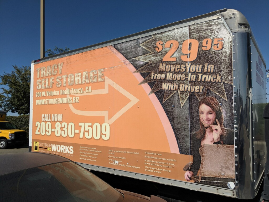

does anyone have a fast method of removing old cracked vinyl off a trailer? Will products like vinyl off help in speeding things up? Or are there any other chemicals / solvents out there that could work? And has anyone tried Weldon 3 or 4 on stuff like this before?

Hot water pressure washer
this works good, have tried scrapers, soaking, steamer, zapper, etc. the pressure washer is the most efficient.
* it makes a MESS, make sure you do it where it is easy to clean. That vinyl turns into a MILLION little peaces that go everywhere.
* it gets LOUD with flying debris, wear protection.
see if you can find a local 18-wheeler cleaner, they should be able to do it for you

Regardless of which method you end up using, it's helpful to have heat lamps on the inside of the trailer
pointing towards the side you're working on.
