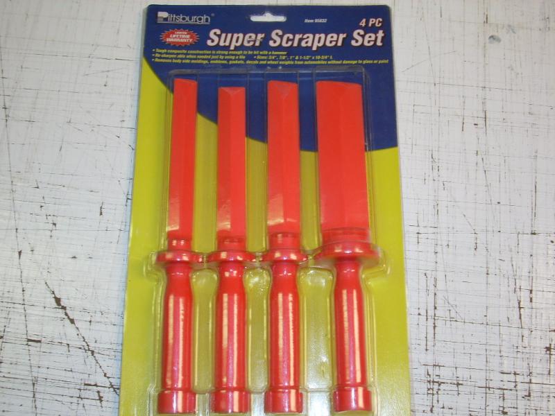

I used a set of these and a heat gun on a 3' x 48' implement dealership sign with 10+ year old vinyl on it. I also used them on a 15 year old motor home to remove the old factory graphics with no heat (did it on a HOT day in direct sunlight).
You can get better leverage for scraping and the length allows you to keep the heat on an area without burning your fingers.
When they start to dull I sharpen them by pushing them over some 220 grit wet/dry sandpaper.
I picked them up at Harbor Freight Tools on sale for $9.99.
Just trying to add to the conversation.
