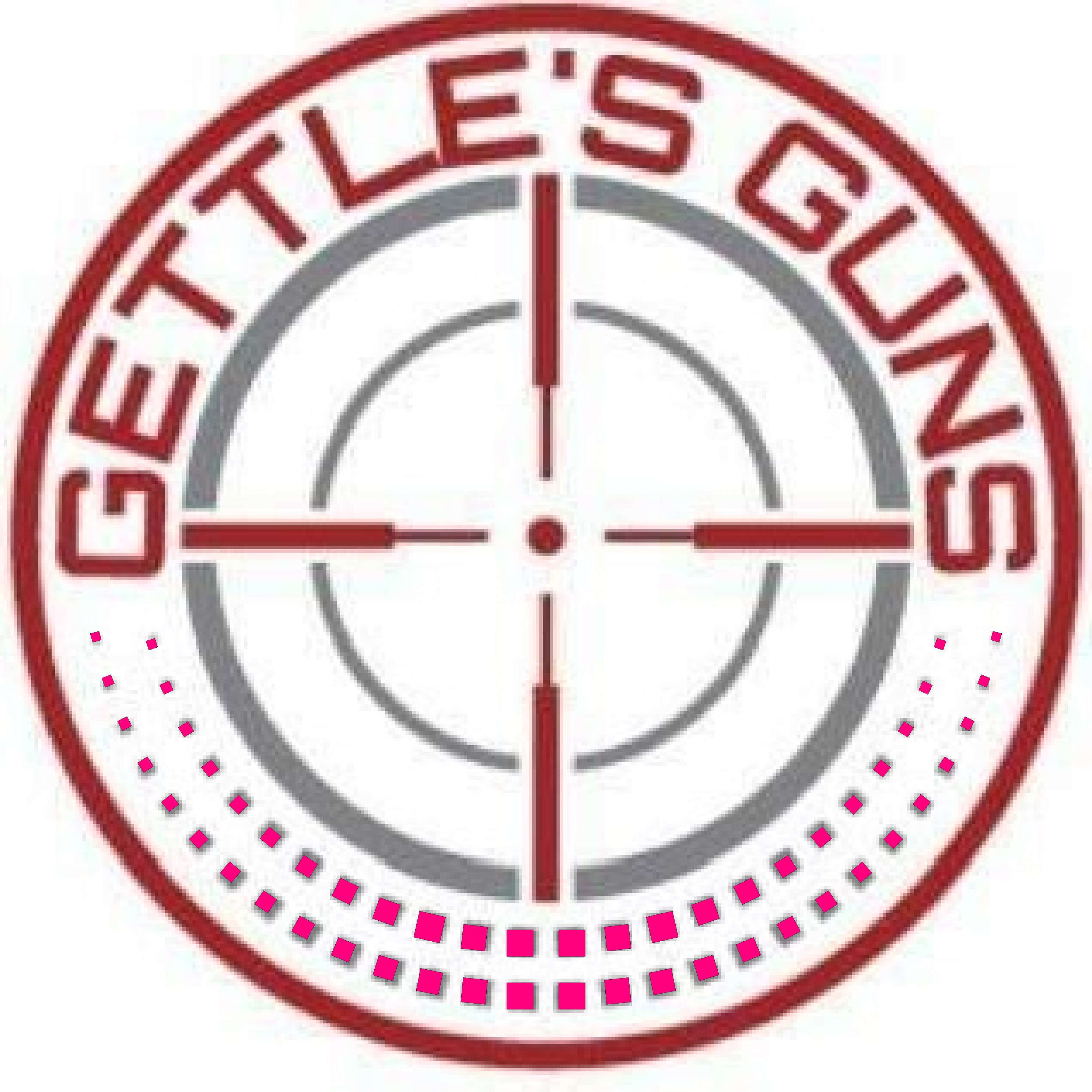

How does this look? Squares in magenta.
  • hows this.pdf
Signarama Jockey
Looks pretty close nut you have a couple that are out of size in the progression
Yeah, that is the really tricky part. If you want, he can take the .pdf and try to adjust the sizes.

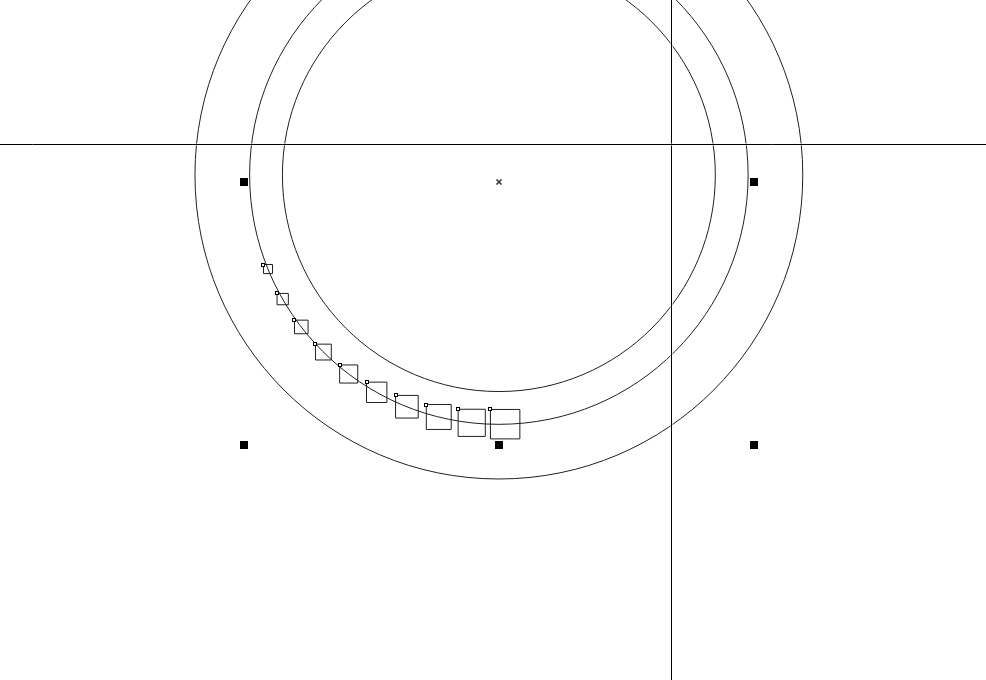

Draw a circle that matches the path of your objects. Draw and place your big and little boxes. Select both boxes, then use the blend tool. Select apply to new path icon then select your circle. You can then adjust your steps to match the existing.

Dude, I appreciate that! I was not expecting anyone to do the work! Thank you! I hate this logo as well...the kerning kills me!

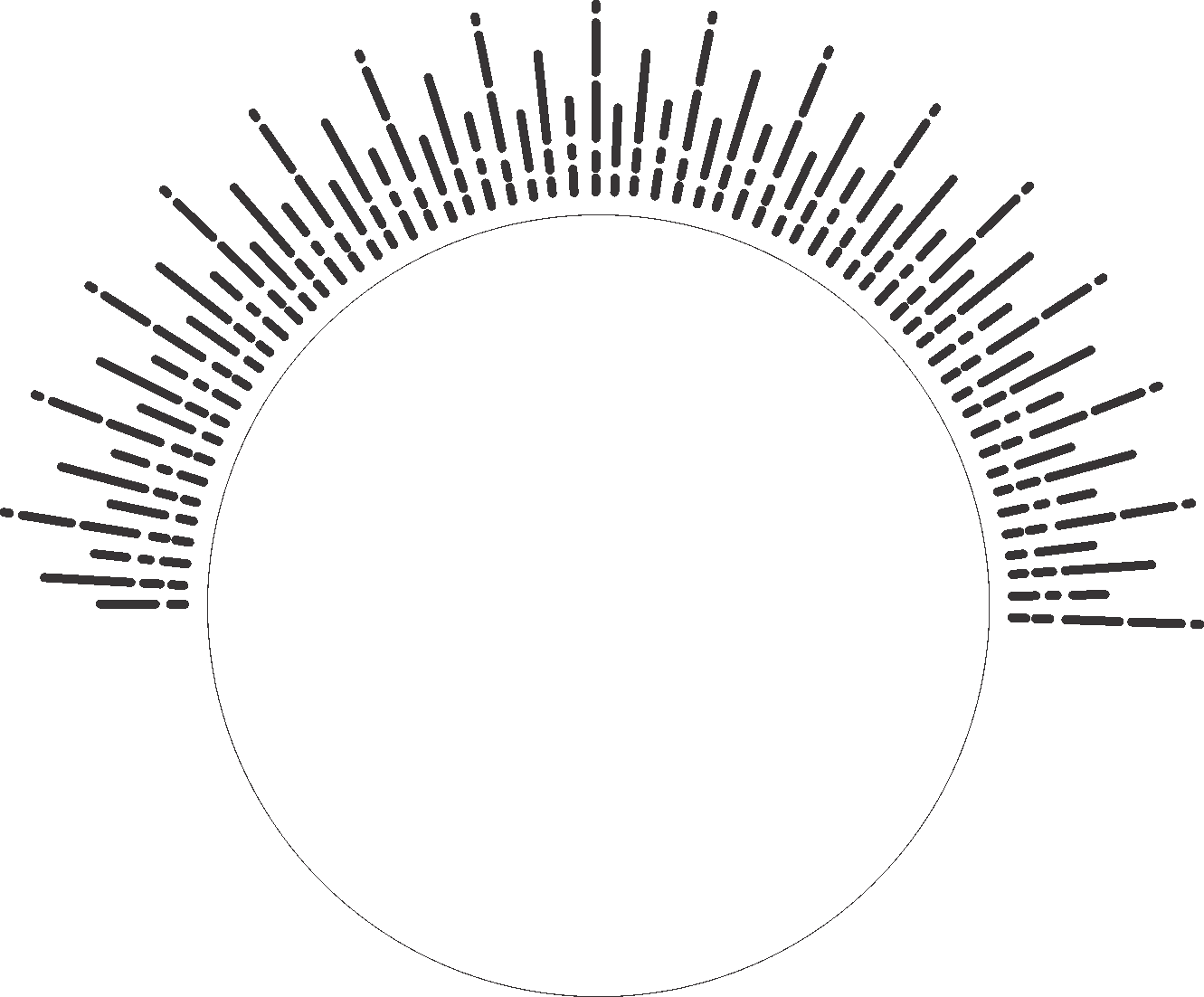

Stacey, will one of these work?
  • Rays.pdf
JBurton
Signtologist
This one is easier, make it out of strokes, rotate 3 degrees between each. In corel you can change the center of rotation to be the circle so it doesn't go all sideways.
  • better rays.pdf
Stacey K
I like making signs
Jeepers! I didn't expect this, thank you! I'm going to try what you said, this won't be the last time I get some crazy thing like this!
