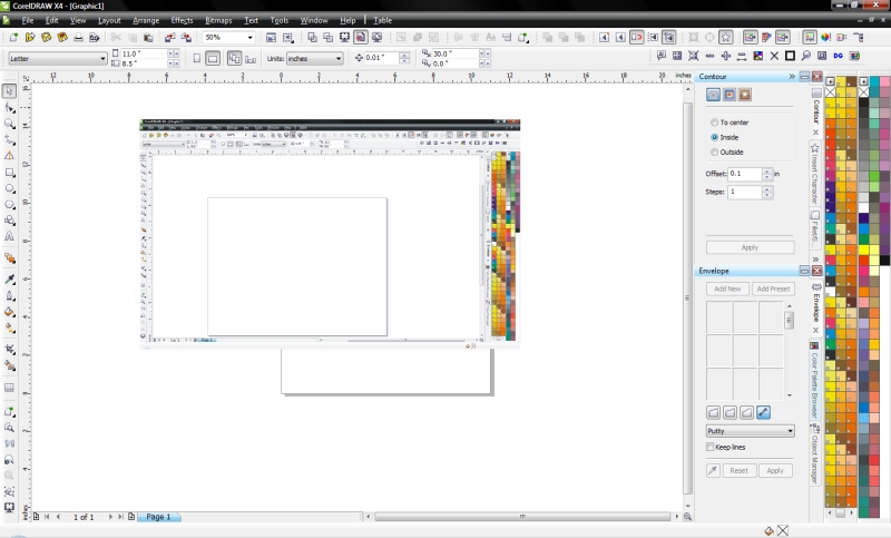

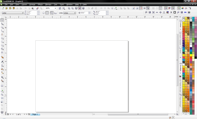

No more drop downs X3 and X4 they are dockers. They lock on the right side and toggle between several.
I love dynamic snapping too.

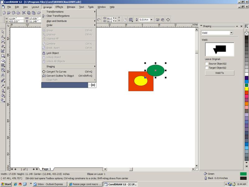

Here is a screen shot of what I would like to have. Sometimes I get doing something that I have to keep clicking on the drop down menu to accomplish a repetative task. If I could pin the drop down(or flyout) it would speed things up......wouldn't need a docker.....
BTW Corel 12 has those dockers . I just found this such a useful feature when I had it in Geoworks that I miss it. It was in the operating system so, as I recall, it worked on all programs.

rcook99
I have found that most of what you are looking for will either be open in your tool bar if set up correctly and if you can't find it on your toolbar try RIGHT clicking and you will get a flyout from your cursor that will give you many other options instead of always going to your tool bar. Maybe this will help ya.:thumb:
signmeup
The "order" button is a big one for me. I sometimes need a few tries to get things in the right order when copy/pasting and trimming etc. If I could pin the drop down with "order" in it it would save me time. I know it sounds dumb but I found this "pinning" a very useful feature.
