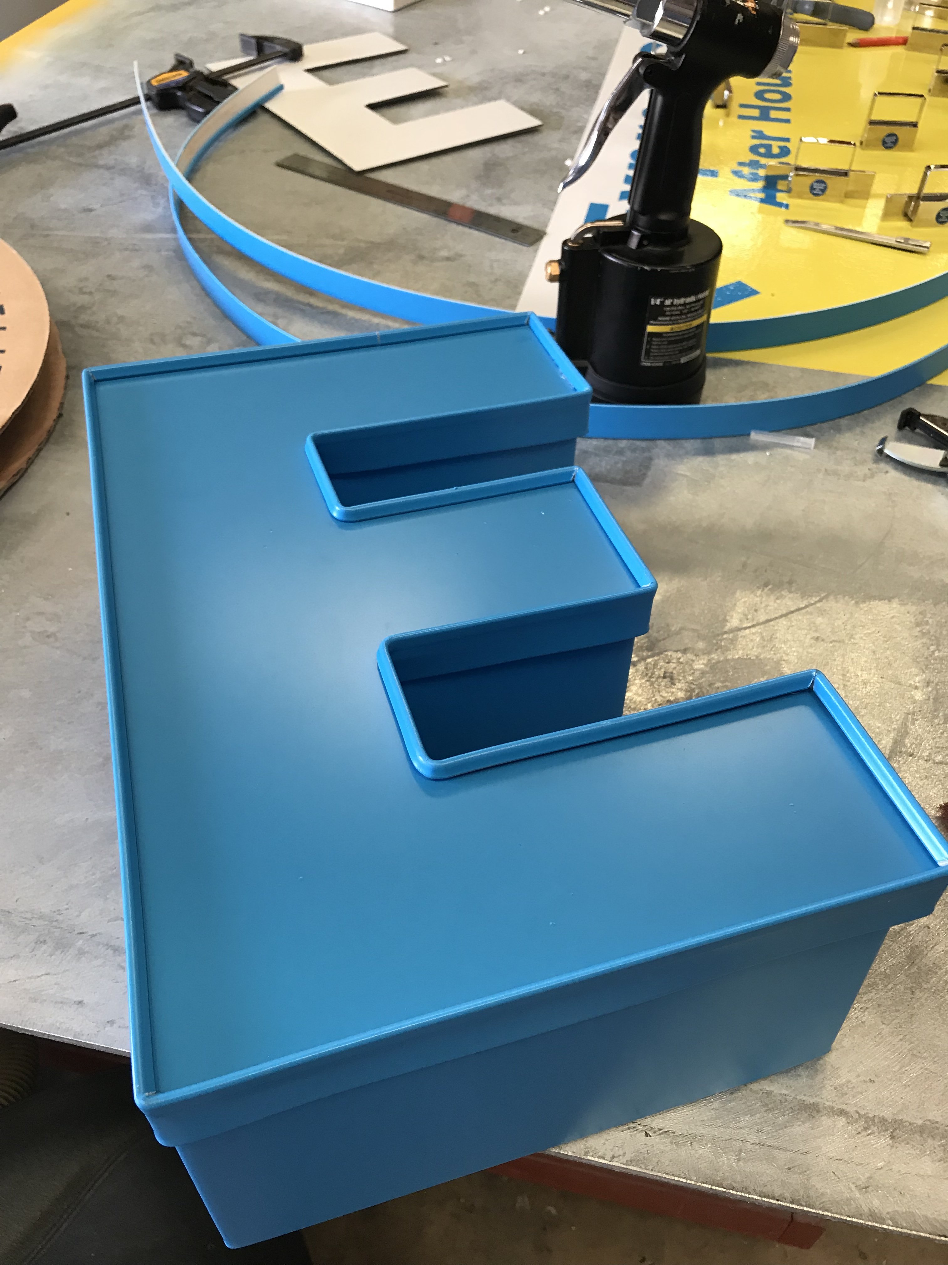

So I have a client right now wants custom painted returns and trim cap. Question is do I paint the return before it’s bent or after? What about the trim cap?
petrosgraphics
fabricate your letters, mask-off your lexan backs on the outside, place the letters upside down and spray them the color you want. ( try and use a Mathews type paint ) For the trim cap try and find a stock color that will work.
Robbie Moore
Painted trim cap with Mathews and flex Additive worked perfect!

Robbie Moore
Painted return and trim cap
