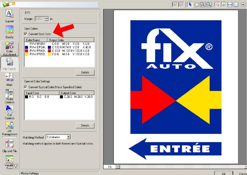

Why don't you just simply use the rich black from Roland's color palette?
RVW-BK22A
The only thing you have to make sure is the settings in File Format tab... Spot Color must be checked so that way Versaworks will use the colors assigned "as it" w/o considering the profile tweaking ('hope I'm clear the way I translated it...)

Thanks for all your replies - d'oh I never thought about the Roland color palette. I wasn't so much looking for a black 'formula' (everyone has the favorite, it would seem) but how it's handled in Versaworks. The Roland palette answers the question!
