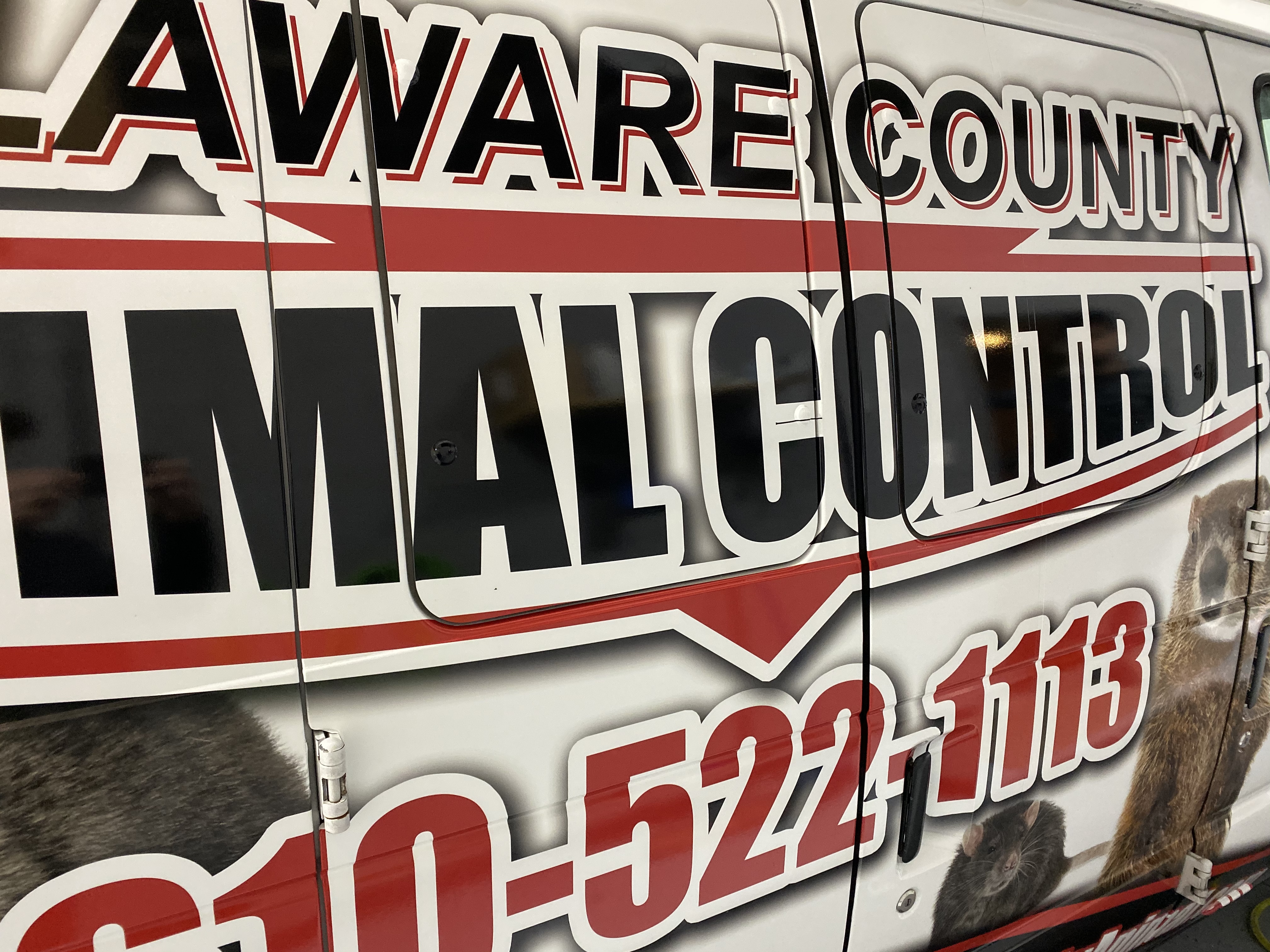

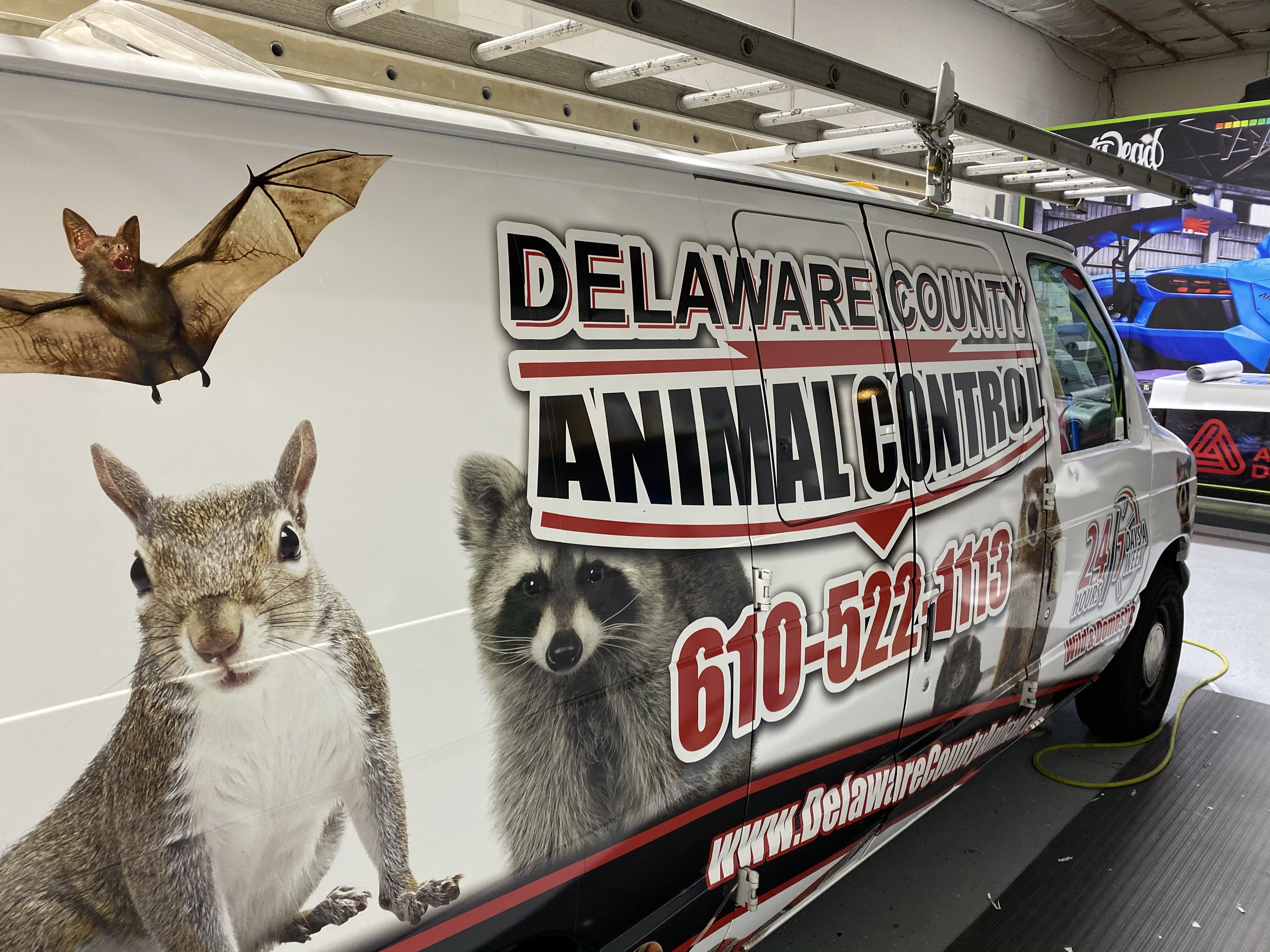

Your blacks look greenish? Do you build your files in cmyk or rgb? I’m guessing cmyk. I always work in rgb, the rip will convert everything to cmyk. Running a color calibration on your 335 should resolve that.
The other thing to look at is your build of black. You don’t need anything more than 30/30/30/100 I use 20/20/20/100

It is one of the things that always annoyed me about the HP is that great black has to be a combo of colors. Would be great if 100% black was black without emptying the tank.

So what is wrong with 100% HP Latex Black? I set black output value to 100% black all the time and it looks pretty good. Never found much advantage to set the output values to 20/20/20/100 as it looked visually the same, and anything more looked worse because you started hitting the built in ink density values and were probably not getting 100% K any more.
When you print the calibration target what is wrong with the black patch? It looks fine to me.
