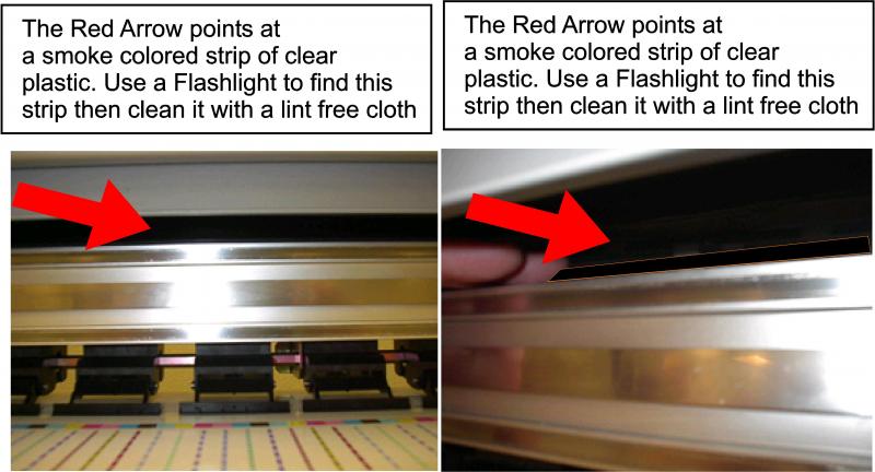

Stealth Ryder
Cleaned all the parts suggested, except I'm not sure about the timing fence and can't find it in the manual.
Can you point me in the right direction? Thanks
Stealth Ryder
Stealth Ryder
Sure, see the attached pic

Bannerday
No good news to report. Cleaned the all parts suggested, lubricated as suggested and still no go.
Kills me, but I'm out of ideas and I'll have to get a tech in.
