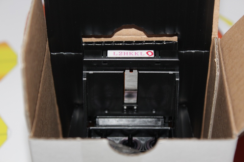

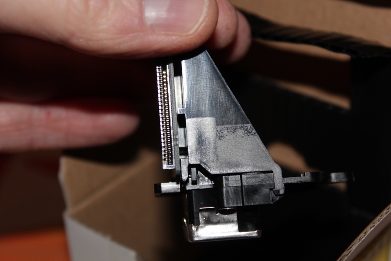

HI,
Received a new color head and wanted it to replace.
When I unpacked it I first looked to find the head rank number.
Oohps not as mentioned in the manual at the left side.
Only number is at the top and it is not 5 digits and has also letters.
Any one else came across this?
I already emailed the supplier but this can take some days due to the year switch.
Paco

I just got one in with the same thing on it. I am waiting until Tuesday to call and find out what is going on. Where did you get yours from? Mine came from solventinkjet.com. They have been good and I'm sure they will take care of this right away.

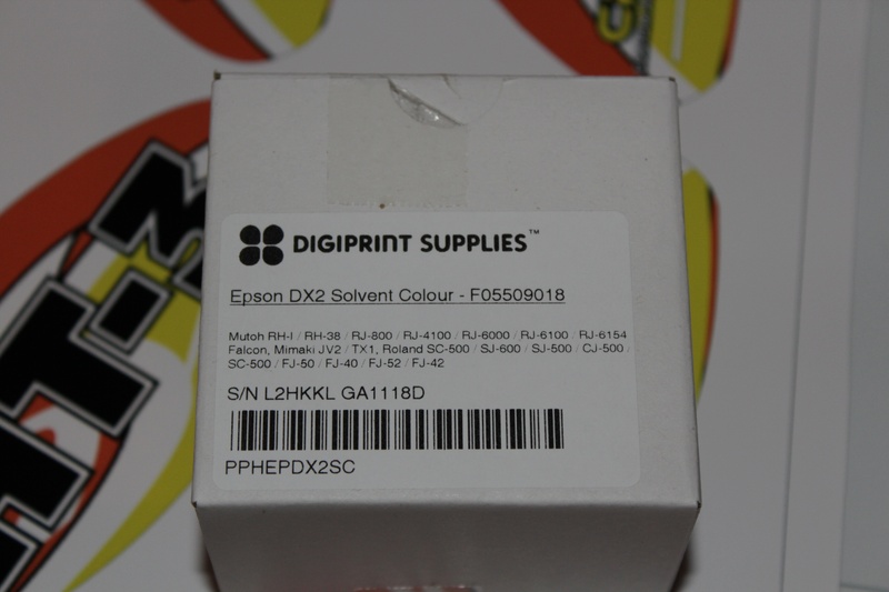

CRD
Mine came from Digiprint supplies in Belgium.
See picture for the info on the carton.
No head rank number except for serialnumber of the head.
I let you know when I get a reply.
Paco

I got mine from a different supplier. I called them yesterday and they gave it to me over the phone. They have them recorded in their system. I would try calling your supplier direct.

SlightlyChilled
all the ones in the pics are knock offs from what I am hearing. The head rank should be on the side if not they are not real epson heads. That's what a epson person told me.
CRD
SlightlyChilled,
Thanks for your investigation and letting me (us) know.
This is what the supplier advertise with.
Epson DX2 original, solvent resistant print head suitable for Mutoh Rockhopper I / 38 / RJ-800 / RJ-4100 / RJ-6100 / RJ-6154, Mimaki JV2, Roland CJ-500 / SC-500 / FJ-50 / FJ-52 printers. This is the original Epson DX2 solvent colour printhead, delivered in a sealed Epson original package with head ID. Two colour heads should be used on RH-I printers whereas one colour head and one black head should be used on RH-38 printers. Mutoh part number for this colour DX2 head is DE-49732.
http://www.digiprint-supplies.com/epson-dx2-solvent-colour.html
This is the answer I got today.
The printhead you received is a genuine Epson printhead and it will work perfectly fine on your printer. Please let us know what printer you run and send us the ID of the previous head which was installed and we will explain how to enter the new ID.
So now the question remains who is right and who is not.
I still need my head rank before I go to investigate more.:Big Laugh
Once again thanks and I keep you guys updated.
Paco
