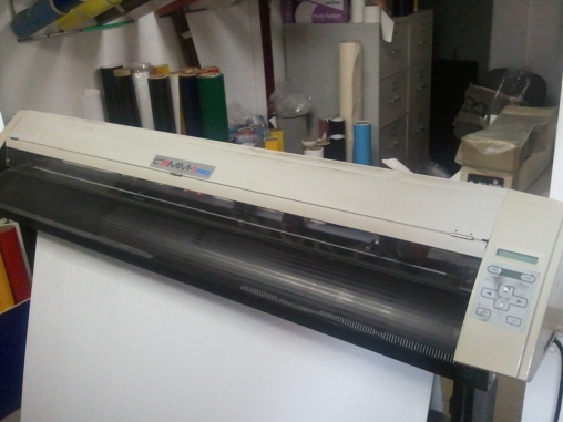

OK- I have only used Summa cutters and know not a thing about Roland-
although I hear a lot of good thoughts about them. I have a VP-540 and
am struggling with winplot cutting on the summas and I saw a used 54"
CAMM-1 the control panel looks different from the current models- any
info? Did they all come with the optical sensing system and will it work with
UV clears (my older summas will not see thru them)? Thanks Gene

AFAIK, only the current GX series come with optical. My previous cutter was a Roland CX-400 - very reliable cutter, but didn't have the width or optical I needed when I got my printer. I have a service manual for CX-300, 400 and 500 series. If you need it, let me know.

gene, 1ST OFF........THAT IS NOT A GX series cutter. looks more like the PNC SERIES. that was the older version. PNC-1860 was a 54". these do not have optical your asking for. the CX series......are DARK GRAY,and have a full digital window. if you look on the plate on the rear of the plotter it should have MODEL-PNC-1860.
Gene@mpls
You are correct OP- sure looks like the control panel on the PNC- I thought
it was too cheap. Thanks Gene
