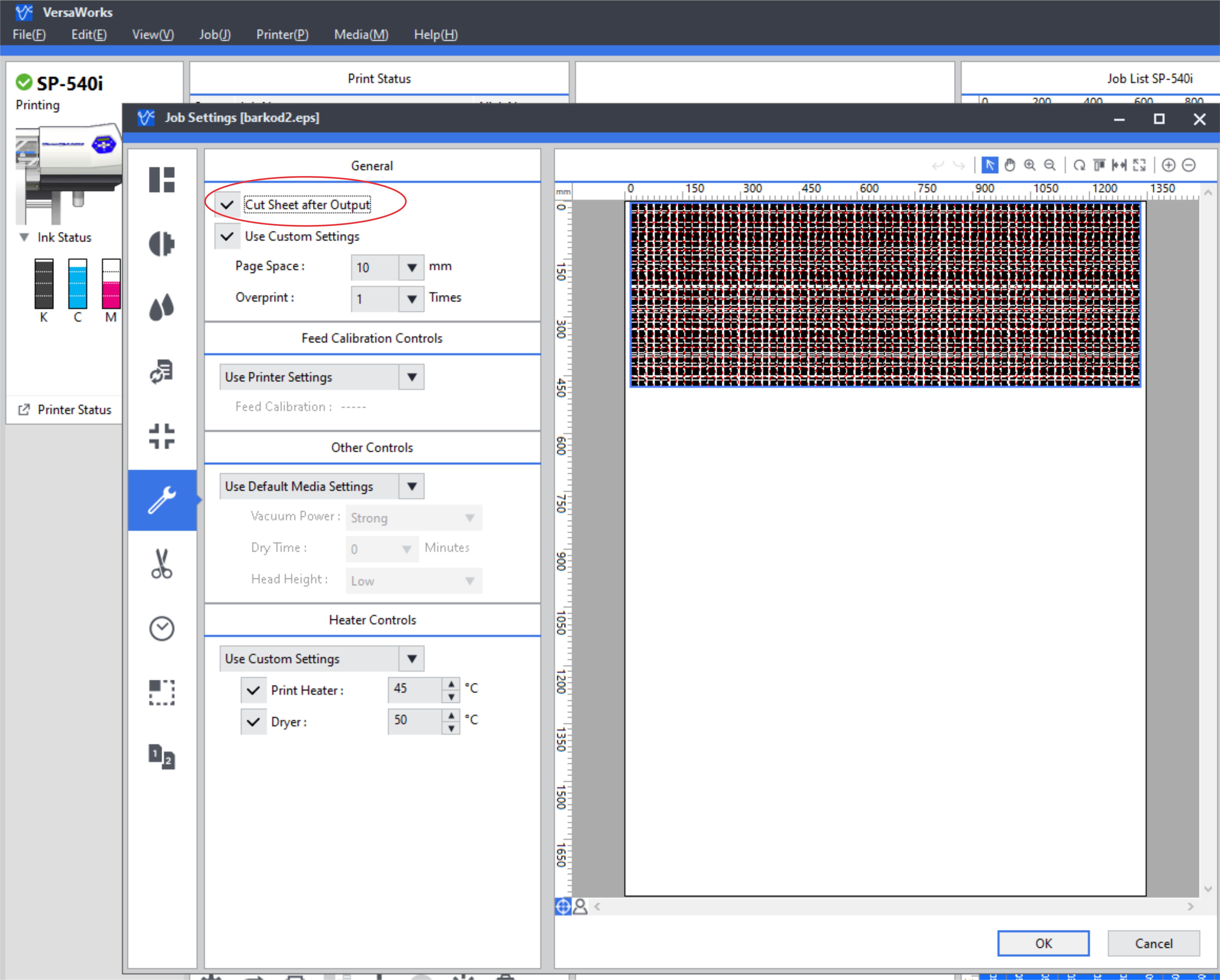

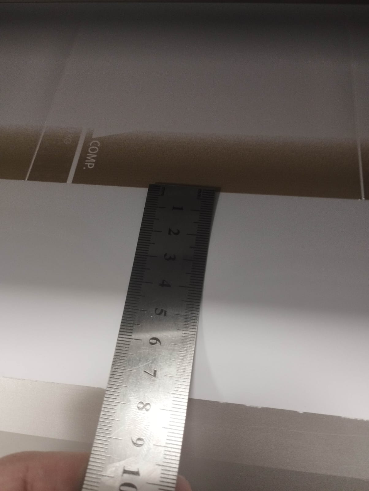

We can use custom settings about page space after printing. Sample i start to printing 2 copy same file. İts automatic make 40 mm space i change it to 10 mm. 1 st copy after printing sheet cut normal but when start 2 th copy printing its add automatical 75 mm before print. How can i change this 75 mm size to 10 mm or other size? Its impossible in roland machnes?

i did before but dont working. Have screenshot u can see. when start to printing after sheet cut auto add 75 mm i dont know why.
