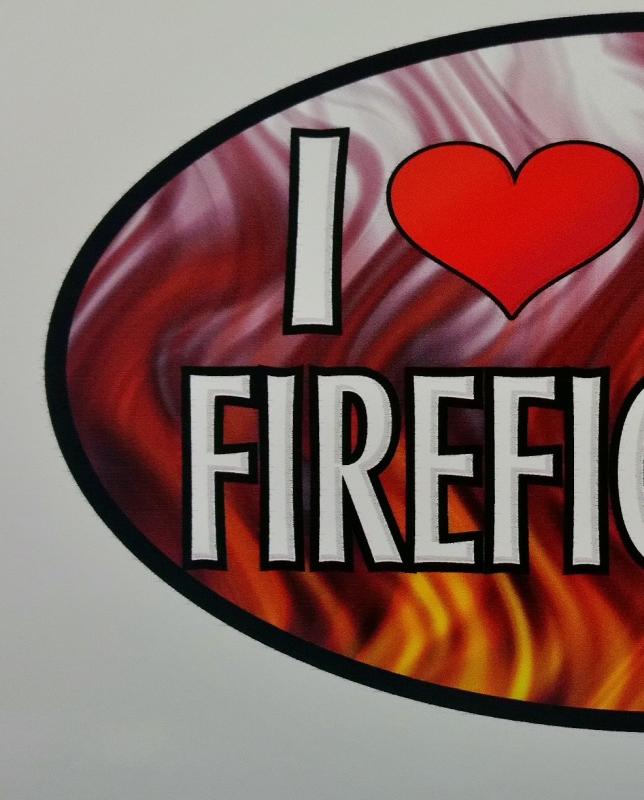

I like to believe I maintained my machine very well over our 5 year history. There has been a few head strike which have lead to the closing of some of my black nossels.
