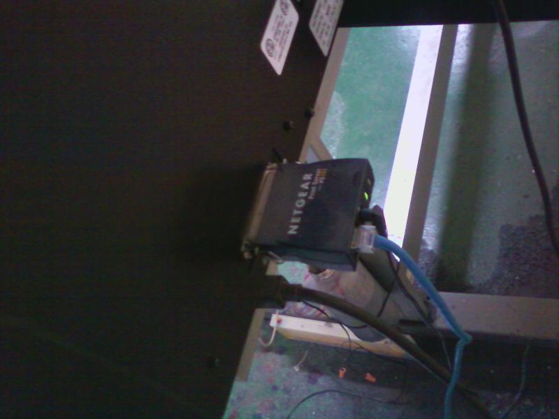

  4. ddarlak
    ddarlak Trump Hater
    this is the solution to your problem....
    the print server plugs into the back of the FJ-52, then you just cat-5 to your router.
    i have three hooked up like this...
