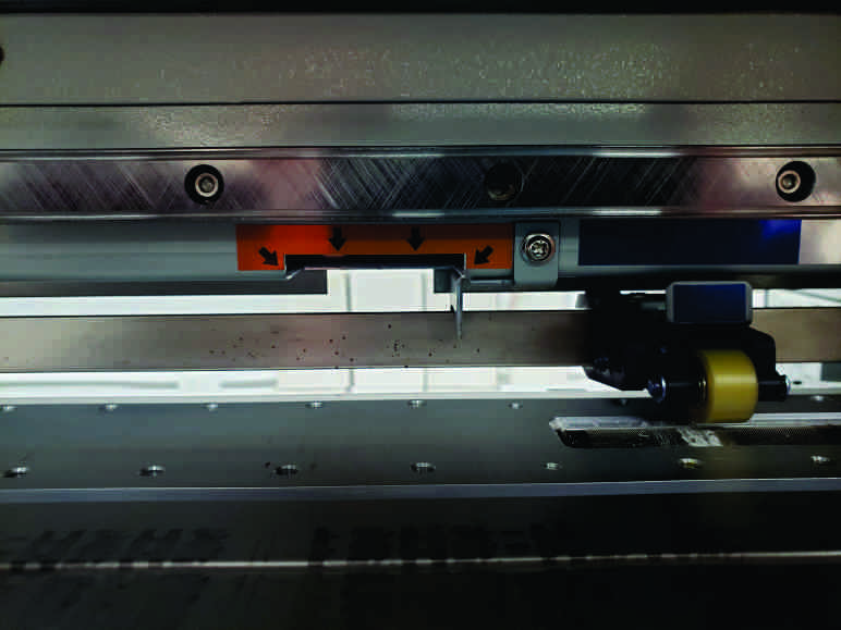

Netsol, not sure about your particular model but my Roland has a clearly marked opening for the place to insert the media clamp.
(see attached pic), it's right behind the front heater platen.
The clamp then slides back and forth on the rail.

I had a Roland VP and a Roland VS and the clamps are different, they connected to a white clip that would slide with the wheels on the far left and far right sides. But I would assume those 2 white pins have something to do with the way they attach!?

I think those clip on to the bed, not the rail. Later models had clip that slid on the rail that you attached the edge guides to. Newest models have gone back to the edge guides that mount on the bed.
