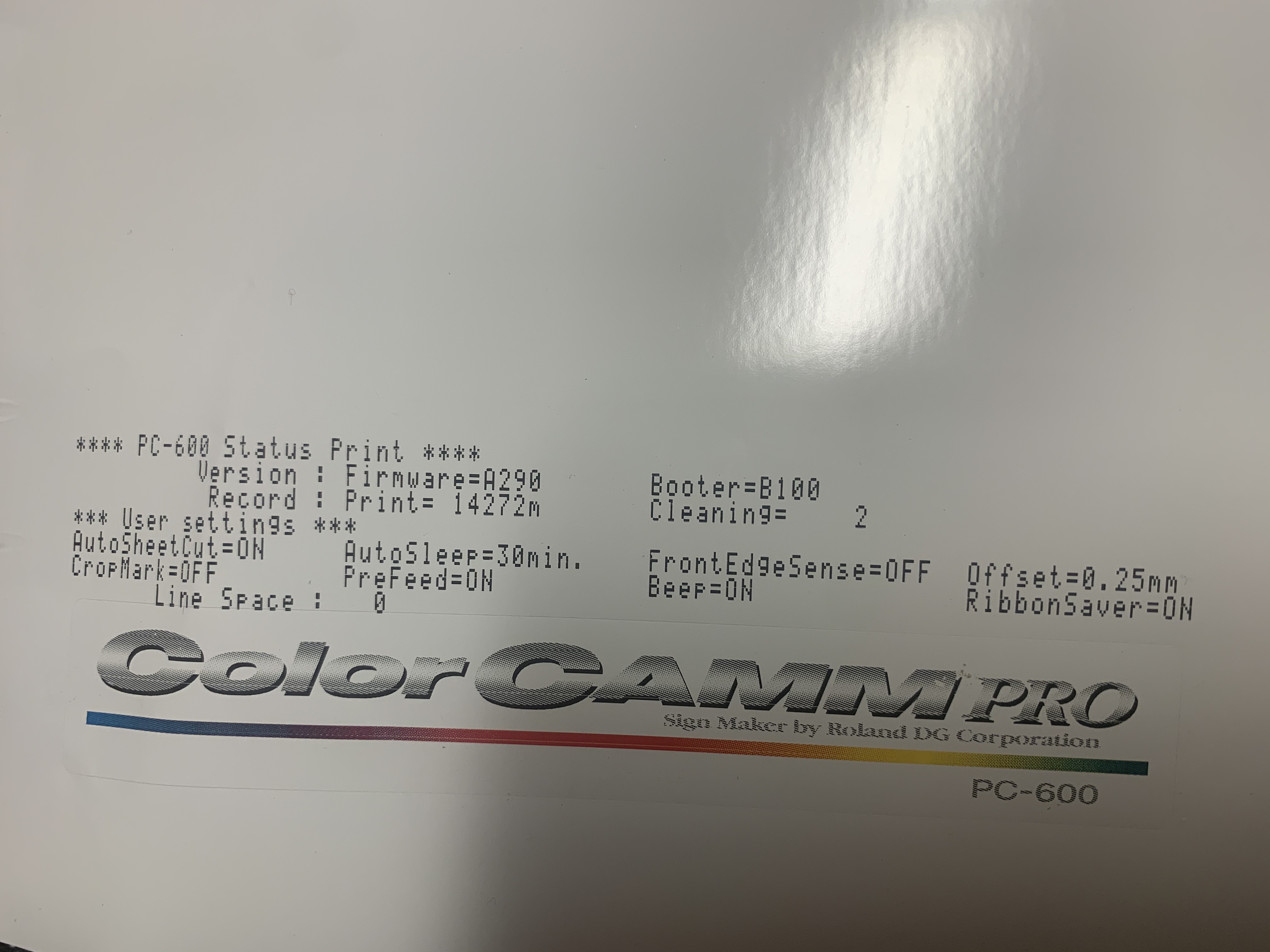

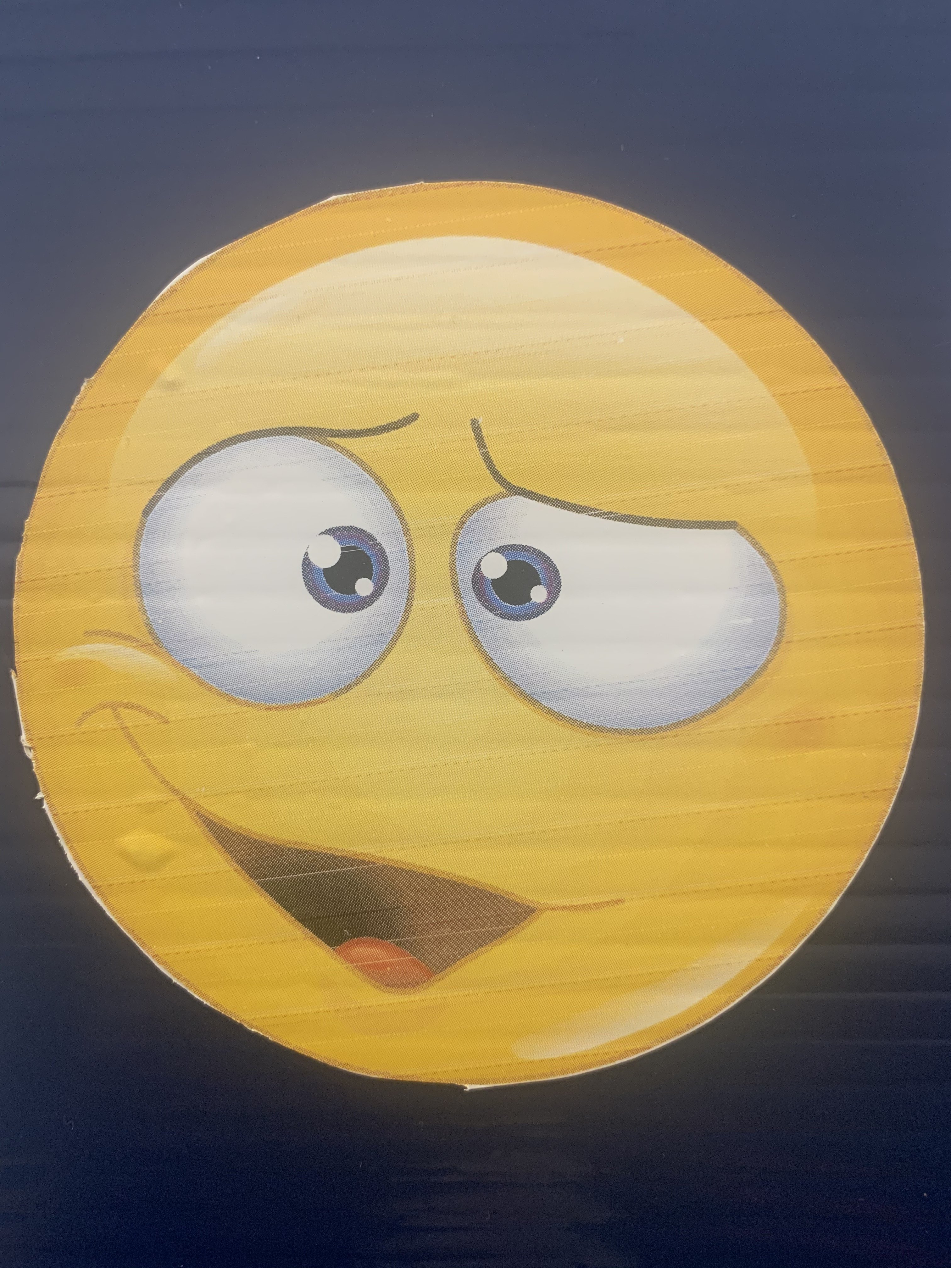

I have had various interesting times with this machine, but, I suppose I need to ask this.
Attached are two photos- one is the print-test from the machine, another is a sticker that I made.
The print test doesn't have nearly as apparent of banding, but the sticker, about 4.5 inches wide, has this banding issue. Is there a difference in the way the image is sent, or is it some alignment issue? Is it the head?
Small stickers appear to work out fine, whereas larger ones do this. I should note that this isn't really visible from 2-3 feet away, but it drives me up the wall and I can't sell anything like this..

For this printer, roland doesn‘t have a cleaning liquid, but a cleaning sheet. But not shure if they available anymore.
netsol
that is the same print head type & technology as zebra direct thermal /thermal transfer
you can clean with 91% isopropyl
i have not unpacked my service manuals yet, (we moved recently) but there is an adjustment that minimizes that effect. turning the adjustment one way causes a thin white stripe. the other way causes a darker (double pass/overlap)
