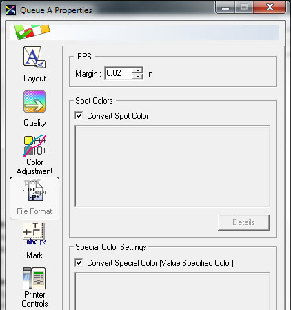

2. Have told Versaworks to recognize the color names in the Roland Color System. This should be set up as a Queue default. See the attached image file for how to do this.
3. Are using the Roland Color in your design application, such as Illustrator, CorelDRAW or FlexiSIGN.
