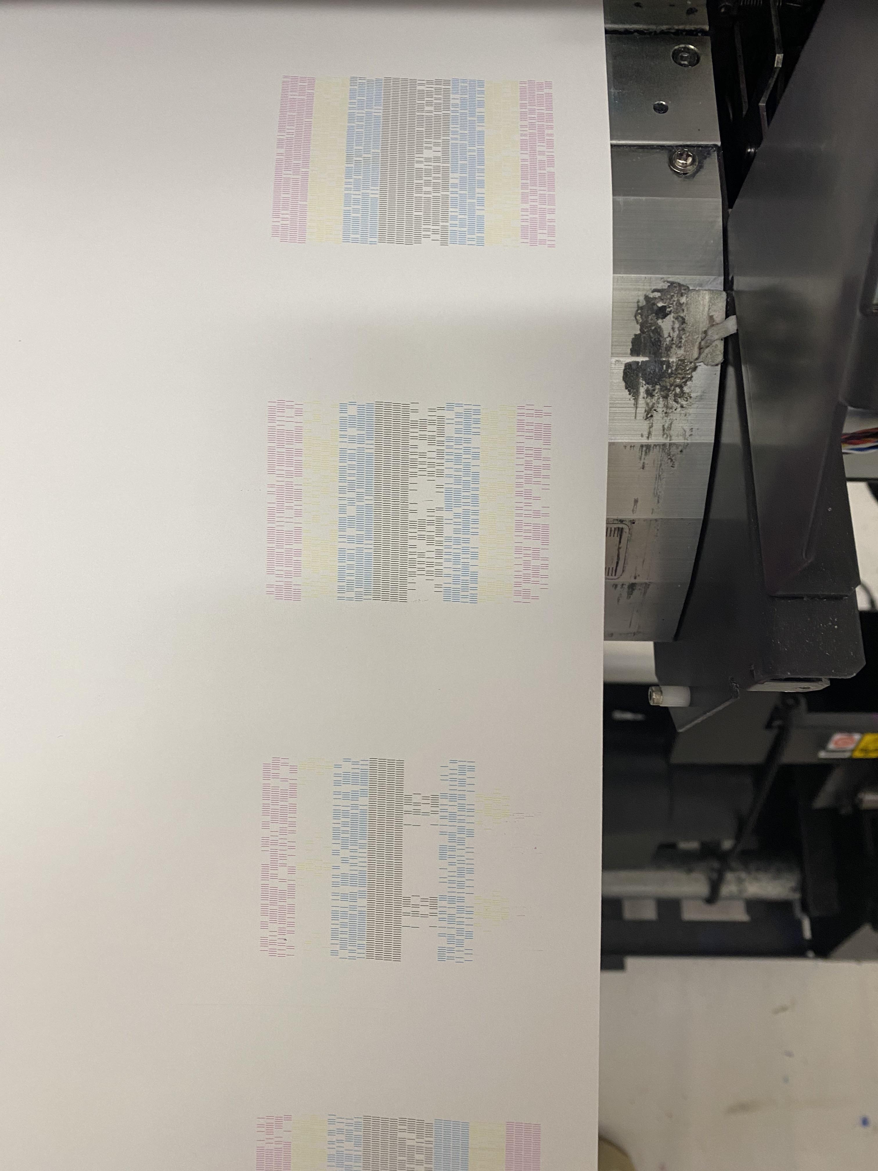

On my last 2 RF640 (2019) Test Print is ok and after few meters sometimes I Lost black, sometimes Yellow.
After a Medium cleaning the Colors are back.
I made some test on one machine. I can Damper, Captop, Assy Pump, Head, Bulk Ink. Same Problem after some days.
Do you have any advice ?
Thank you for your help !

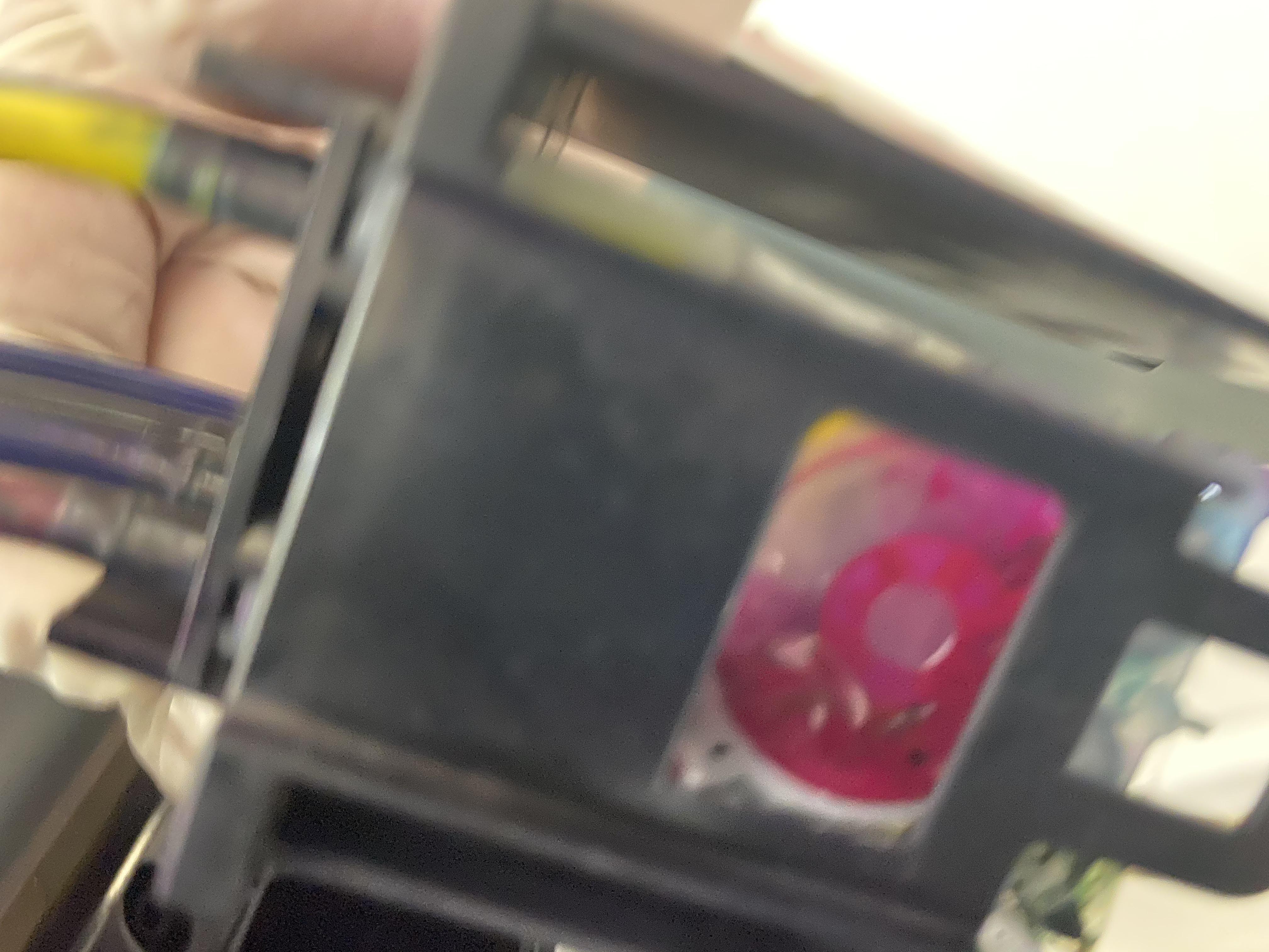

Hello,
I pump with a Little syringe after the damper. As you can see on the first Picture, there is a air bubble in the damper, is that ok ?
I see air bubble in the tube, but after pumping with the syringe it seems ok but after 2 powerfull cleaning my nozzle check is not correct.
Any ideas ?

Shouldn't have much or any air in the damper to my knowledge. Definitely no air in the ink lines.
BunnyOne
Yep i'm agree but I tried to pump this *** air bubble, never fix it. Do you think I have to change this damper ?

There is almost always air in the top of the ink cavity in the dampers and it is OK. The important thing is the output from that cavity is completely covered with ink. I would check the cap, making sure it is clean and correctly aligned to the head. Is the new cap OEM or aftermarket? Captops are one of the parts that you should always use OEM, as aftermarket quality is all over the place and can drive you crazy.
