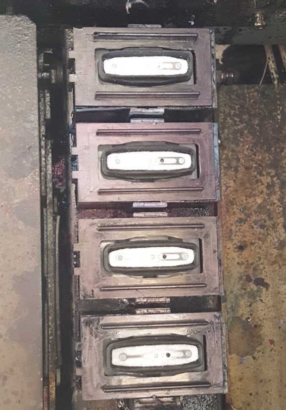

Hi,
I finally replaced the cap tops with brand new ones and also the dampers and performed x3 powerful cleaning and did a print test and no ink was printed on the paper, "BLANK WHITE". I opened the capping area of the machine and found that the new replaced caps does not even have a single drop of ink on each of them C,M,K,Y. Please see attached pics..
Please any further advice would be greatly appreciated?
