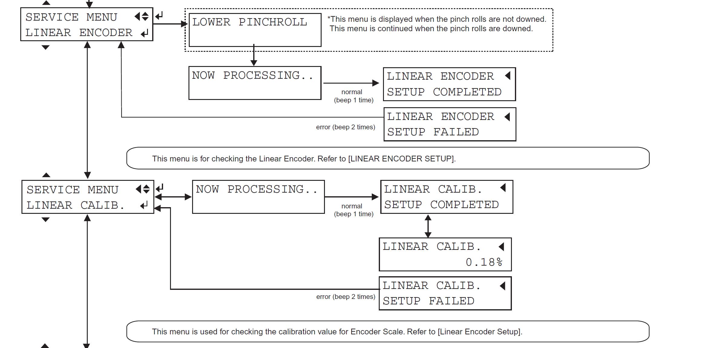

2. Run the linear encoder and calibration in service mode.

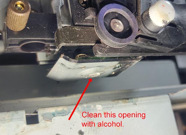

3. Clean the cropmark sensor with alcohol and a foam swab. see pic
