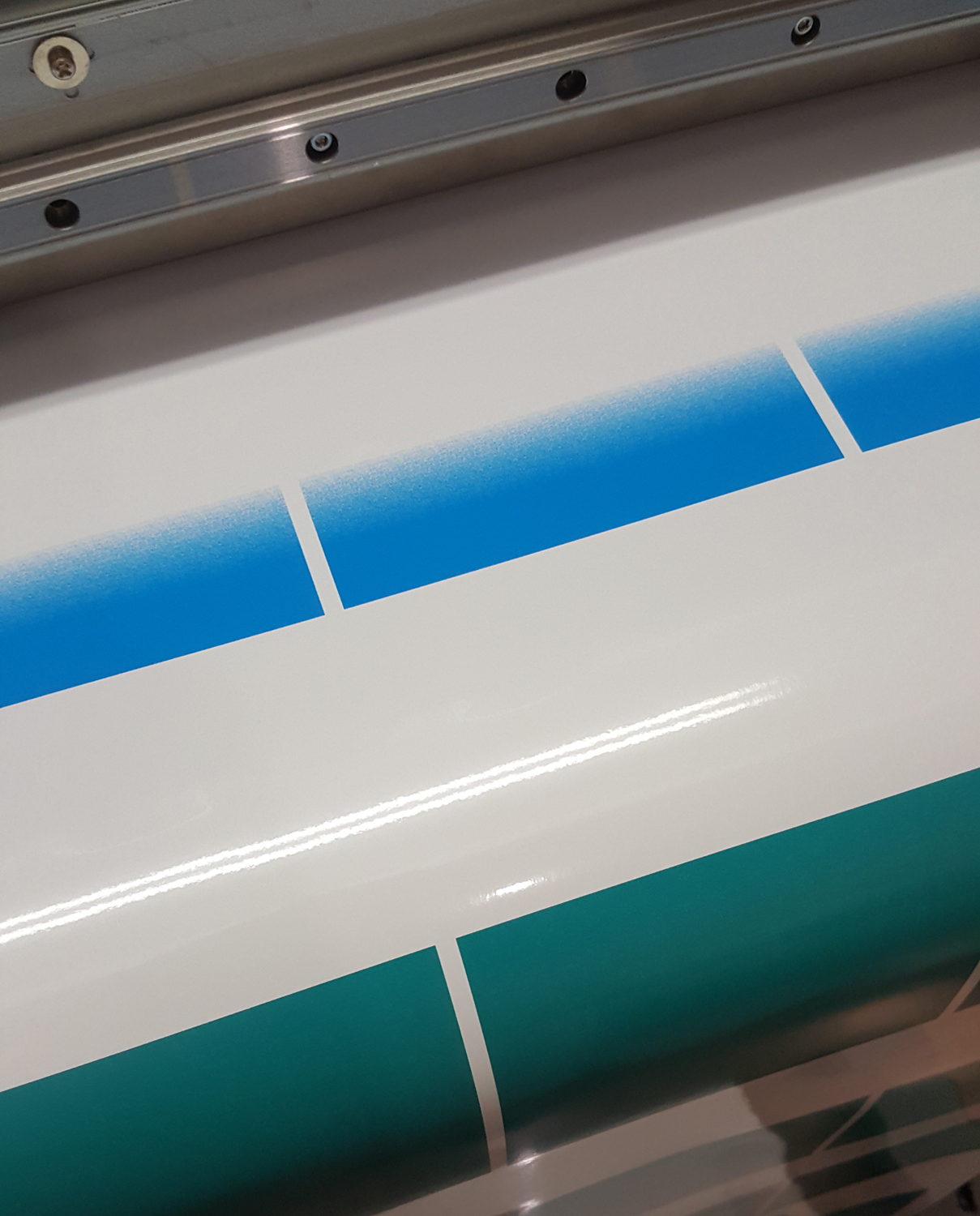

After new parts and tubing and syringe and multiple cleaning, I tried printing out a series of three 5" squares of pure Cyan to help clean out any backed up cross contamination. Results got a bit better after several attempts at this but the cyan is still much darker indicating cross contamination is still happening.

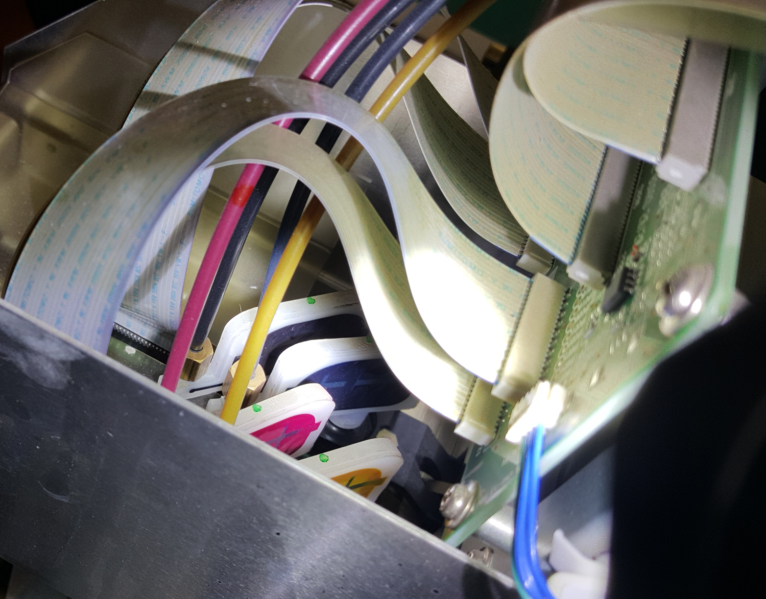

And there's the magic number I think I needed!! Thanks Solventinkjet. I just watched a video on this as well and the dude drew a ton of ink through, and your 20ml number really helps! I only have these dinky 3ml syringes so I'm probably not nearly passing enough ink through. I'm going out now to try to find some bigger syringes. I took a relatively poor picture of my dampers, but it does look like the cyan damper is a little darker than it should be. Another pic I took even showed a bit of cross contamination in my yellow/magenta... so I'll syringe both sides.

Magenta and yellow are looking nice and bright. The cyan is definitely dark. If you haven't already i would put a new cap on the magenta yellow just to start fresh seeing how the tubes were clogged they are probably due for a change anyway.

I changed both caps yesterday to be safe. I just got back and could only find a 10ml syringe, so I used it three times to pull a total of 30ml through the black/cyan cap. If anything, the damper got more black after this process. If the cyan is supposed to be as bright as the magenta in my picture then I'm still way off. I did a cleaning and test print, then my 5" cyan squares to confirm that it got worse.

Success!!! Thanks so much again Solventinkjet and John! I swapped in a new cyan cartridge, drew 20ml with syringe through cap (damper didn't go as cyan as I thought it would, but way lighter than before), ran a clean cycle, test print, then printed my squares. You can see in the picture how drastic the change is. Printing a job now and it's working perfect.
