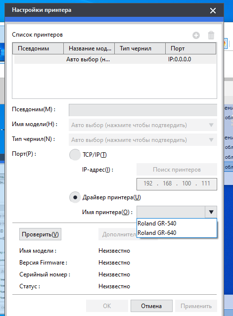

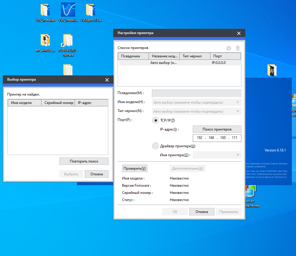

i used sp540v on win7 last 7 years, but cant use old laptop anymore. my new PC have no legacy boot mode (only uefi) and it is most reason for using Win10. i trying siple copy old versa (5.5.1) from laptop but isn't work same. on official roland site in this moment only versa6 is available.
i use intercon tool on win10 PC and setings looks like the server is work good:
(my old laptop is working bad, but working too yet. now i work from it, but it may finish at any moment)
but versa 6 cant find it in my ethernet. it's looks like versa 6 have no driver for old machines like sp-540V. i instaled all available driver updates from roland site, but have no any results.
so, my questions is:
1) where i can find driver pack or update for old model, as SP540v (i find sp540i drevers but is'nt work)?

Versaworks 6 doesn't support the your printer. You'll have to use the original VersaWorks on a computer that supports it or see if you can get versaworks to run in a compatibility mode or something.
chris72a
I'm running same printer win11 versa 5.2.2 I think I installed 5.1 and then did update, you have to run in win7 compatibility mode otherwise it will crash all the time.
Ra351000
Thank you so much everyone. Problem solved by installing Versa 5.5
This did not require any compatibility modes with old Windows. I only ran the installation with administrator rights.
