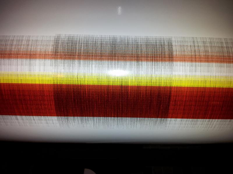

    hi,
    i'm from Martinique and i have a Roland sp300 patched to sp300v.
    After a manual head cleaning a problem with the black/cyan head, when i print only with the mag/yellow head, there are blue vertical line on the red/yellow color.
    When i unplug the black/cyan head, the printed of red/yellow color is very good.
    thank you very much for your help..

    Have you ever cleaned the encoder strip?
  4. enzo972
    enzo972 enzojmfstickertuning
    14
    1
    Mar 18, 2012
    Martinique
    yes but it was not the problem.. to fix my problem, i change fuse and condensator from the black head on the motherboard.
