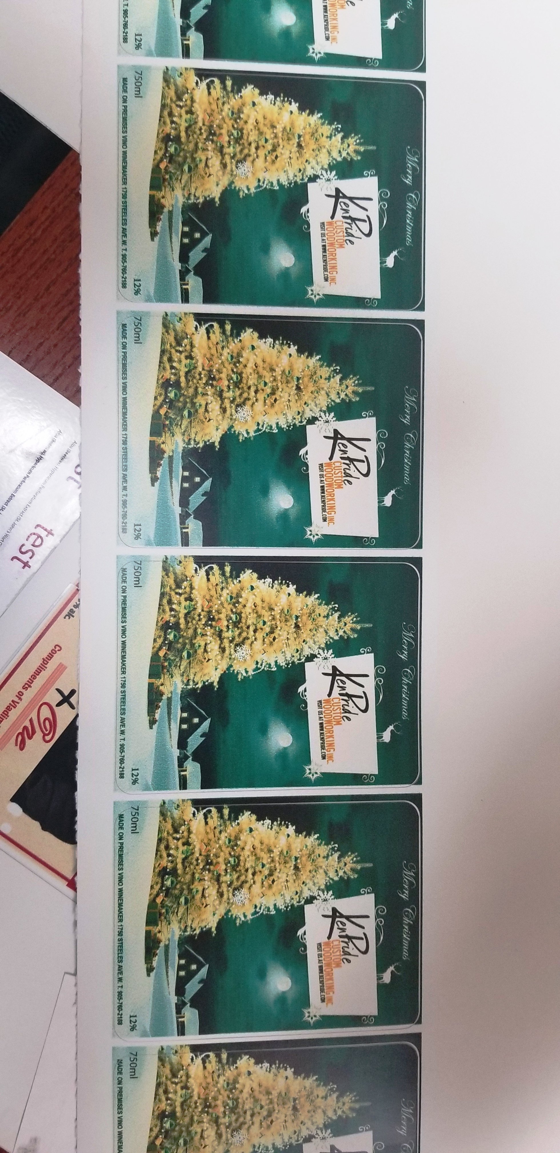

Hello All,
I am fairly new to this equipment, i started printing out labels but noticed my cuts are way off the contours. Every label the cutting drifts further away and destroys my prints. Can someone walk me through how to fix this and being a newbie don't even know much about this equipment and willing to learn. Too expensive having the guy come in and fix it so wanted to give this a try see.
I tried to play around with the scan and feed but see no difference in cuts.
Thank you:)

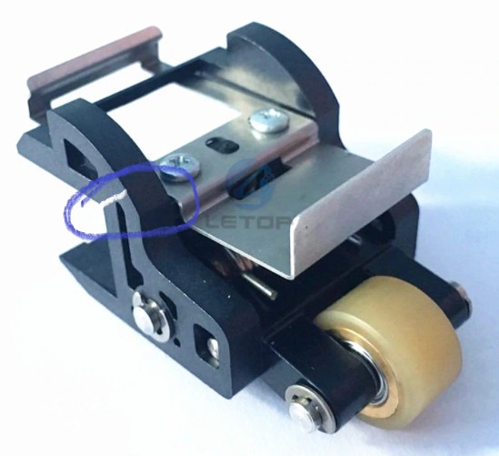

Just to check. Did you install them with the dots on the outside? Right pinch roller, dot to the right, left pinch roller, dot the the left?
If so, then there are some other possibilities.
1 The pinch roller handle spring isn't tight enough.
2 The pinch roller assembly has a crack in it. (Picture attached as reference)
I hope this helps.

It just dawned on me that we might be talking about different things. what do you mean by "off track"? Does the material move or are the cut lines just off?
Marley
i meant that, if i have multiple images to cut the first one will cut according to the path set and the second too but the next ones i notice the cuts going off ending up cutting part of the image.
Sean@CedarHouse
Printing Money
Okay, So... it's possible those physical issues are still happening. However, you might get around those by using "Custom Cut" in VersaWorks.
