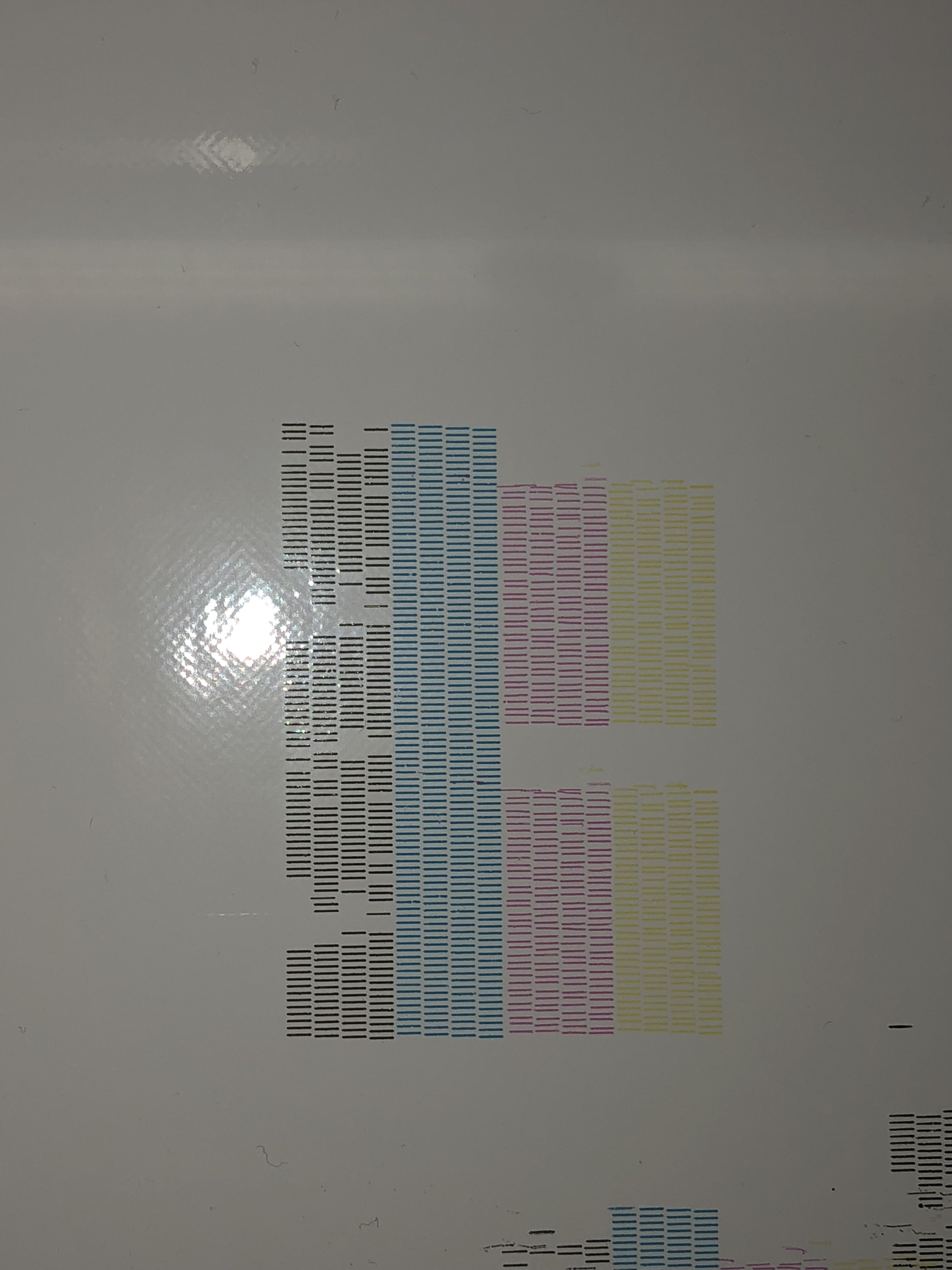

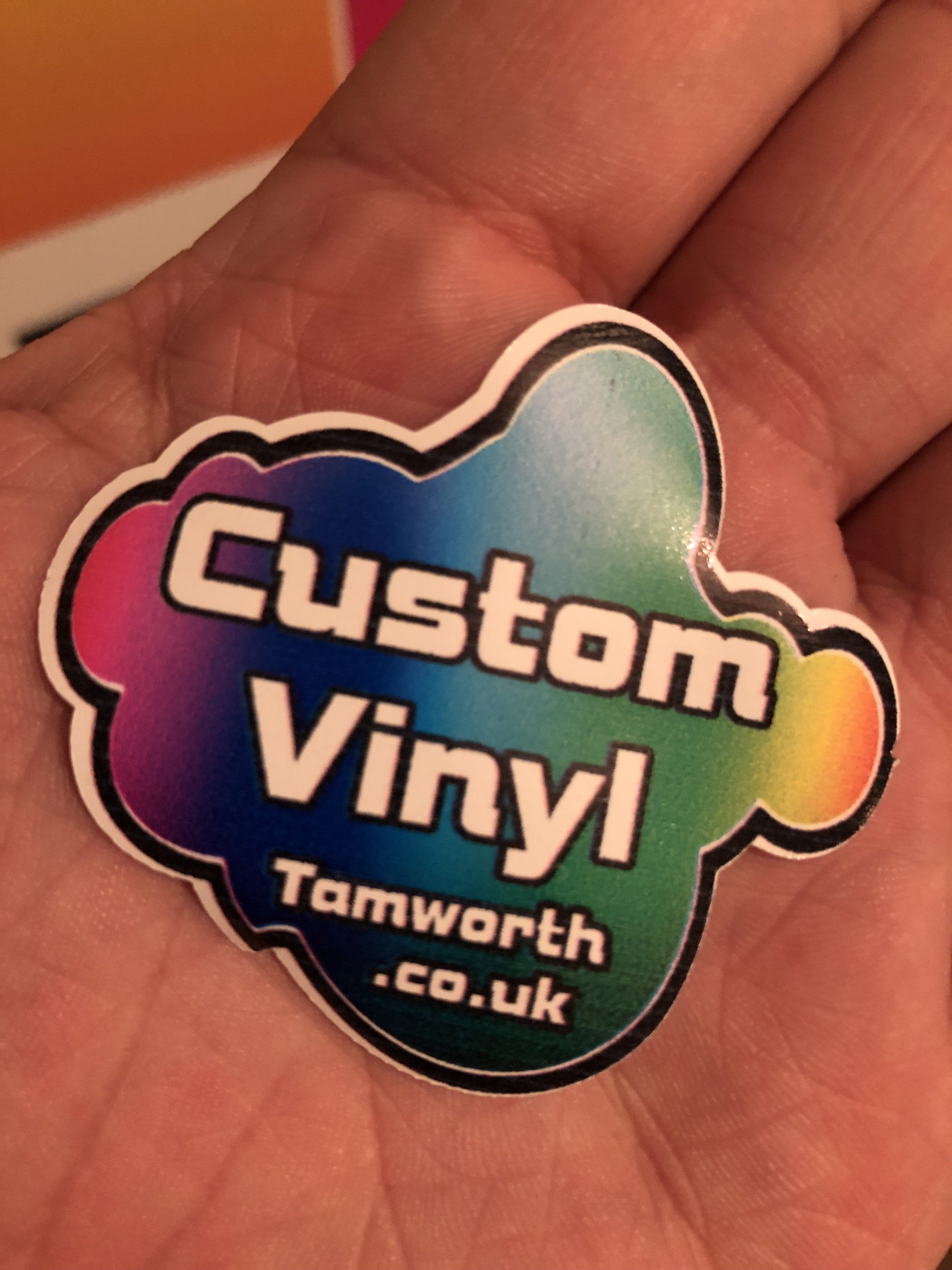

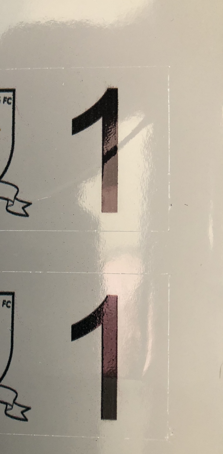

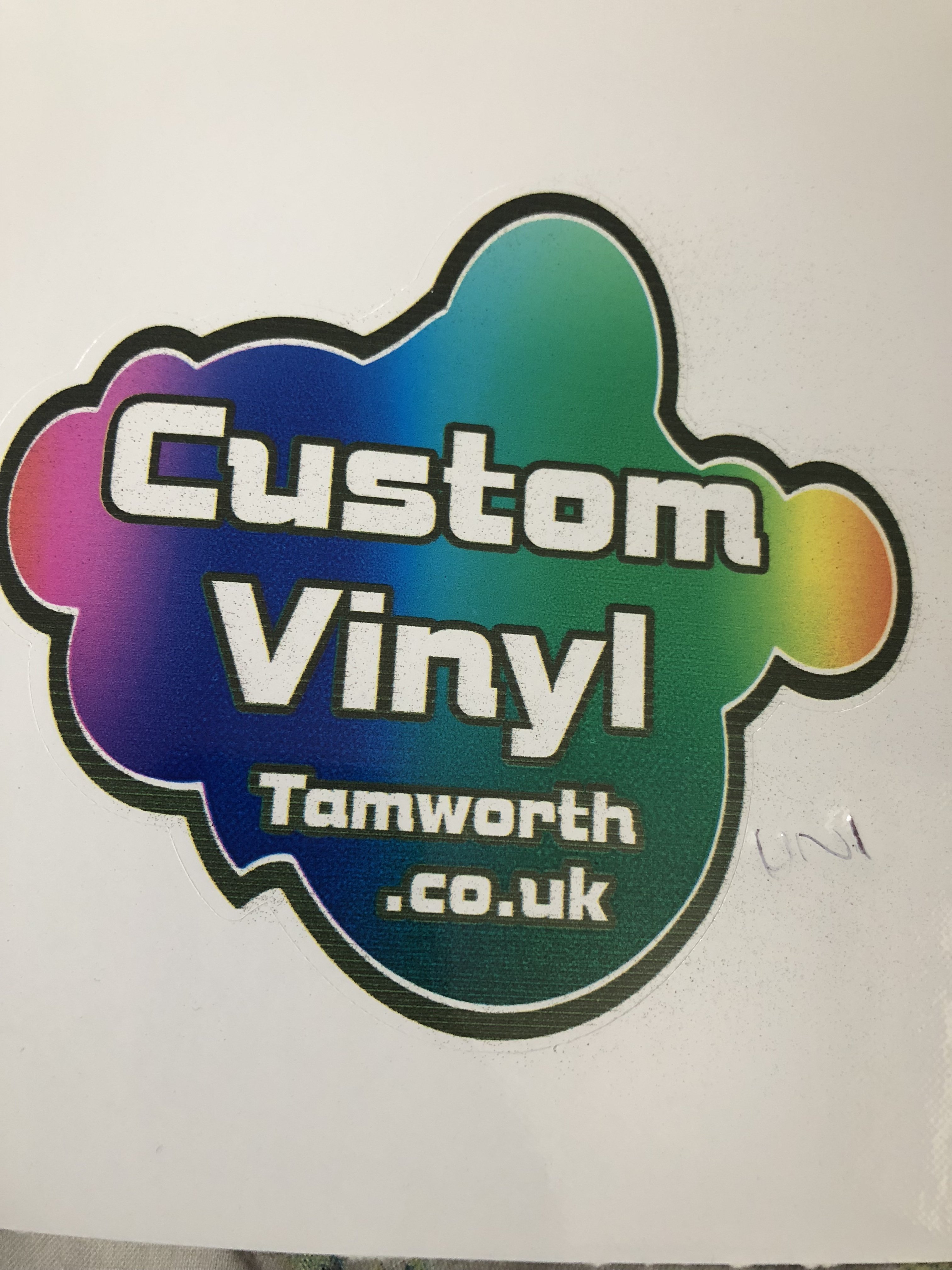

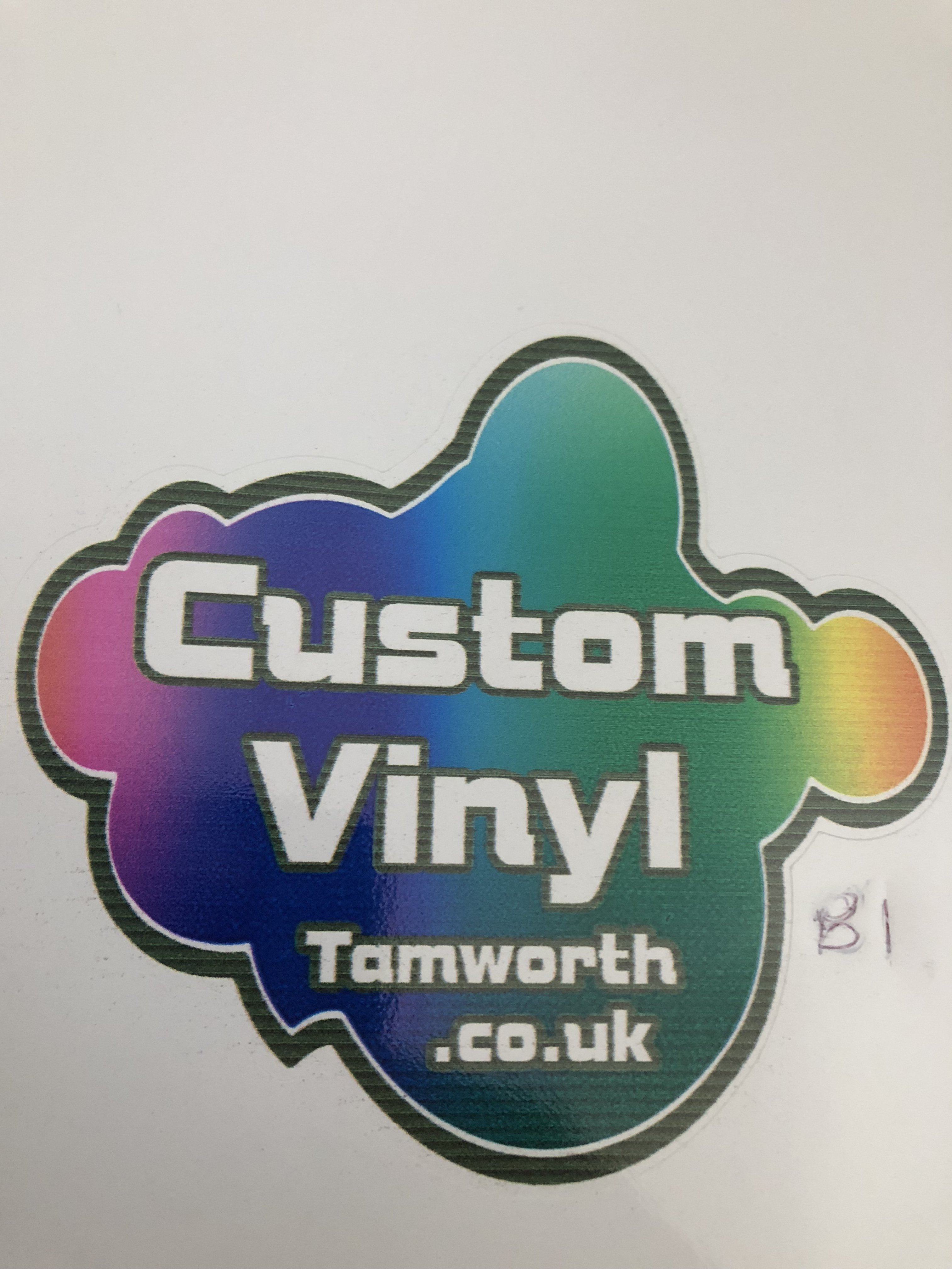

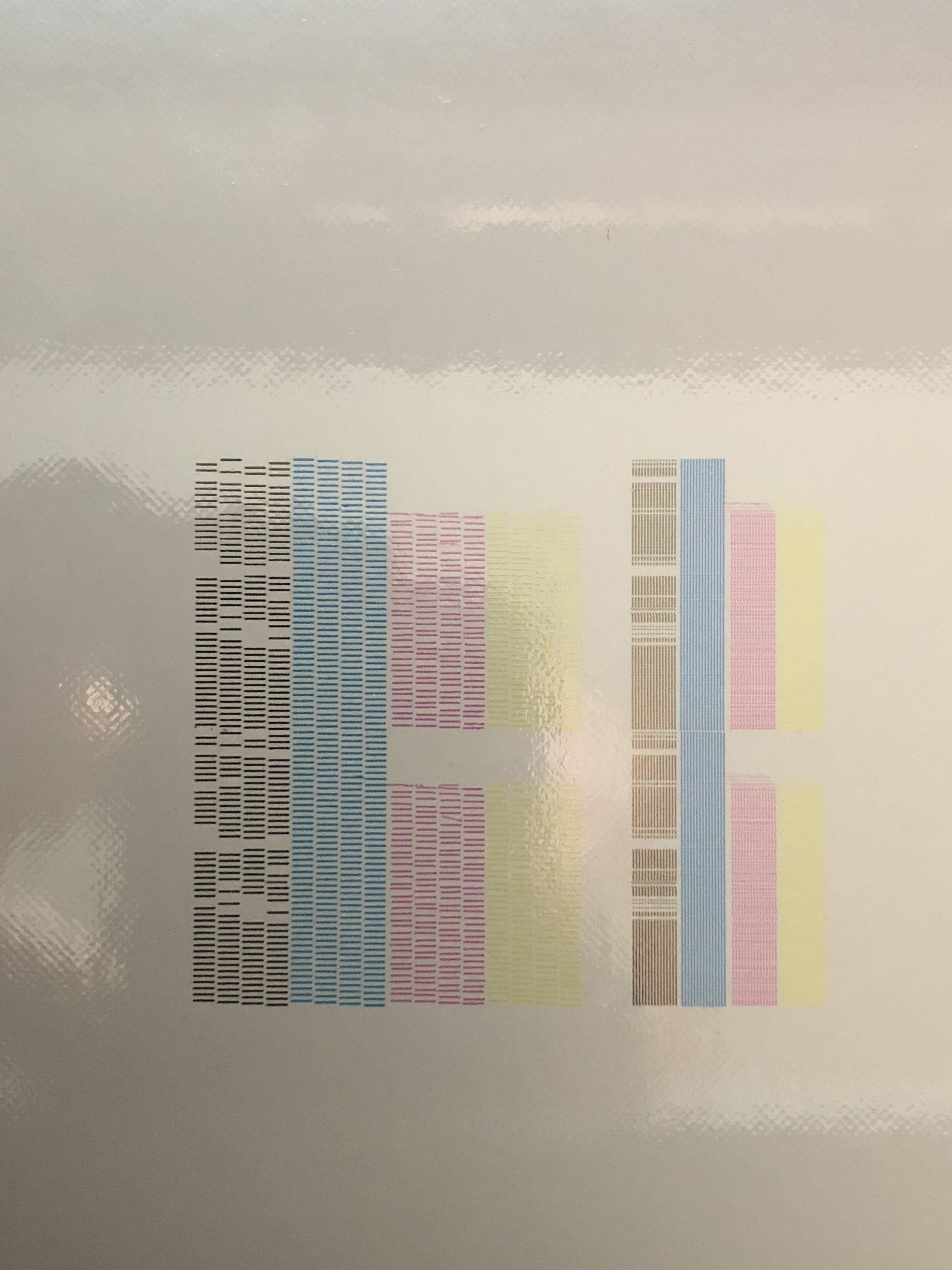

Hopefully these images show the latest head print as well as an image of a bi directional print and a uni directional print. Also a print I did the other day before the 2 logos which show the black with the fuzzy printing. The logos show some of the banding issues and droplets that can be seen within the white text. I’ve made some progress with this over the last few days but I’m beginning to run out of ideas and hoping it isn’t the head, obviously! On another note does anyone know of a Roland engineer that covers Tamworth?

your prints are never going to come out that great until you can get that test print looking good. head soaks is where i would start just like you did.. its been a while since i heard anyone speak of it but there used to be a ultrasonic cleaner for the print heads. there's plenty of videos on Youtube about that, I have never tried it myself but it might be worth looking into

That nozzle check it pretty messed up. I would say the cap tops are probably not working properly or are clogged. Also check the bottom of the heads to see if there is any physical damage.

Thanks. There is no obvious damage to the head surface. Is there a way to check the cap tops or is it just a replace them type of job? When I put the cleaning fluid on them it drains away after taking the clip off the drain pipe when I do the head soak.

Usually you want to replace the cap tops once per year but most people go until they fail. You can test them by capping the heads and disconnecting the pump from the cap top and pulling with a syringe from the tube. If you pull air then it is bad or something is breaking the seal. You should get a good stream of ink into the syringe as soon as you pull.

Ok so it’s definitely a head job.

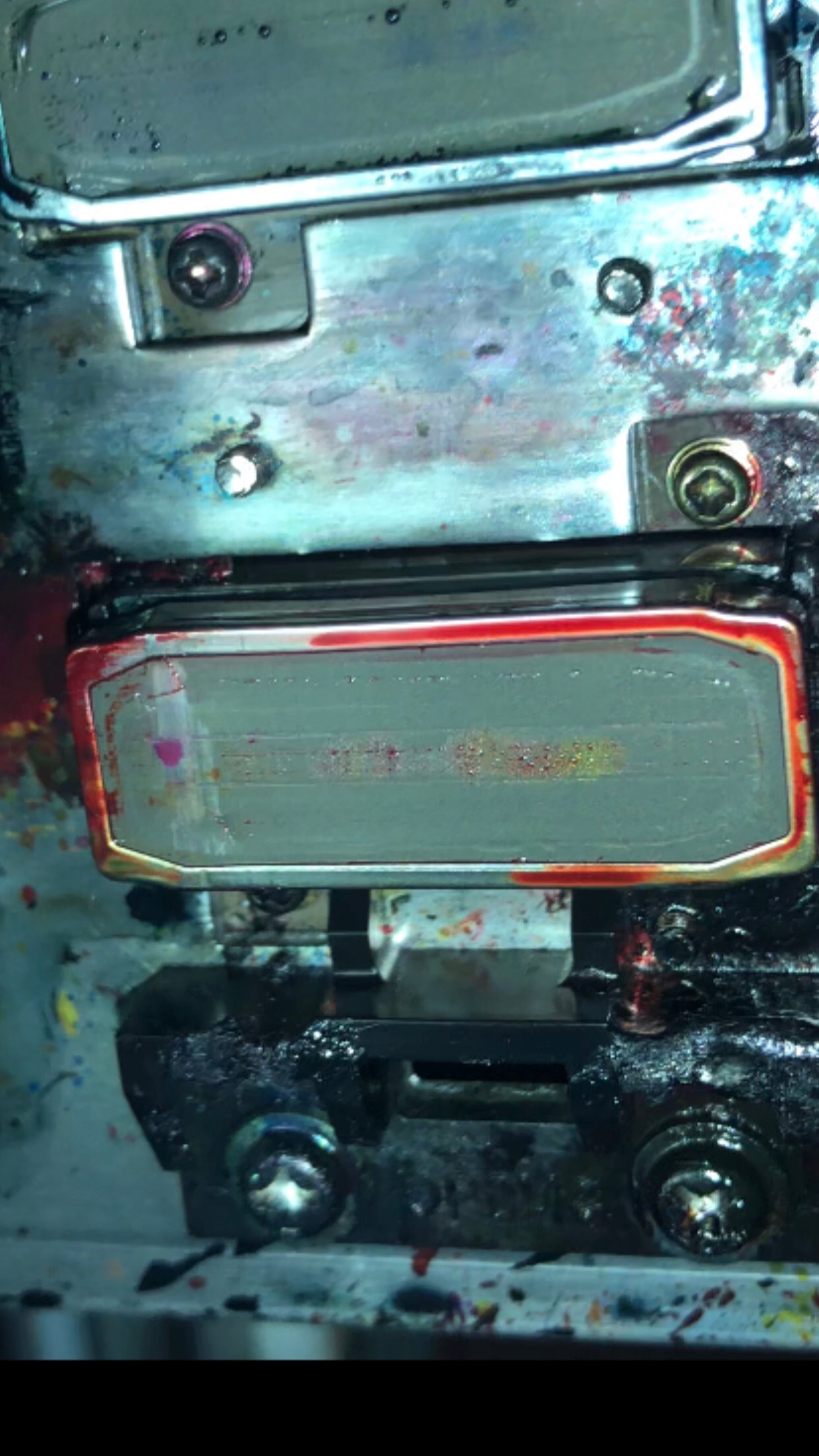

I’ve just done another test print which I’ve attached, I’ve also managed to get the flashlight from my phone under there and I can clearly see head damage on the magenta yellow head in the area of the issues I’m having with the missing nozzles. Damn it! Need to figure out why the blacks missing nozzles now too...or maybe its 2 new heads....hoping not! I don’t think my light was strong enough to see this damage the last time I looked!

I ended up throwing 2 new heads in there.
The black head fell apart in my hands when it was removed!
