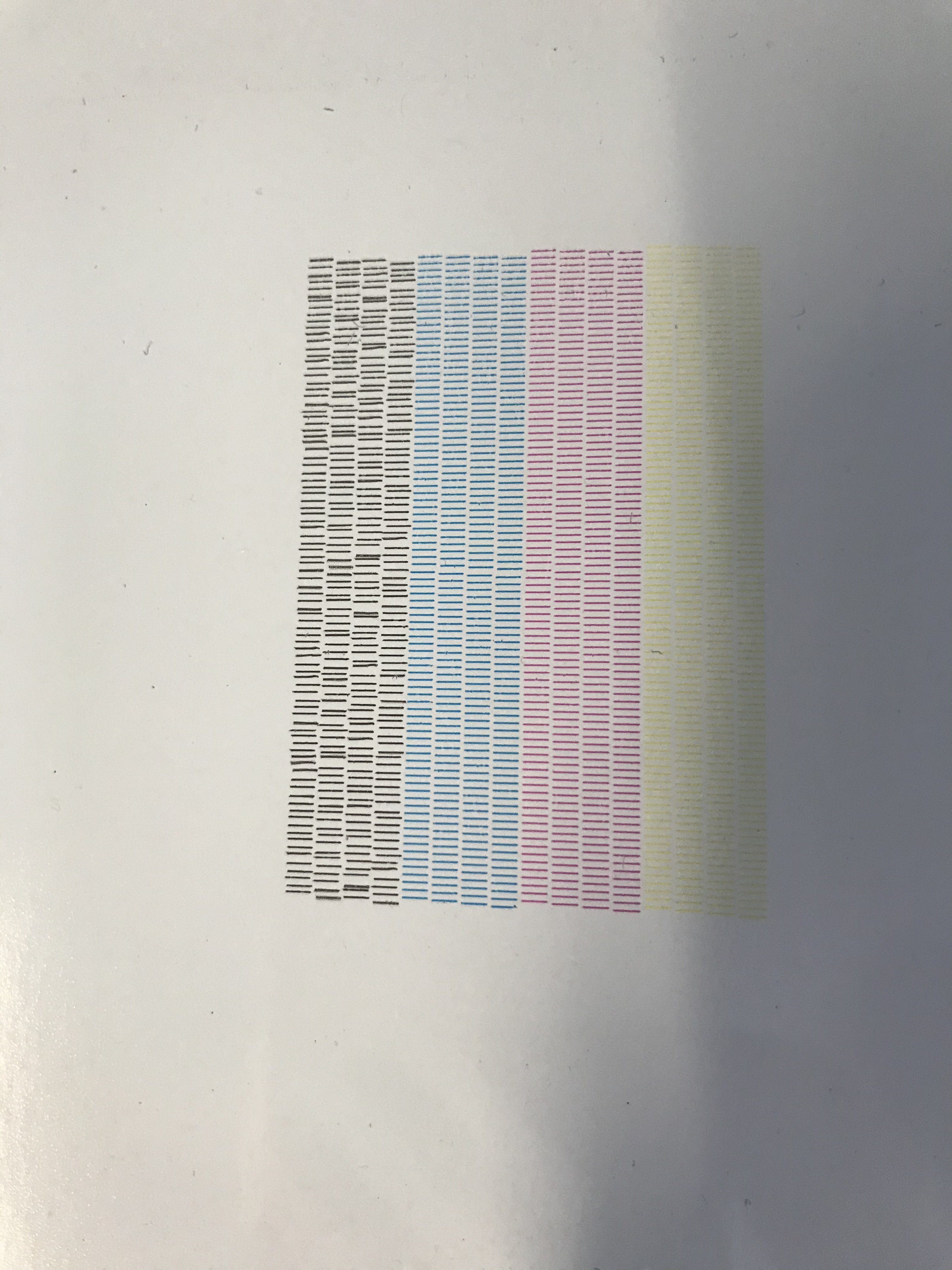

I have a Roland sp300i. By looking at the test print I’m sure I need a new black print head. I replaced it not long ago which is frustrating. Been through 4 or more! This has been going on for a while now.

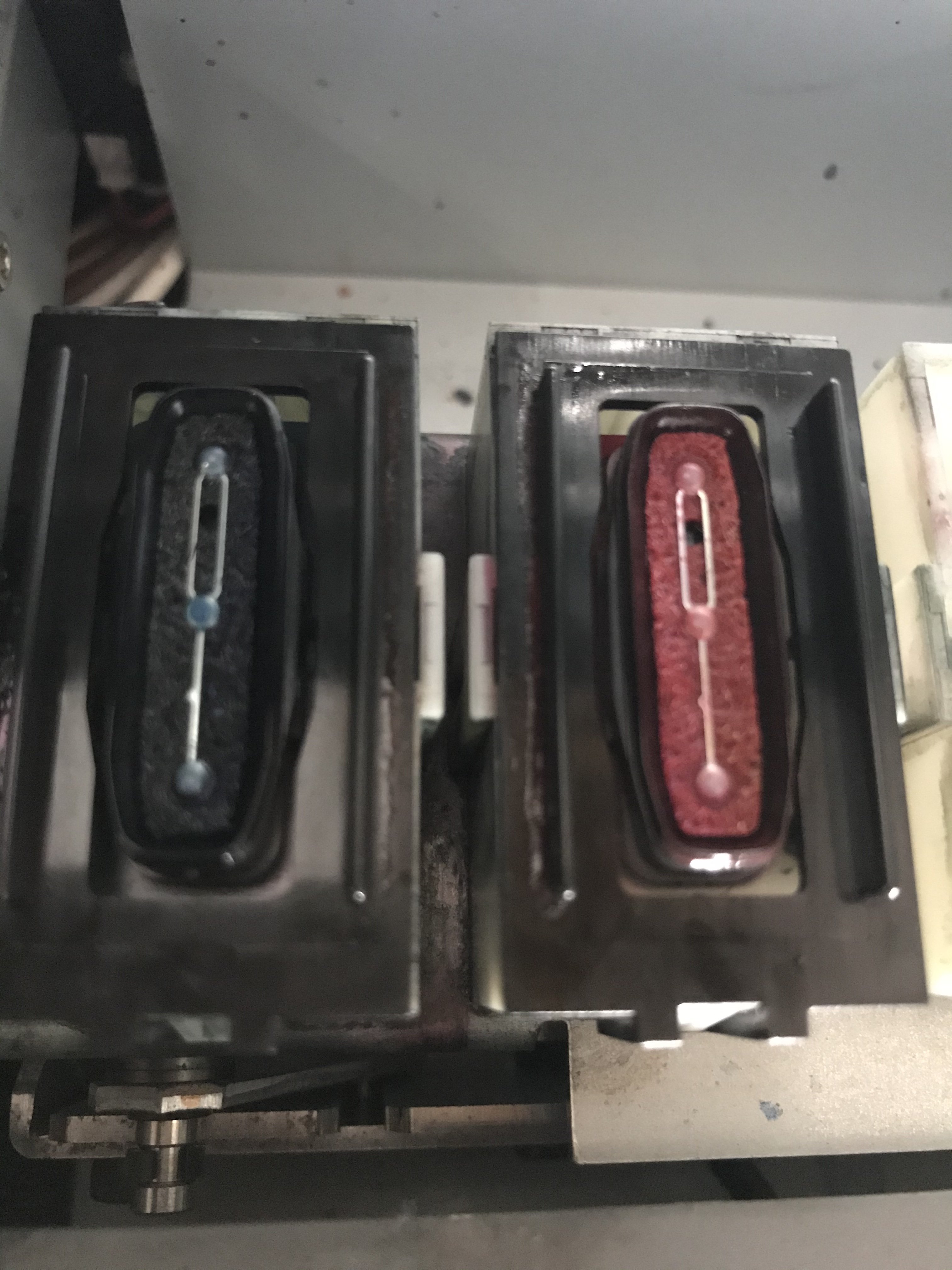

But I notice the lines on the entire print colours are fuzzy and complete mess. I wondered if the cap tops need changing as the cleaner didn’t soak in immediately but I checked 15 min later and it has. What type of cleaning should I do? I did a manual clean. Re: black print head I try not to print 100% black. It probably went a few months after I got it changed. Frustrated with it!

I have the same problem with my SP300V. I've changed the black head about every 12-18 months for the last 3-4 years and it looks just like your test print. I take great care of my printer and so I'm puzzled why the head just gets that way. No head strikes either but it doesn't get used every day so I wonder if that has something to do with it. I know this doesn't help but your not alone. John

I have noticed when manually cleaning around the black print head that there seems to be a lot of ink to wipe away and I can never completely clear it away. The other printhead wipes clean.
I noticed this with the last 2 printheads I’ve replaced.

Black ink (likely) has the greatest amount of pigment in it and thus the black print head gets 'tortured' more than the other heads. It doesn't appear that any of your nozzles are plugged (missing in the test print) but many are getting deflected spray and that's why your prints are fuzzy instead of crisp. It's the same as what happens at your bathroom shower head when you have a lot of minerals in your water. If I were changing heads as frequently as you are and getting these deflected nozzles, I think I'd try wiping the head with a soaked sponge stick (that you use for manual cleanings) and see if it knocks off any of the sediment and cleans up the head and it's spray pattern. This is essentially what the wipers do except without the cleaning fluid. I believe the heads are far more durable than we're led to believe. What do you have to lose at this point, a damaged head that you need to change? Also, try changing the wipers more frequently. They're so much cheaper and less aggravating than changing print heads.

Couple other things - first, I would definitely change out the cap top - as well as the tube running from the cap to the pump. That might help. Also, change your wipers if they haven't been done in a while and if you are using after market ones there, I recommend trying Roland brand. Can't say for sure that there is a big difference but in this case the difference in cost is worth the expense if it helps. Finally, I would make sure your Firmware is up to date. A long time ago (and this may apply to the SP-300V guy below) we experience premature deflections in black ink specifically. Similar to what you are seeing. This was caused by the makeup of the black pigment, which is more problematic than the other colors. We found that a periodic wipe of the heads resolved that issue completely, and I have not seen it in 10 years or so. The firmware upgrade, if your firmware is really old, would institute the periodic "sleep cleaning' and might help. But on that note - if you are not using your machine regularly, please remember to keep the main power switched on and only power down the printer using the sub power on the front panel. This is probably obvious, but I figured I would throw it in just in case. Hope something here helps.

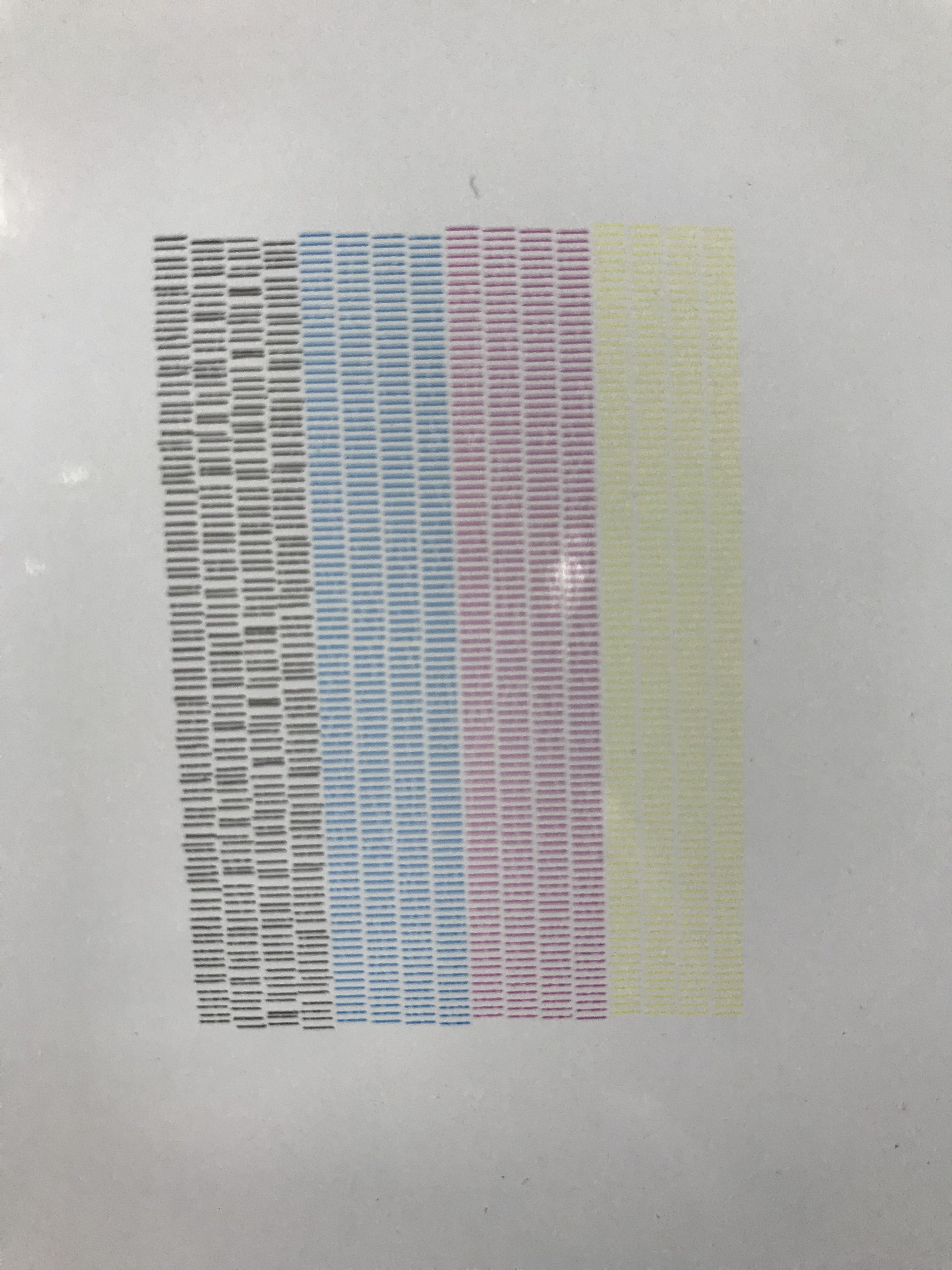

I did another quick manual clean and I wiped the black print head. The test print is not as fuzzy which is good. But as you see in the pic the black seems to be the same. I didn’t realize the wipers are what cleans the heads, I should replace them more than I do!

the only way you can do a cleaning is with the carts in. those MUST be in in order to do a clean unless you want to compound the problem by possibly sucking air into the lines.
