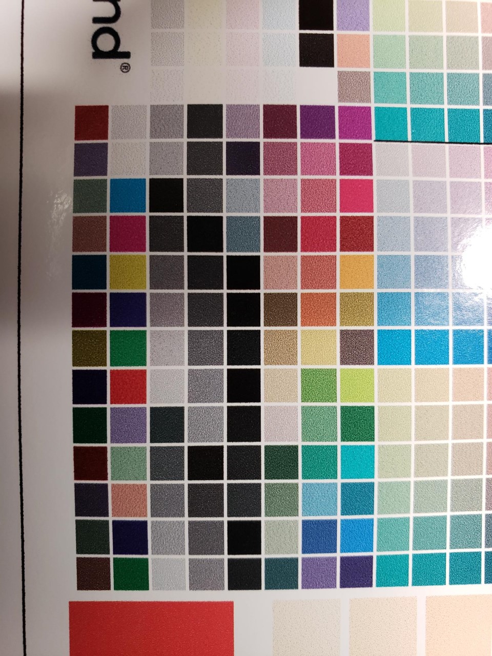

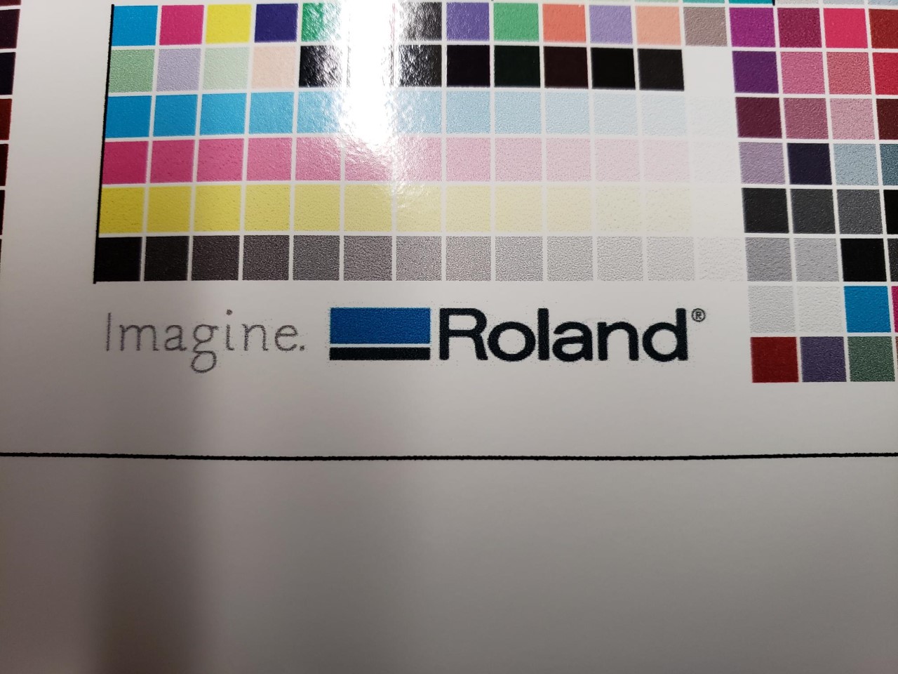

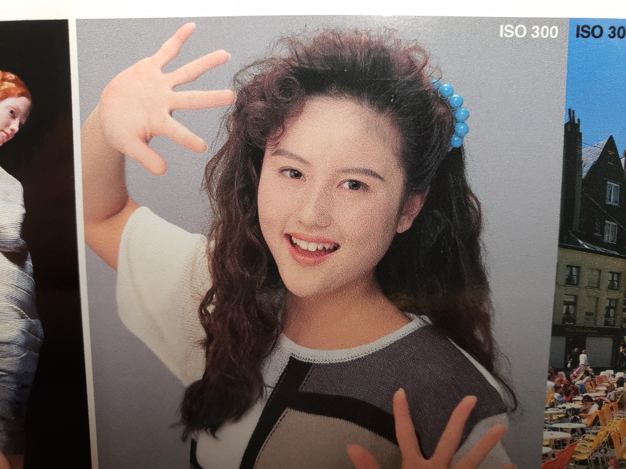

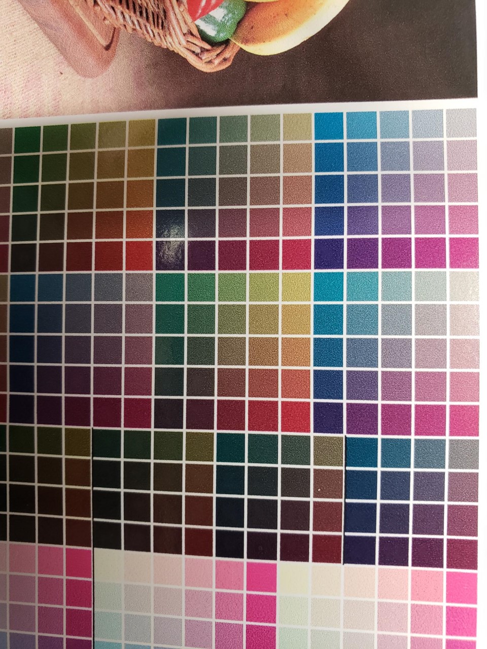

Update, turns out the service level calibrations were never done for my machine, they're done now. Same problem now with banding and little bit of black over spray. I had my ticket escalated Friday, I was supposed to receive a call within 4 hours and never received anything once again. I am now completely out of patience I've jumped through enough hoops, have lost enough money, and time - I've been nothing but respectful and patient. On Monday I'll be letting Roland know that this is the last week they have to get this situated or I'll be requesting that they buy back the machine.
By the way, here's the latest test print they had me print out.
