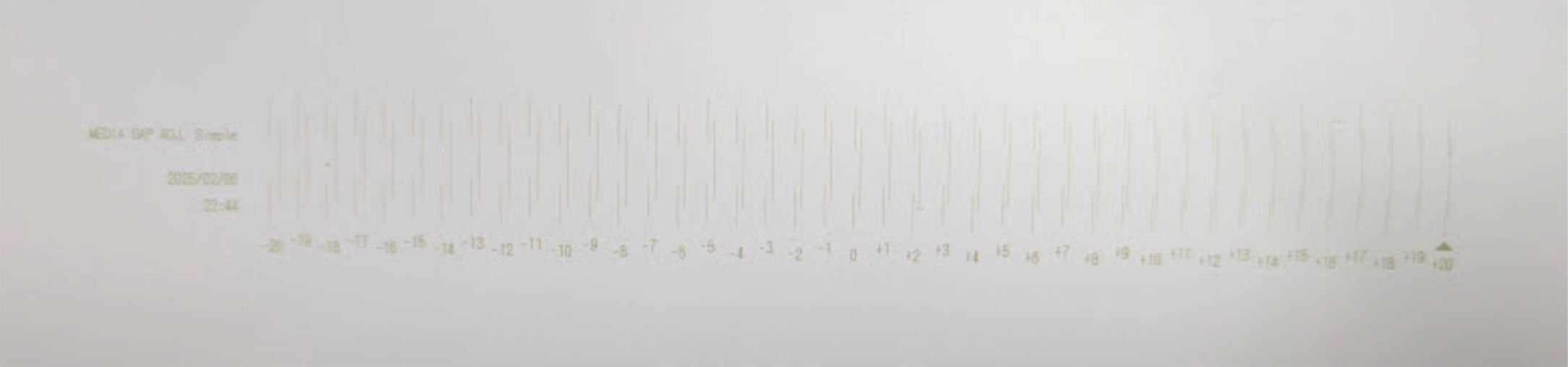

My test print doesn't have a good choice to adjust the Media Gap. Is there a way to reset the values?

Is that just a poor quality image or is the print out that blurry? Might also want to make sure the heads are seated properly.

At least you have that going for you. I'd still make sure the heads are seated correctly, as this happened to me on my SG-300 a few years back and it turned out the tech hadn't quite seated it properly and once he realized and seated them, it looked better. Another thing is, is the head high or low?

The heads seem to be seated properly. No head strikes since my last service. Head height is "High".
As I've made adjustments over time, I always had to go to the "plus" side to get aligned. Now i've run out of options.
Is there a way to make the "+20" my "0" setting?

Have you tried on Low head height. We can't use the high, as it doesn't print well for us, as we don't use thick enough media. You might be able to get more from the service menu, however if you have TR2 inks, you'll either need a tech with the peck tool and credentials or a "cracked" version to be able to access it.

I prefer the High Head height for most of our media (thicker) and jobs. I was hoping that there was something that I could do to reset the values without having a tech visit. The print quality is still good, but starting to get slightly blurred edges on some knock out white small copy.
You can adjust more than what you see on the print out. So it looks like you need to go up to 24 or 25.
of course, if you print in unidirectional, this becomes a moot point.
