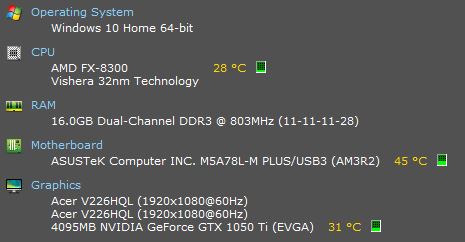

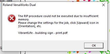

    Can anyone help me understand why this is happening? This file is only around 9mb and versaworks refuses to RIP it claiming there is insufficient memory. Is there some sort of file size limit in versaworks? I don't see any reason why my computer would be running out of memory, it does this on a fresh reboot with no other programs running and nothing else in the queue. What's happening??

    RVW creates massive temp files for the rip data. Your hard drive is probably getting full. Consider taking a look at your drive space on the machine. If its in the red, you probably need to clean out some temp files before RVW will let you rip anything else. If your drive is in fact pretty full, I would assume your have more than a page of jobs in your queue? You may want to start by dumping some of those jobs first.

    This sounds about right. I read somewhere Versaworks recommends having at least 40gb free.

    Okay I haven't responded to this in a bit because we were going though the process of upgrading to TR-2 and Vworks 6 but the problem is still present in 6. I only have 38gb on space left on my primary OS drive so I believe that is the problem. I have deleted everything I possibly can from this drive but its small and the OS takes up most of it.
    I have over 600gb available on my second internal storage drive but I cannot seem to find a way to either install Versaworks to a different location or move the temporary files location like the scratch disk in adobe apps. is this just not possible? Why doesn't roland allow us to choose the install location or am i missing something? Win10 by the way

    Hi Jester - Good question. I don't think you can with RVW6. I am pretty sure (not positive) that the reasons have to do with 64 bit processing, and more importantly - version 6 stores files differently than the older VersaWorks versions did. So that makes it impossible to load the application anywhere else. I don't even think you get a choice of drives when you install.
