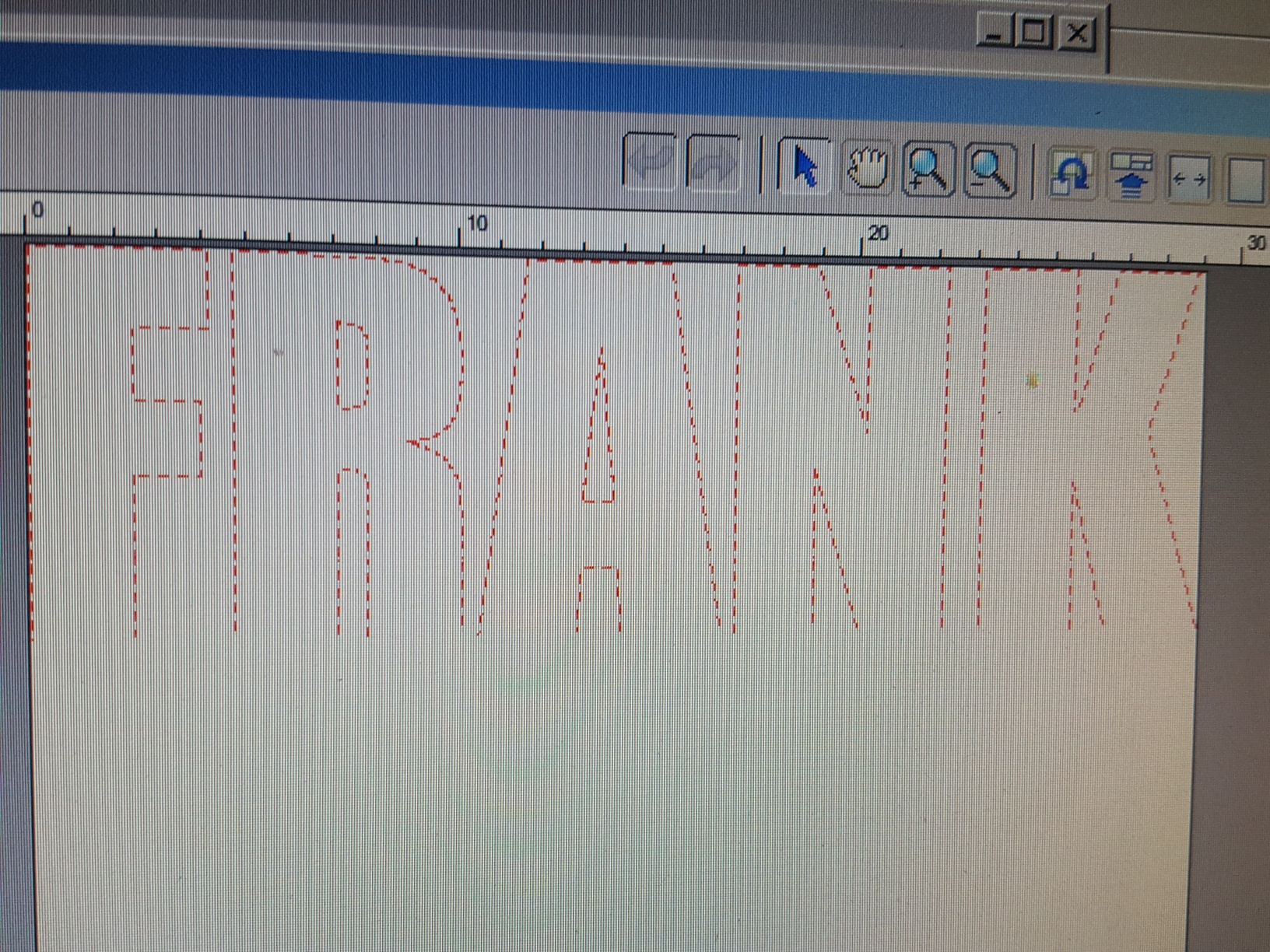

How come my contour cut does not go all the way around my image ? ? ?

Can you provide a photo of an example and perhaps a screenshot of the window in Versaworks showing the dancing ants?
You might have an incomplete path or any number of issues going on.

Agree with EPS margin set to 0.05 as mentioned above. Must edit in queue settings section not in setting you adjust during print setup.

Versaworks has notorious issues with EPS files and specifically cutting off the edges. Use a PDF instead.

still need to set EPS border to 1mm

Different versions I suppose. I think it really comes down to some people changed the EPS margin and some didn't so you see it both ways in the field. Maybe your settings were reset to default or something like that.
