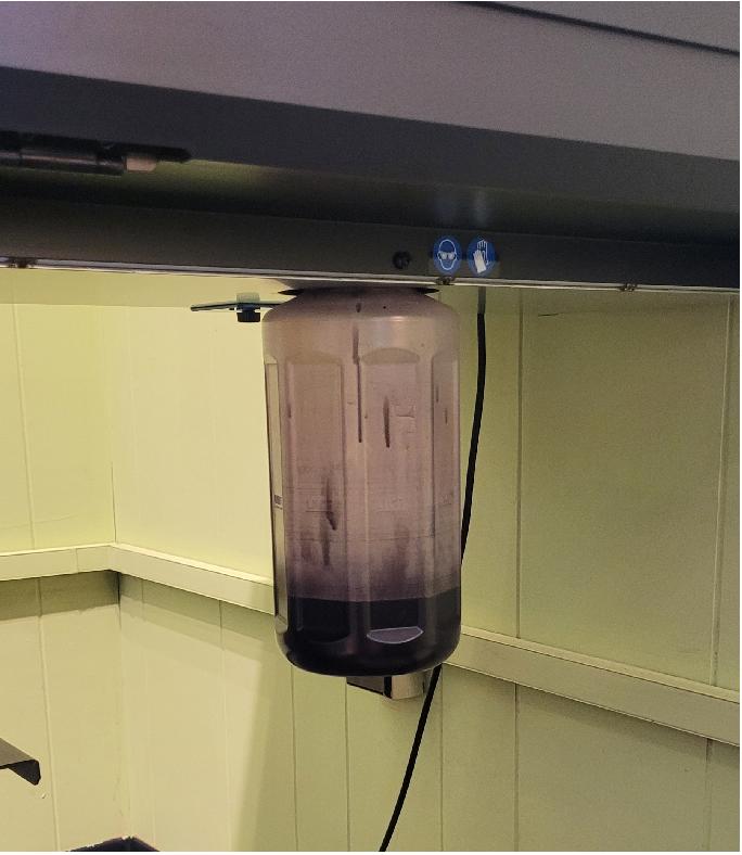

Joesignshop
After about a week of normal to low hours of printing
somcalmetim
I've never measured it...I would estimate the VG2 wastes less than that a week tho...VG3 is to new to tell, still have startup waste in it...
Periodic cleaning set to none only stops if from running a cleaning cycle periodically during long prints, the normal maintenance cycles are required or your printer will dry out....I don't think you can cancel them without yanking the power and leaving it unplugged while your heads and ink lines dry solid.
Either way the waste ink should be figured into your normal Cost of Doing business...its either waste $50/week in maintenance cycle ink or replace heads and capping stations when they dry out.
Got about 1.4" in the waste bottle on my VG2 and can't remember emptying it last...not a huge shop but mostly large vehicle graphics.
We missed the VG and went right from Pro2 or 3 to VG2 so not sure but seems like less ink waste (also has larger waste bottle sooo...) ...only time I have noticed a huge amount of waste is if you do dry out and have to do a bunch of heavy cleanings to try and dislodge clogged dried out heads...only prob I have had with VG2 is a clogged cap station caused some color shifting but if you keep the head clean and the capping stations moist and unclogged its been great...only prob so far with VG3 is colors are brighter but having trouble getting the same deep dark RGB black as I can get with the VG2.
