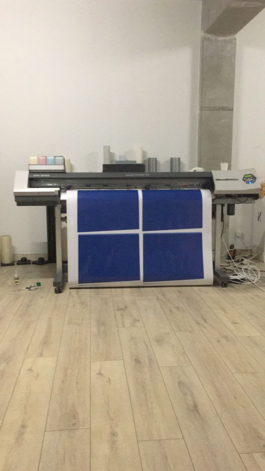

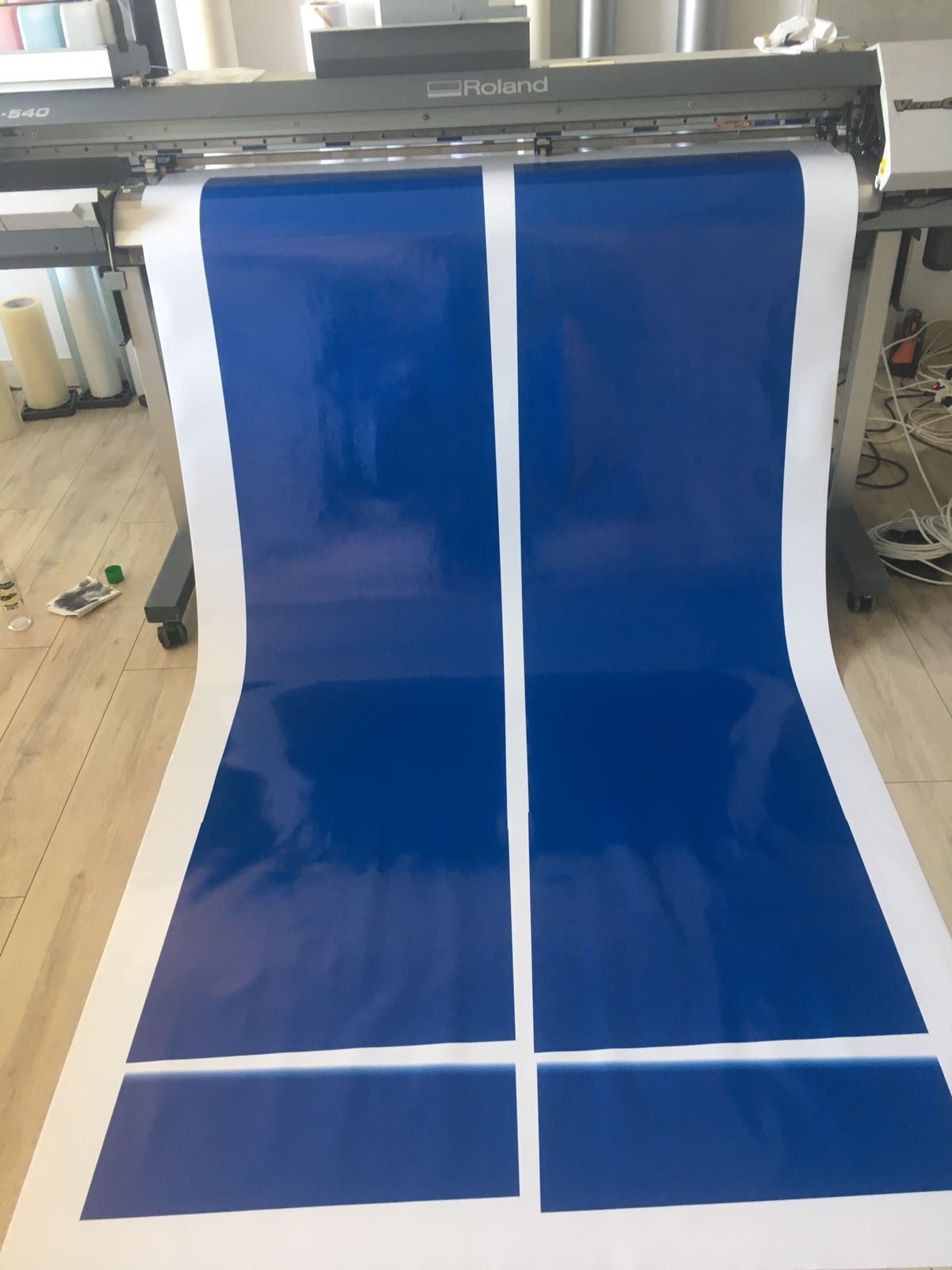

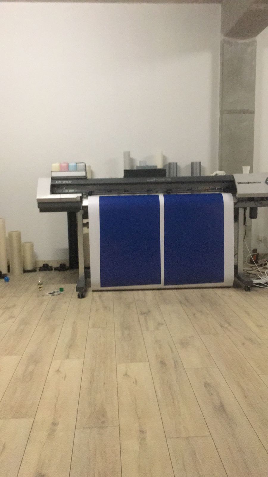

Hi, again ..
i also got some Problems with the Connection.
Sometimes it works sometimes he break the print.
See the Picture.

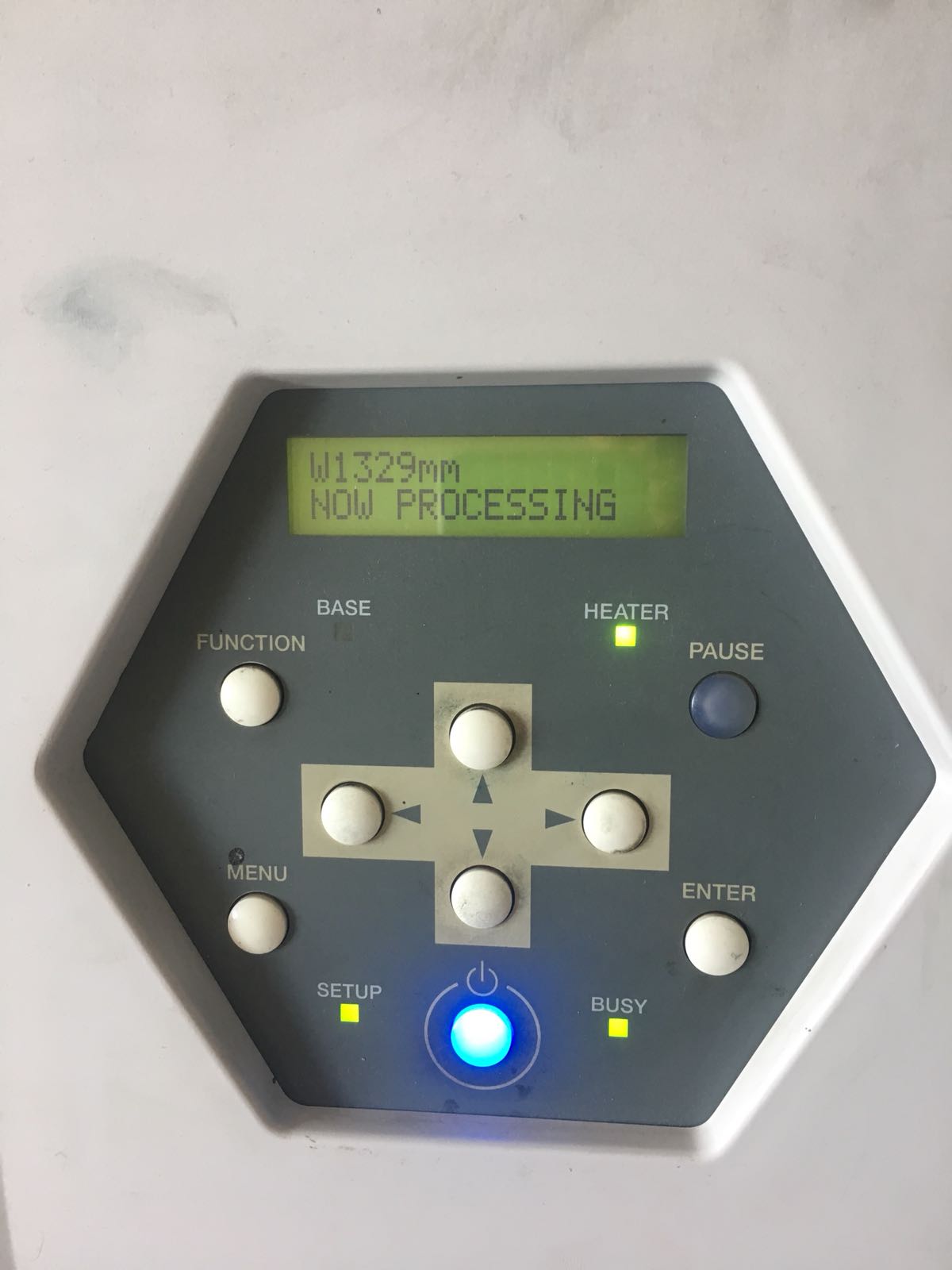

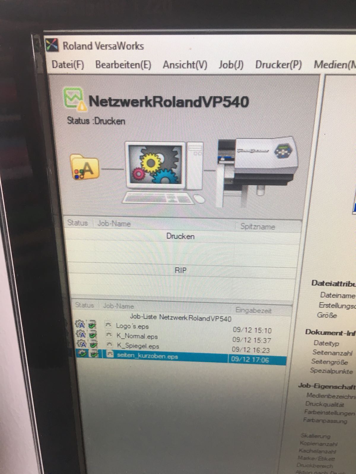

Last Print - Versaworks say Printing... and my VP-540 now progressing ...
but he still not print.
why does the printer stop differently?

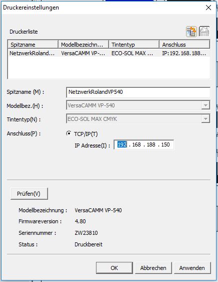

The program can not find the printer port.
Check the port of your printer in your printer's software.

2 - Ensure that your network is not the issue. Please connect your the print to your computer directly. Then change your IP addresses on your computer and printer to perform a direction connection.
