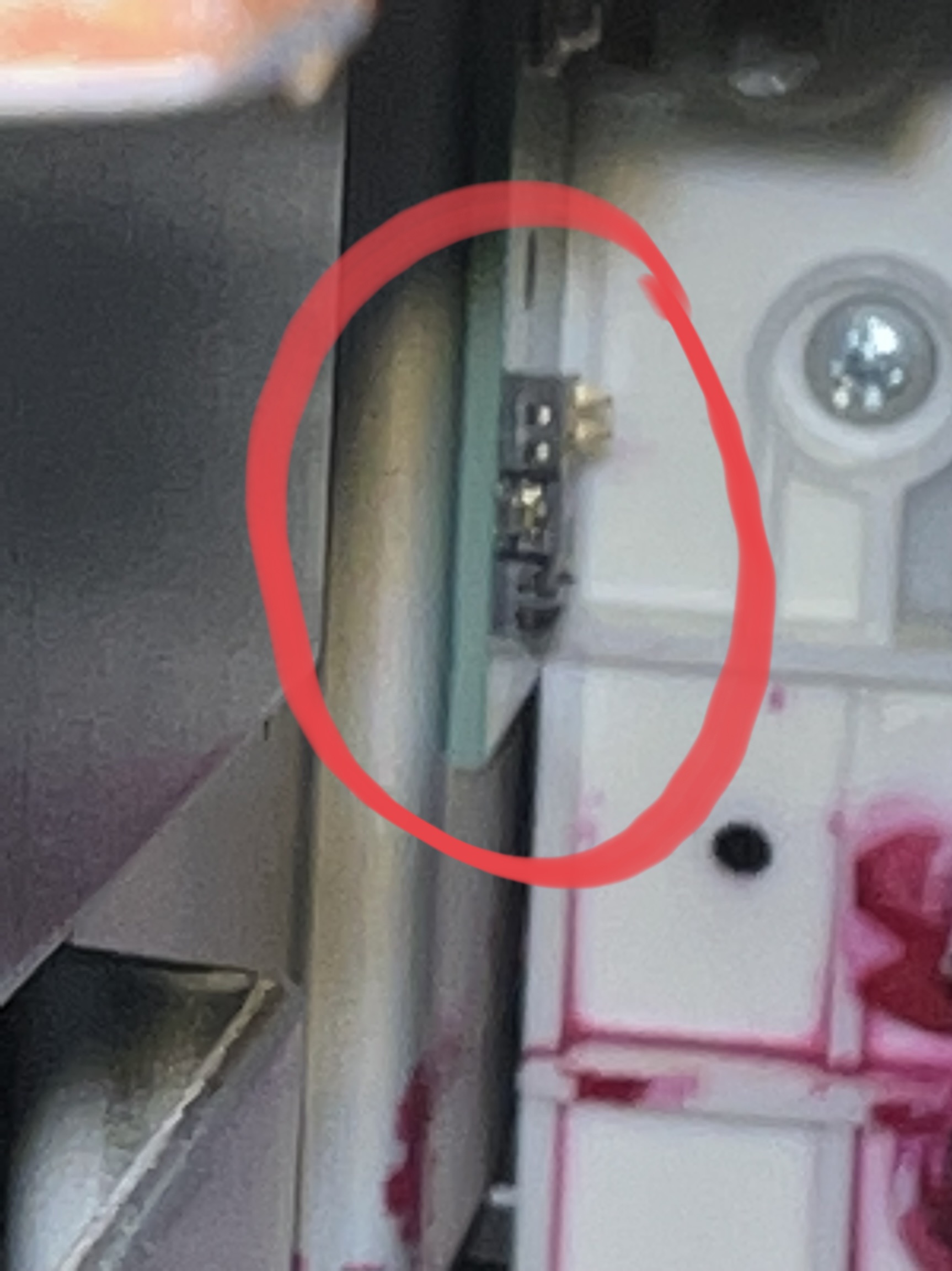

Hi I read your post about your VP-540 chips not being detected in service mode and goes into cleaning cycles every few minutes when printing. Did you ever find an answer? I have the same problem with my VP-540. I have tried taking the OEM Sol Max Chips off and put on my bulk cartridges and still it won't detect the IC chips or stop cleaning way to many times during printing.
graphicsphere
Here’s the answer:
I have a VP-540 that has 2 broken IC Cartridge Sensors inside Slot 3 and Slot 4 of the Ink Cartridge Slots. I attached a picture of the sensors that I need to replace. There is no manual on how to change them out and just need some pointers on what to take off first so I can get the sensors replaced.
Mikethestripe
Lines ,signs & designs
Here’s the answer:
Hello graphicsphere,
Did you happen to have the part # for the cartridge sensors? I am having the same issues as yours
