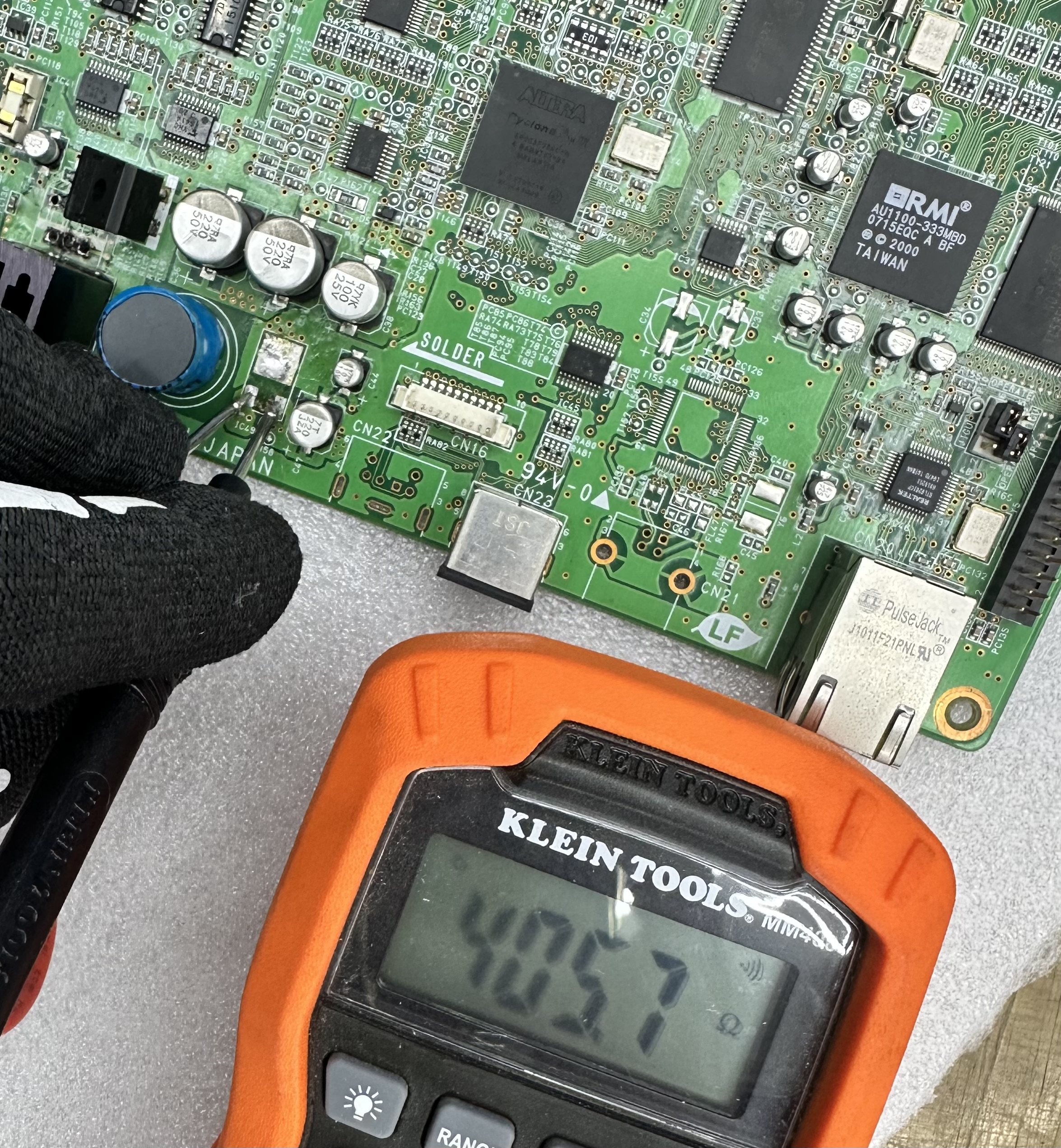

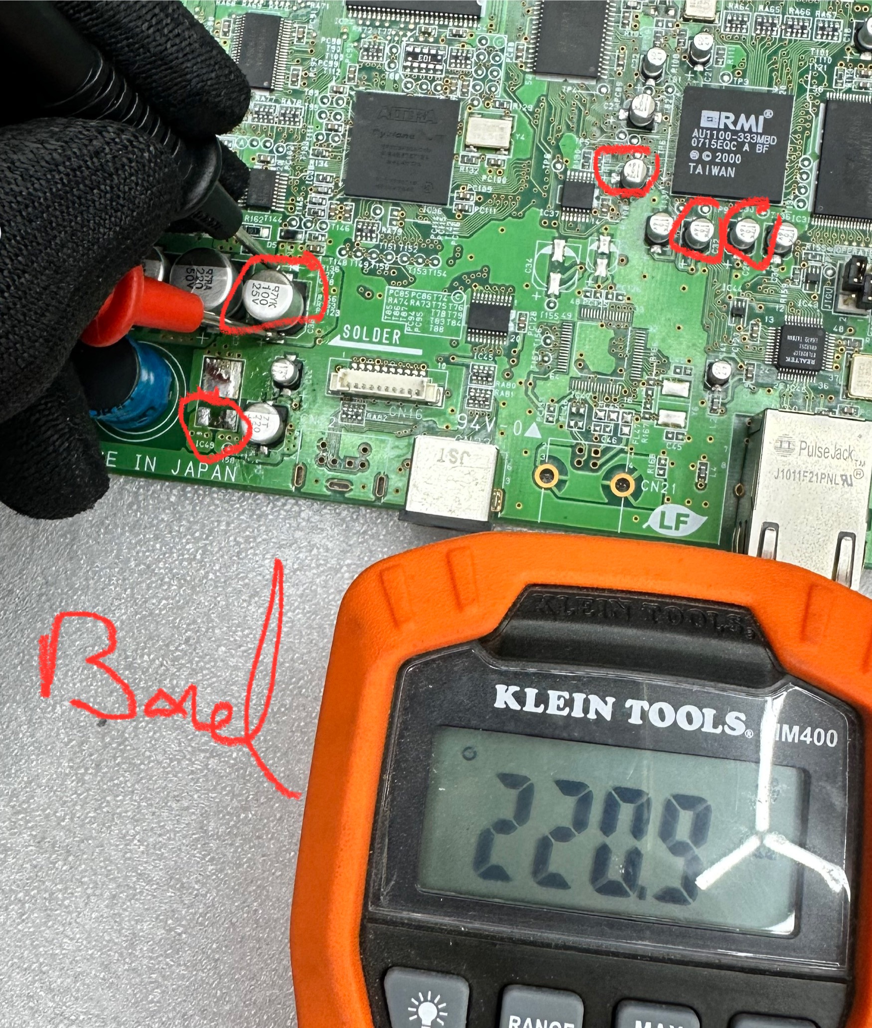

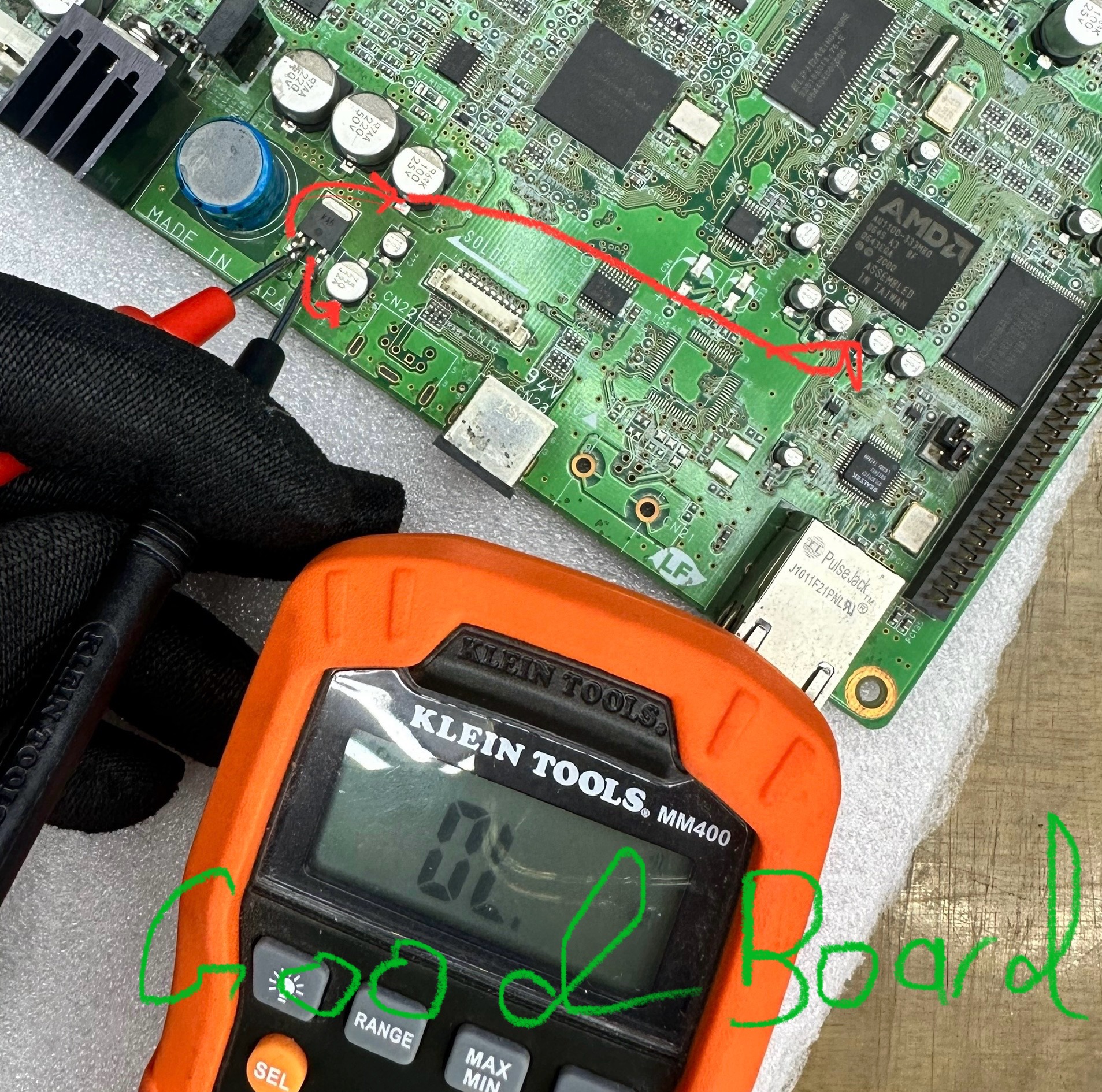

I think I found a problem on this rail (VCC3?). Bad board shows a value, with or without the working ic49 that I removed and several capacitors on VCC3, good board is OL. Yet to find the component responsible

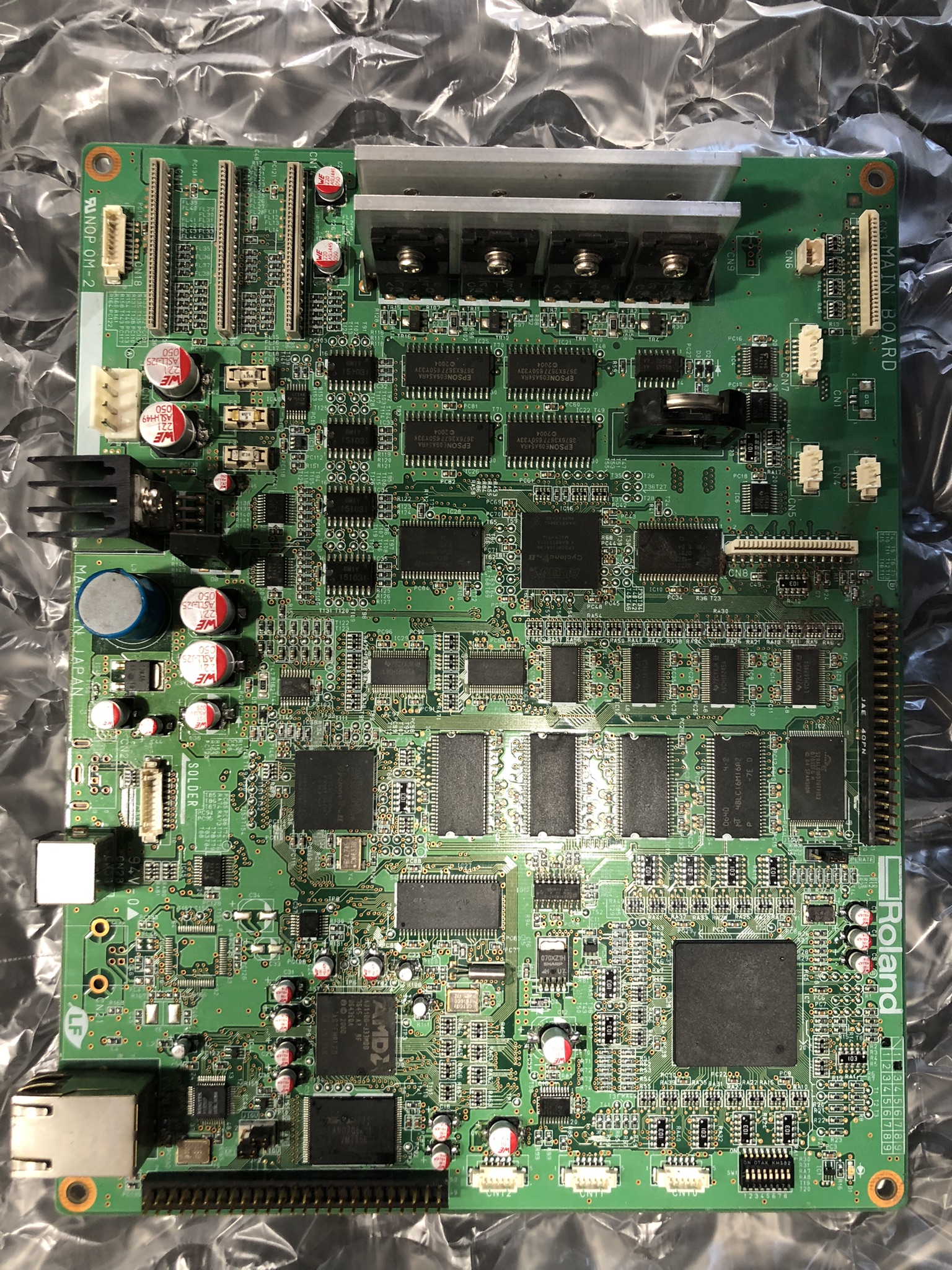

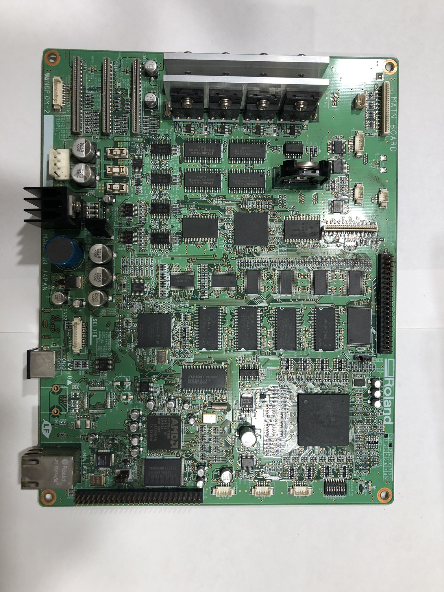

JKstorm
I have a VP 300. Bought it when they first came out. Over the past several months I have had a problem with the machine disconnecting randomly, which ruins any print that I am running. I have tried several fixes but it really came down to a problem with the main board. I sent it out to these guys.
Brooks Circuit Specialists
They replaced several of the boards components, tested it and assured me that it was problem free. They did not say that they found the problem but they did say it was a complete rebuild. This board was on their list of boards that they regularly rebuild. So far all is good. They charged me $450 including sales tax. Well worth the price considering lost time and wasted material as well as aggravation. I realize that this is a different problem that is being discussed here however a bad board is a bad board. (see before and after images).
cornholio
Looks like their "complete rebuild" consists of cleaning the board and replacing the elcos. Maybe a reflow on top. The reflow cold help in this case, but there is no guarantee...
I wonder how they test it, except they have a printer...
But if it works, it's worth the money...
