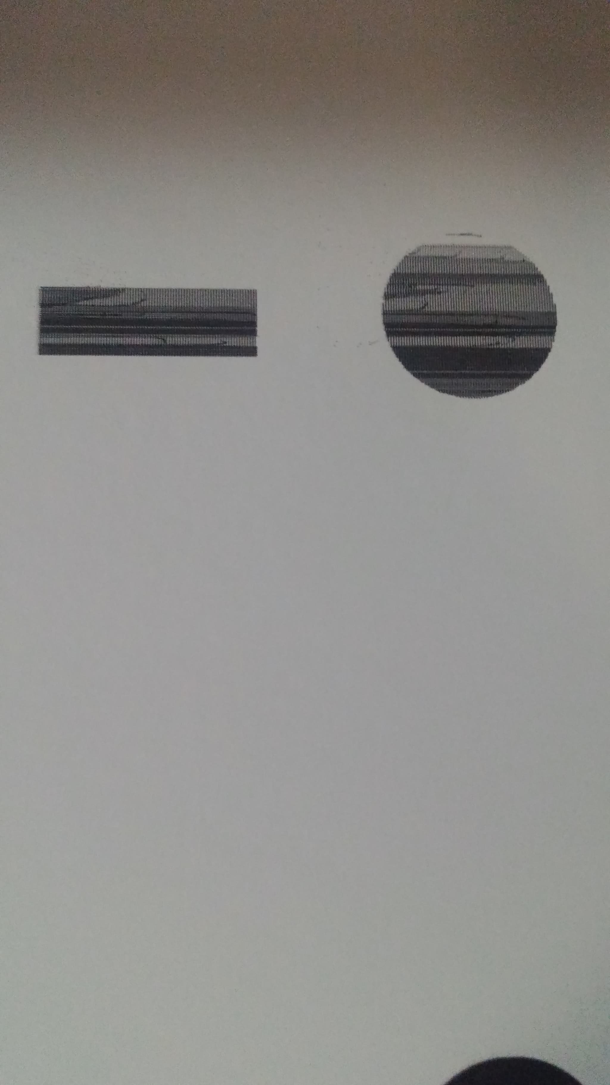

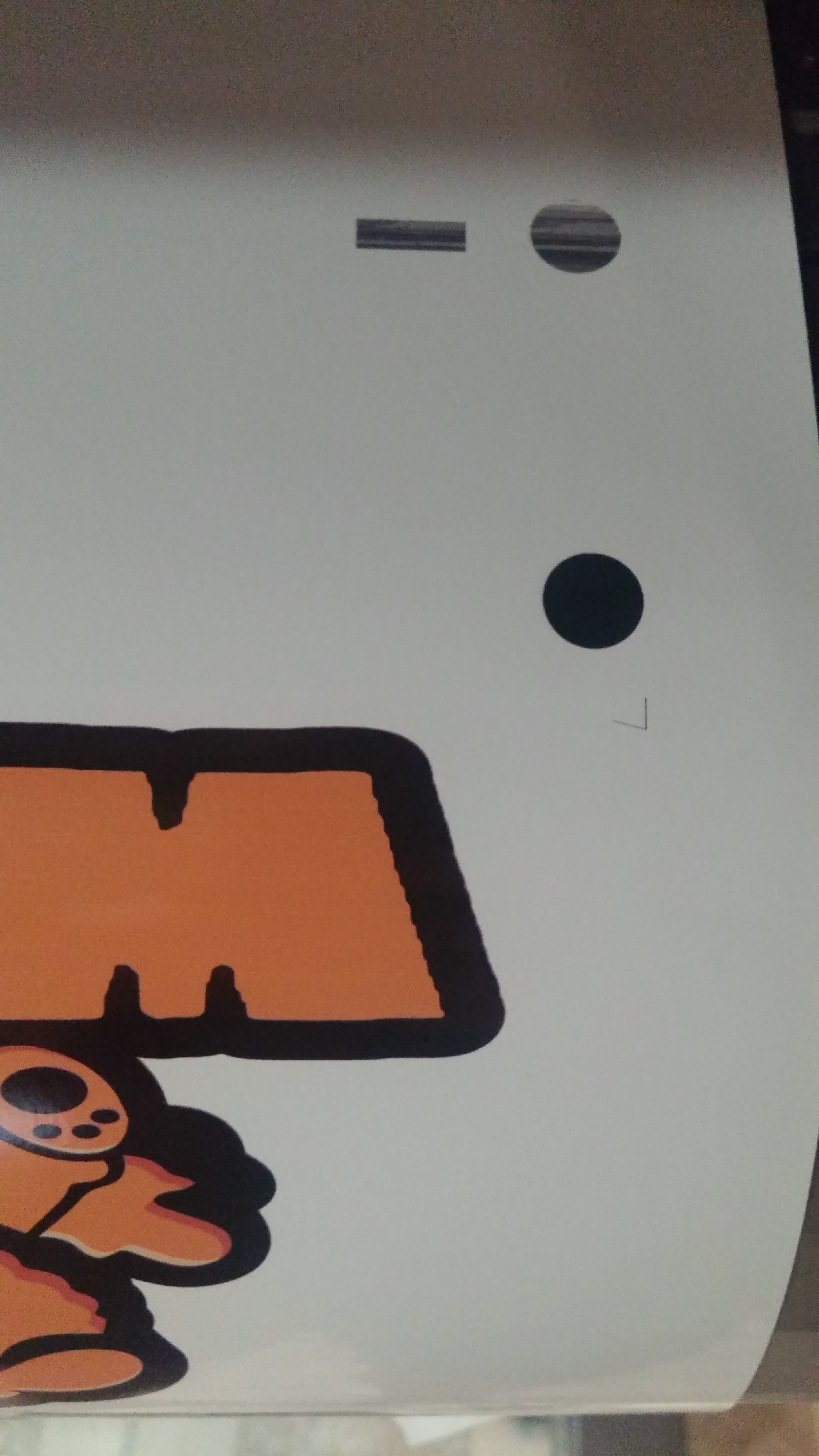

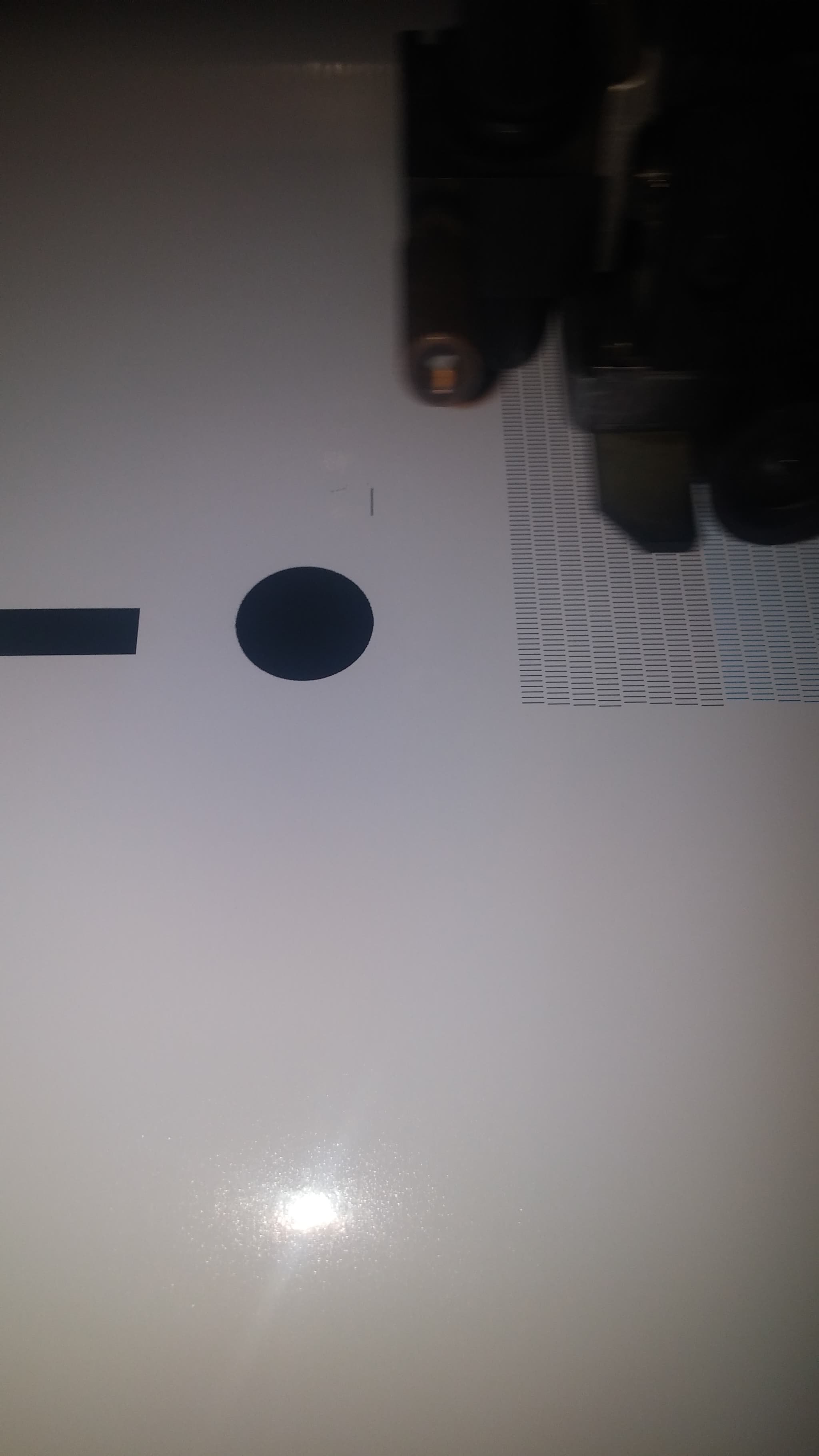

Im on my second vp540. IT prints me fist print perfect no matter how big. Even the Crop marks are perfect. As soon as im done my first print i select my next print and the crop marks come out messed up. I clean the heads and start to print and the whole print is good all the way thru. It doesnt matter how long the print is so it has me confused. any help is apppreciated

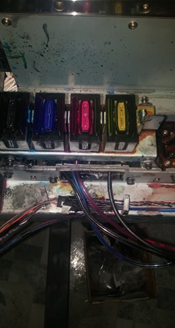

When your carriage goes out to print is the cap full of ink?
When have you last done basic service? Caps, wiper etc?
There's nothing on the bottom of carriage? You have cleaned around the heads?
evil ink
yes the tops have ink in them no bubbles in the lines i can see. have new wipers and cap station. Heads get wiped around the egde once or twice a week. head hasnt touched anything.
It literally finished printing and i pressed print for the next file

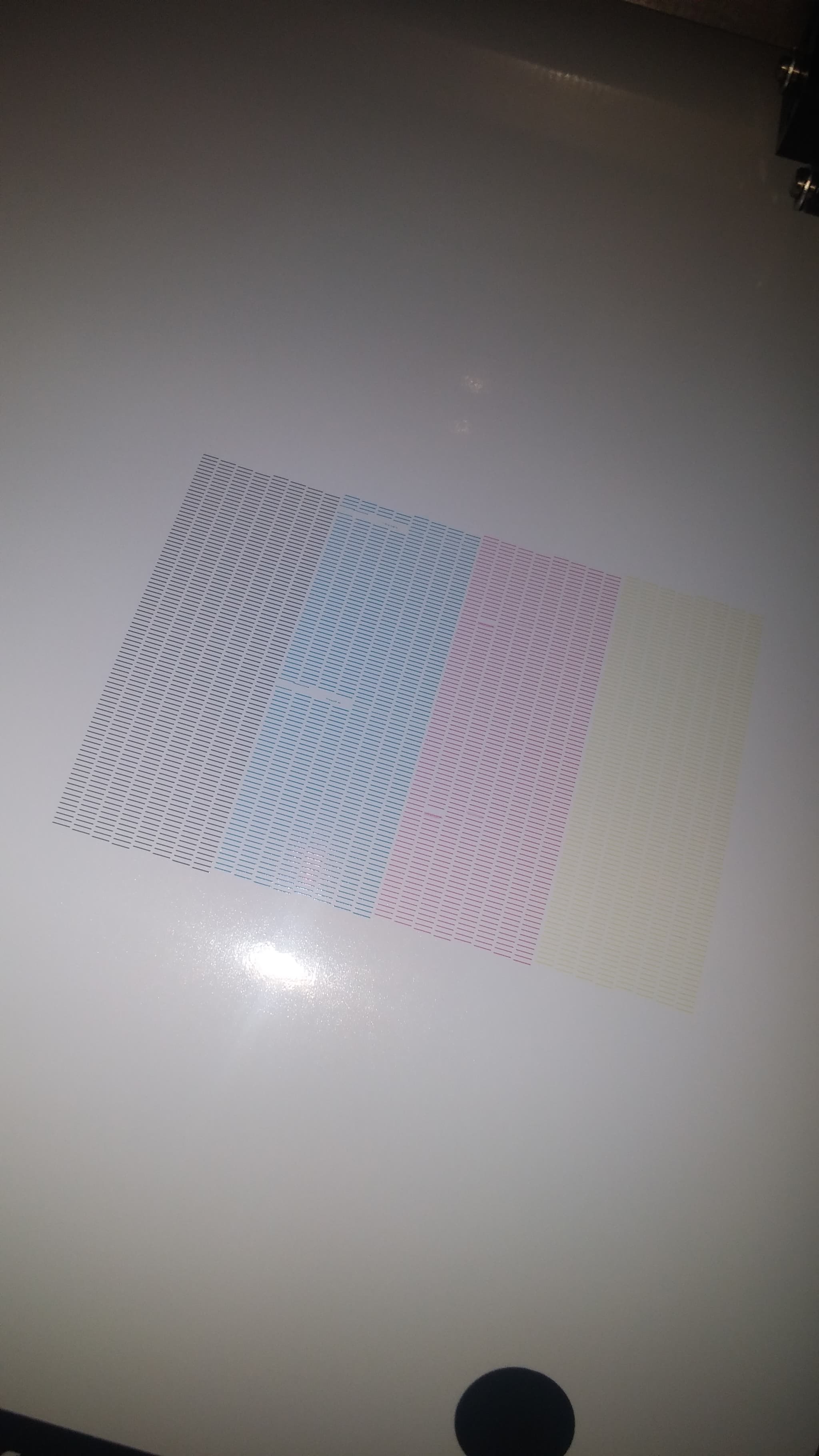

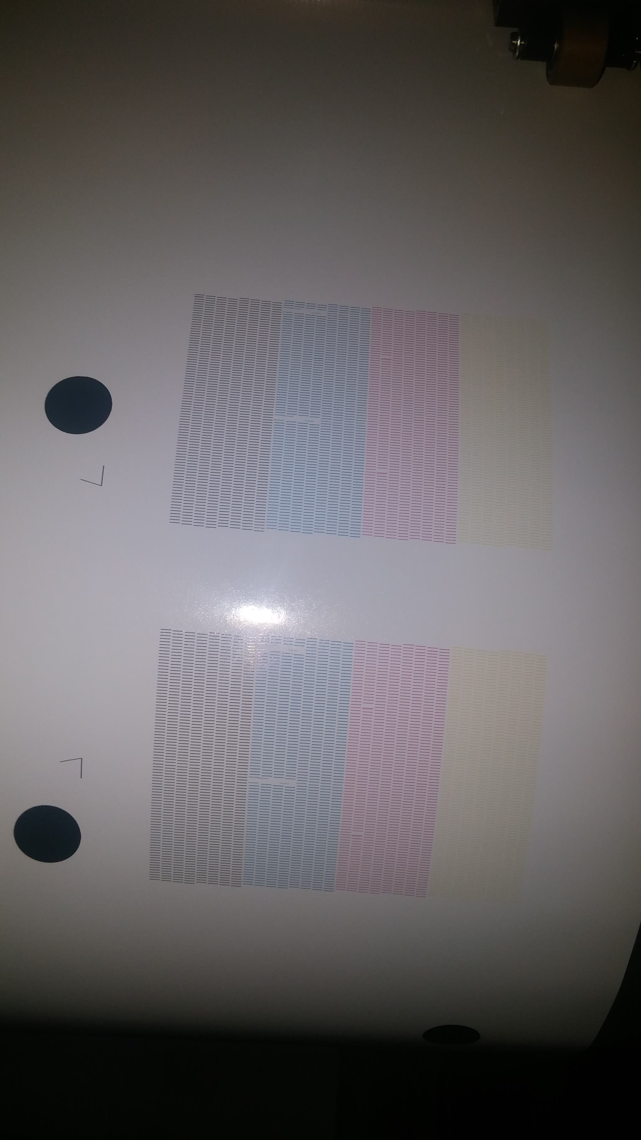

If I understand correctly, the caps do not have ink in them after a cleaning cycle and they shouldn't. The dampers should always be at least 1/2 to 2/3 full of ink. When you print again, as soon as the print is finished, please print a nozzle test print and post here. We will go from there.
Jim Hancock
Old School Technician
As requested, a pic of the nozzle test print immediately after a good print job is the next step to help determine your issue. This is the only way to start to determine what is wrong...
evil ink

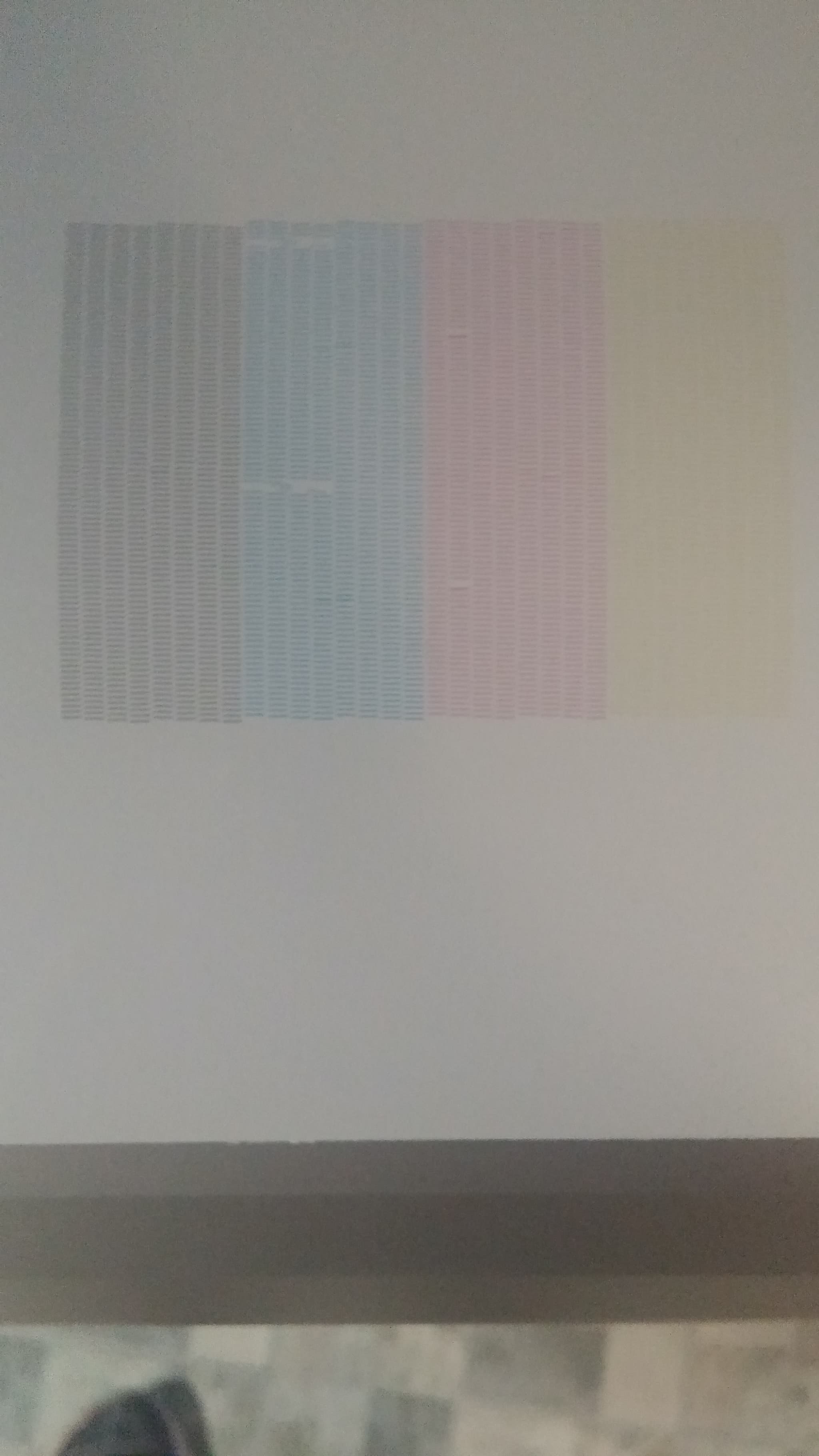

soo went to my printer. did normal cleaning got a good test print. printed 200 decals. did test print and it was find. did another print of 8 decals and was good and so was next test print. i did notice around the cap station liked like there was a decent amount of ink. im going to clean that today. i wonder if its not removing all the ink? i appreciate every ones help.

I see from one of the pics that you have some aftermarket caps. The issue you have could be related to aftermarket parts. When was the last time you replaced the caps and dampers? You want to use Roland OEM caps and quality aftermarket dampers.
Solventinkjet carries Roland OEM caps. Roland Cap Top | Solventinkjet.com I learned the frustrating way about the inconsistency of aftermarket caps and only use OEM, especially on DX4 heads. You can also order O-rings from them. 2mm O-ring (Pack of 5) | Solventinkjet.com Small dampers - Roland Small Damper & O-Ring | Solventinkjet.com Large dampers - Roland Large Ink Damper & O-Ring | Solventinkjet.com
These guys are techs as well as dealers and I have had consistently good results with their parts.

To me it looks more like a board/cabel problem data looks scrambled.. one print OK but then it warms up and craps out..
If i a run a normal clean it prints fine again the main board was replaced a few years ago.

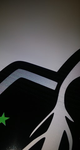

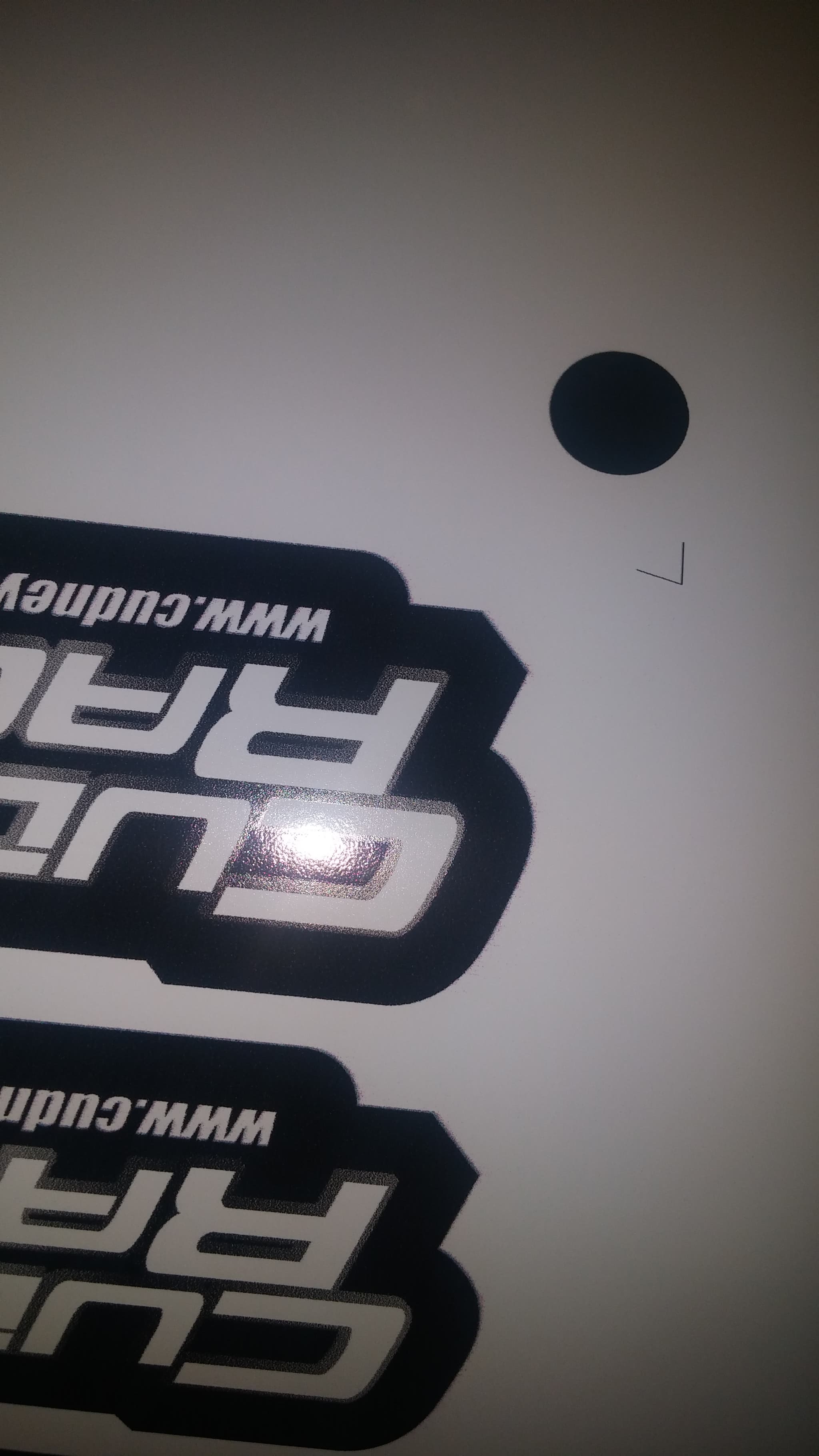

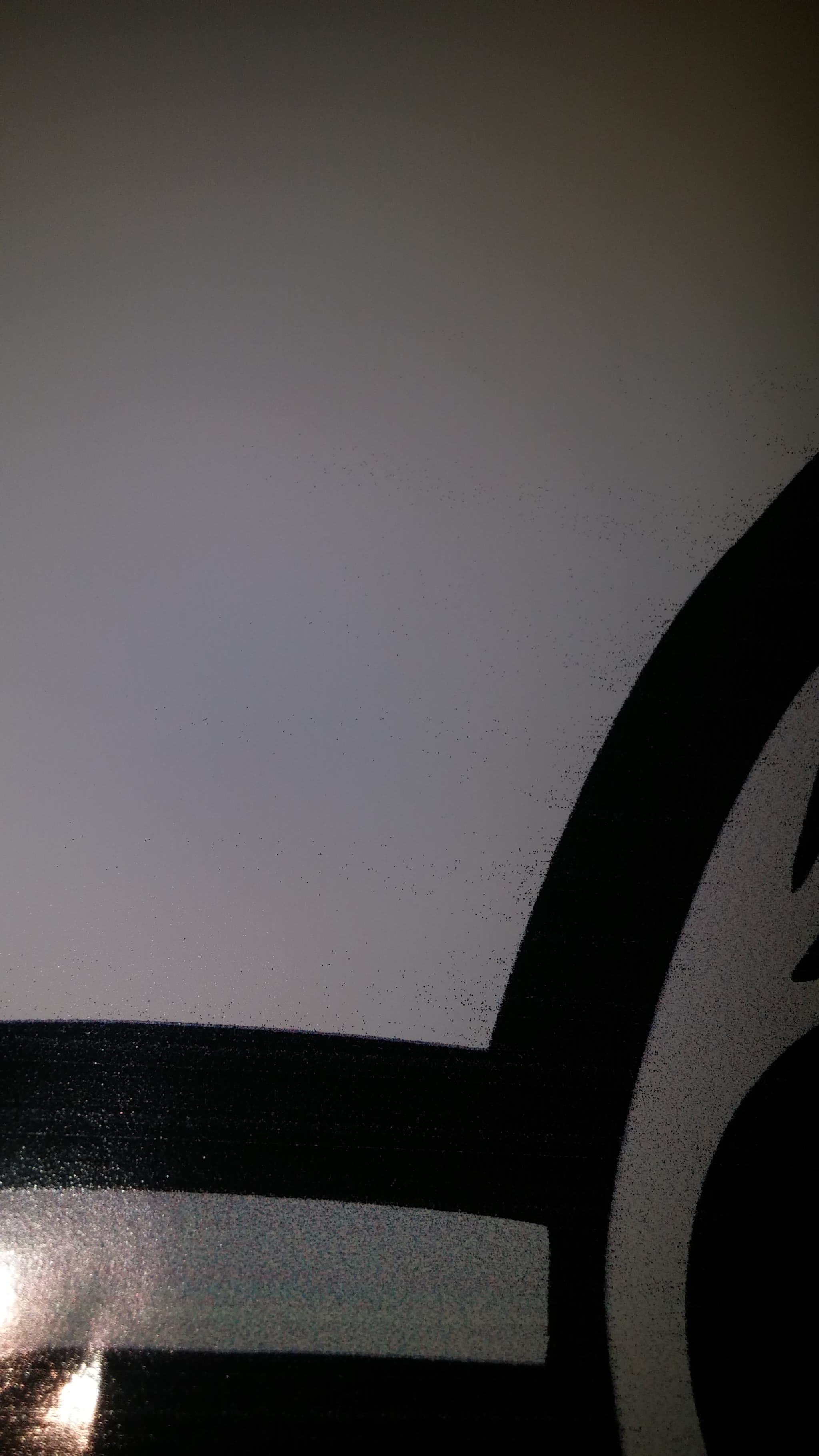

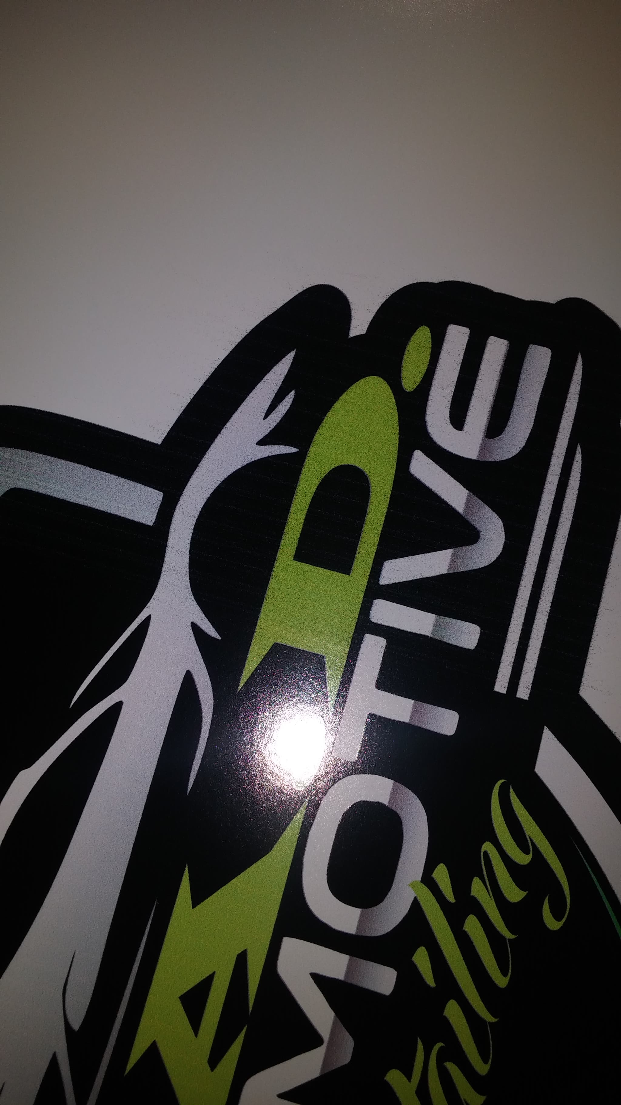

ok guys here's a update. i haven't switched the dampeners yet but im going to. i did a small print today and the last cpl inches of it went all messed up. over spray and stuff but then printed the crop marks ok then my test print came out perfect. any ideas. im thinking its a the print head board. an help still is greatly appreciated at this point

It is possible a component is heating up and starting to fail, but let's eliminate the inexpensive parts first, i.e., the dampers. What head height are you set at? This time of year static can be an issue. If your head height is on high, lower it and see if the overspray goes away or improves...
