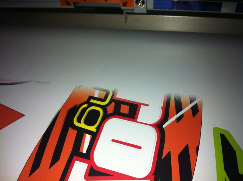

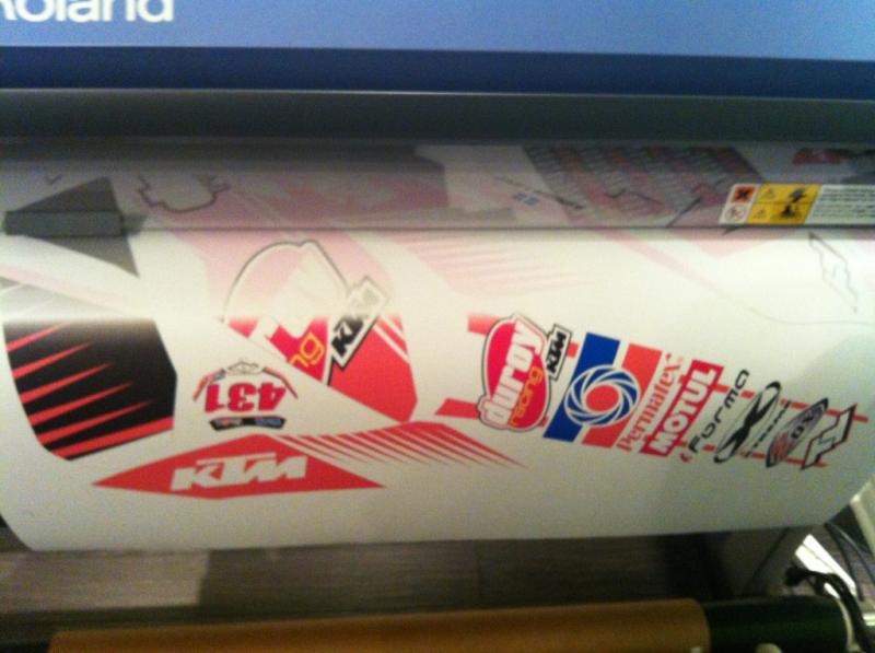

Ok here's what happened. I select the option ''off'' in full width scan.
Started to print, then WTF? Picture 1 ( looked like I ran out of ink)
Looking closer, the head printed all the way back to starting point even over the wiper!
So I restarted my print, then (picture 3) I got fuzzy spot (look at the yellow ''g''.
That was yesterday. The printer is brand new from last friday!

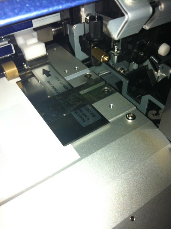

Then a few minutes ago I started to print the metallic color chart
and once again! (picture 4)
So I went back to settings. Menu-sub menu- full width scan. and changed from ''off'' to ''Sheet''.
Things seem to be good by now but still ....
How frustrating it is to pay 25 000 for a brand new printer and find out about these problems the second day of printing ....

Custom_Grafx
Not human error.
That happened to me on my vs640 about 2 months ago. Never seen anything like it in a year and a bit, then I got 2 of those funny garbage data things in the space of 2 weeks.
I don't know if it has anything to do with it, but since then, there have been around 3 firmware updates. I haven't had one since those 2, so it could have been a FW bug... who knows.
What version FW are you running? You can tell by double clicking the printer graphic in VW.
Latest is 4.1.
Your VW should be 4.5.
Skye
static
it is static build up.
happened twice last month. Roland told me to turn off printer, unplug, reboot computer then turn on printer. worked perfect after.
we have had a dry winter and static is an issue here in Canada.
hope this helps
Skye
Custom_Grafx
I've noticed "static" is one of the top 10 of many rolodex options available when just about any problem is encountered.
It was not dry here when I had the exact same problem, and I am in the southern hemisphere.
I call undisclosed FW bug.
