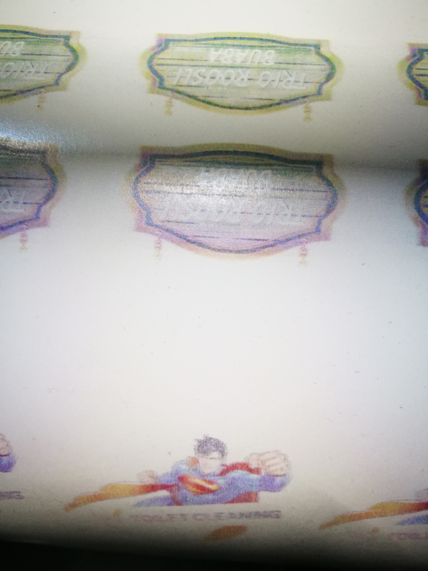

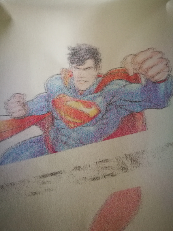

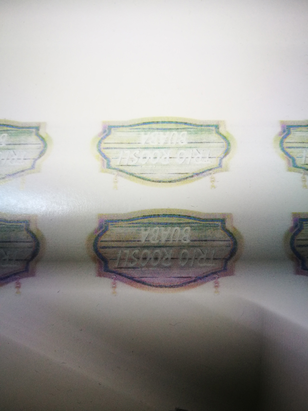

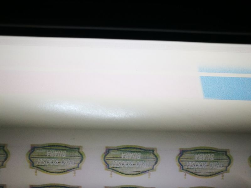

Hello everyone hope someone can help me, my Roland VS640 after I installed a new printhead does not do a test print anymore. Did the following
New capping
New wiper
New felt
Encoder strips cleaned with isopropanol
Encoder sensor carefully cleaned
The ink flow runs smoothly through the cap into the waste container

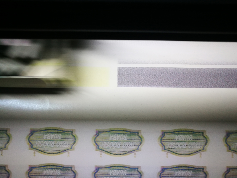

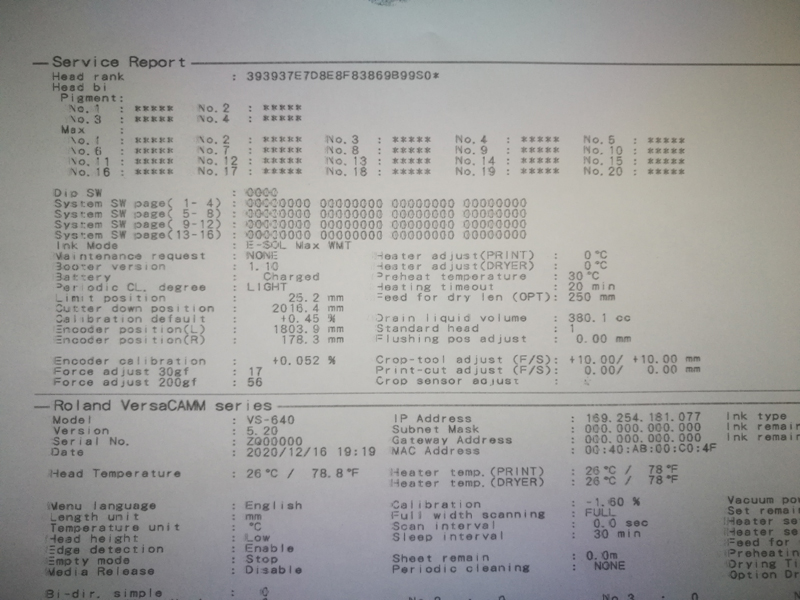

When I print the protocol from the service menu it prints (see picture)

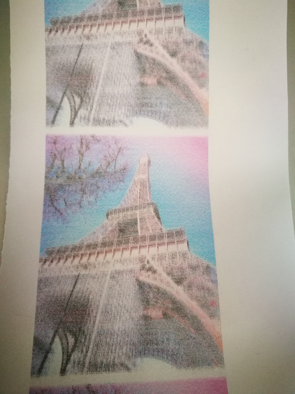

But once I do the test print no lines don't
The pictures come from the Versaworks like this (see attachment)
What can it be (a bad printhead ??)
Ask for advice

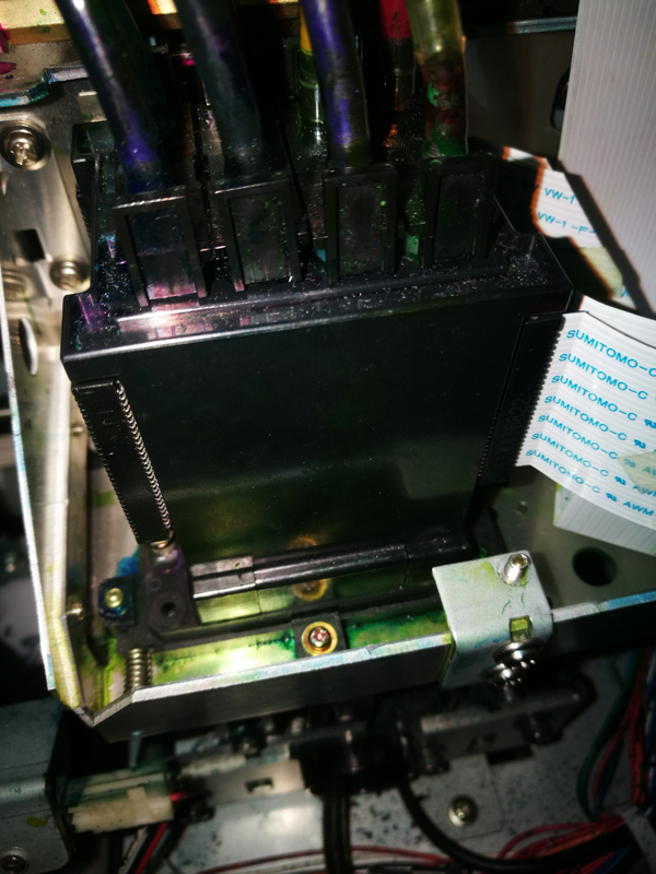

Here is another picture of the print head, it is sitting correctly in the car otherwise the protocol would not be printed
Jim Hancock
Old School Technician
Look at the head from the front bottom and see if it looks perfectly parallel to the platen. As balstestrat asked, has the head rank been entered? If both of these conditions are ok, I would suggest powering down, unplugging the main power and reseating the cables on the print head.

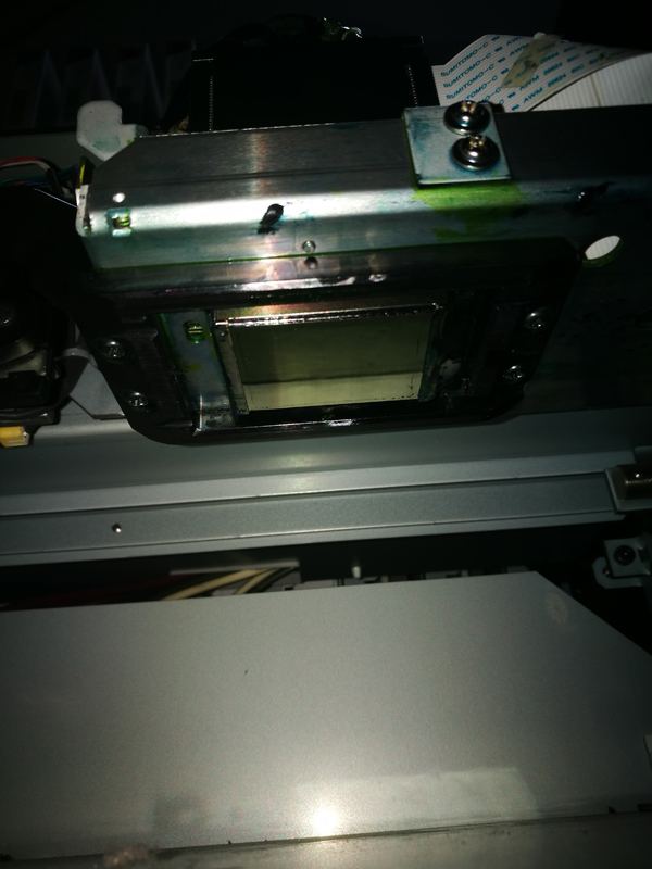

Jetzt überprüfte ich den Druckkopf erneut, um festzustellen, ob er gut sitzt, und schaute erneut auf die Druckkopfkabel, um festzustellen, ob die feinen Metallkontakte beschädigt waren. Hier ist ein Foto von der Unterseite des Druckkopfes

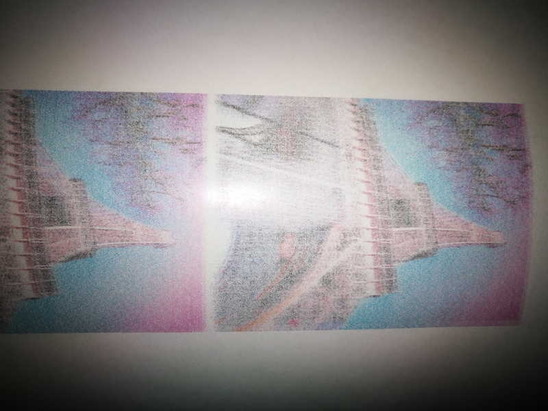

FrankSwiss
Wenn ich jetzt einen Testdruck mache, kommt nichts heraus, keine Zeilen, nur leer, aber Versaworks druckt diese Dateien auf diese Weise
