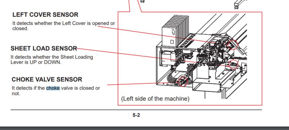

Hello CSOCSO, the VSi models have an automatic valve. It sounds like you have a standard VS model. See the attached picture for the location of the valve. Turn clockwise to close.
Its is a vs540i model
That has an automatic valve? I spoke to a tech he told me the hole is on thatbside like on the pic but he said i don't have to remove any panel to access it. I guess because i have the 540i model there is no hole on the outside. Can you confirm that is this is correct?

on a older VS540 its a hole bottom left of the left side panel and if i remember turns anti clockwise aprox one third of a turn key board beebs to say its over to block the tubes. its mainly used to rid air from the pipes but has left me with head problems as a rule after so wont use it any more.. big strain on the pumps etc.
other replies while typing best of luck had a feeling the I model was different
Hello CSOCSO, activating the choke clean on a VSi model should not prompt you to close or open valve and it should be able to finish the cleaning without any manual intervention. If you are getting an error, please send us a private note and we will recommend a local dealer to take a look at your unit.

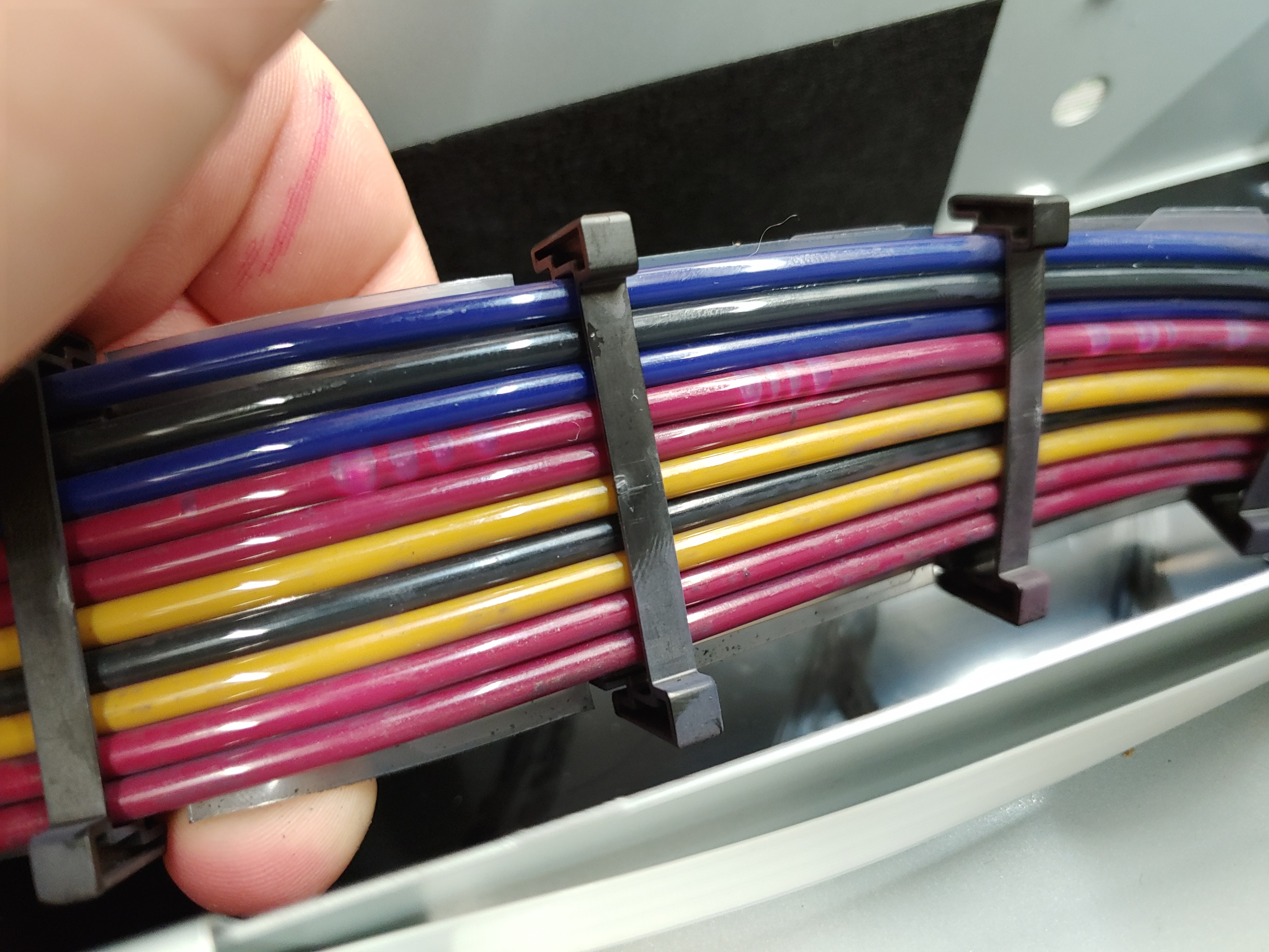

I have the 540i. I dint see holes on the outside of the machine under where theybusually put the roland passport. I tried to do the light choke cycle. Now i lost the magenta too. Before i had only lost the yellow. I pulled the yellow ink all the way to the head yesterday. Now i pulled the magenta to the head but that one has bubbles in it. Should i change the cartridge and pull ink until bubbles are gone or these bubbles are ok? I done the choke cycle and still got no ink back

I just did another choke cycle and the head pumped magenta back into to the yellow tube

a light choke will not resolve your issues. You need to be in service mode and do a few full chokes after replacing the captop.
And from the sounds of it you need to hire a tech before you contaminate all of the ink lines.

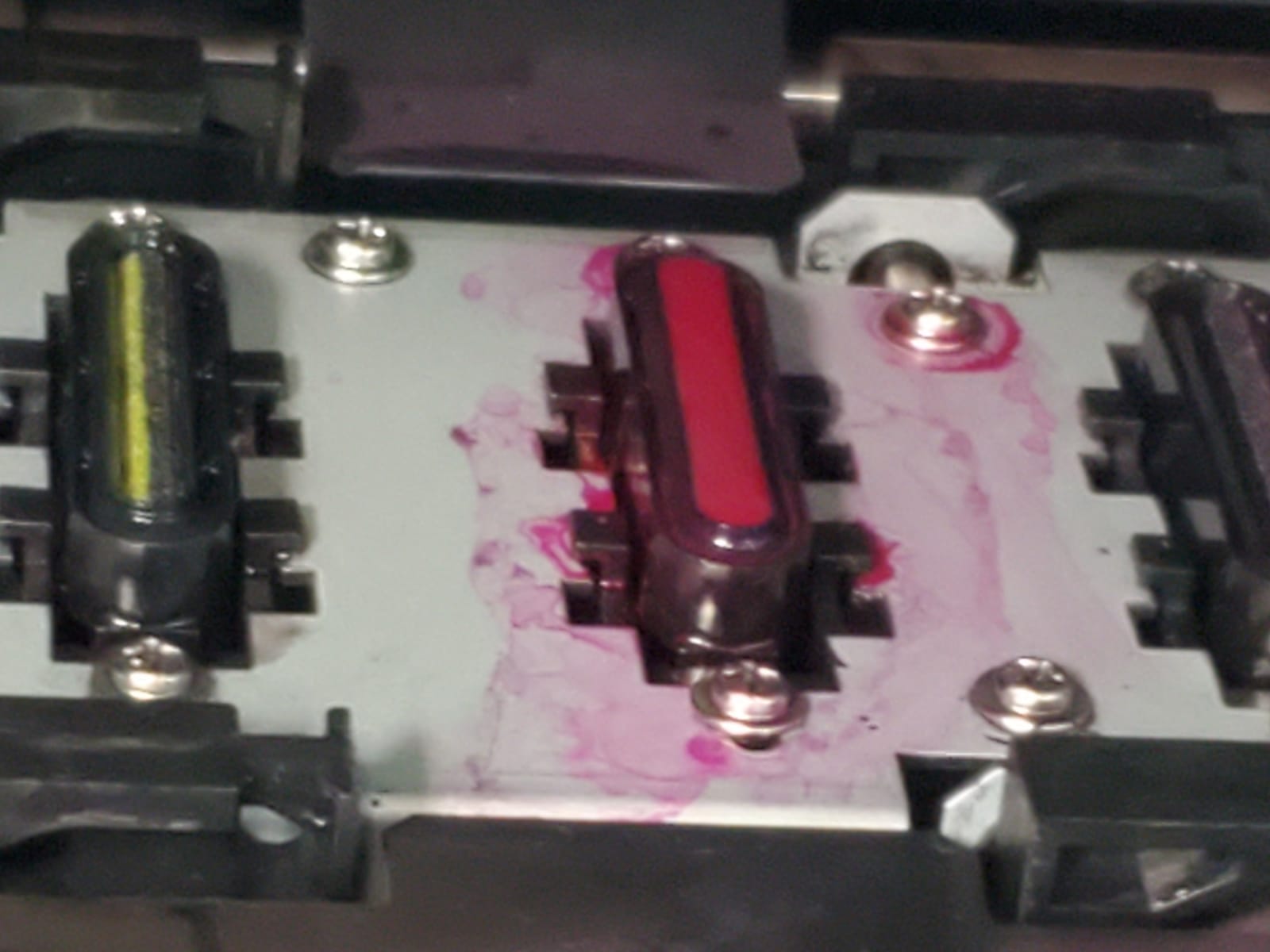

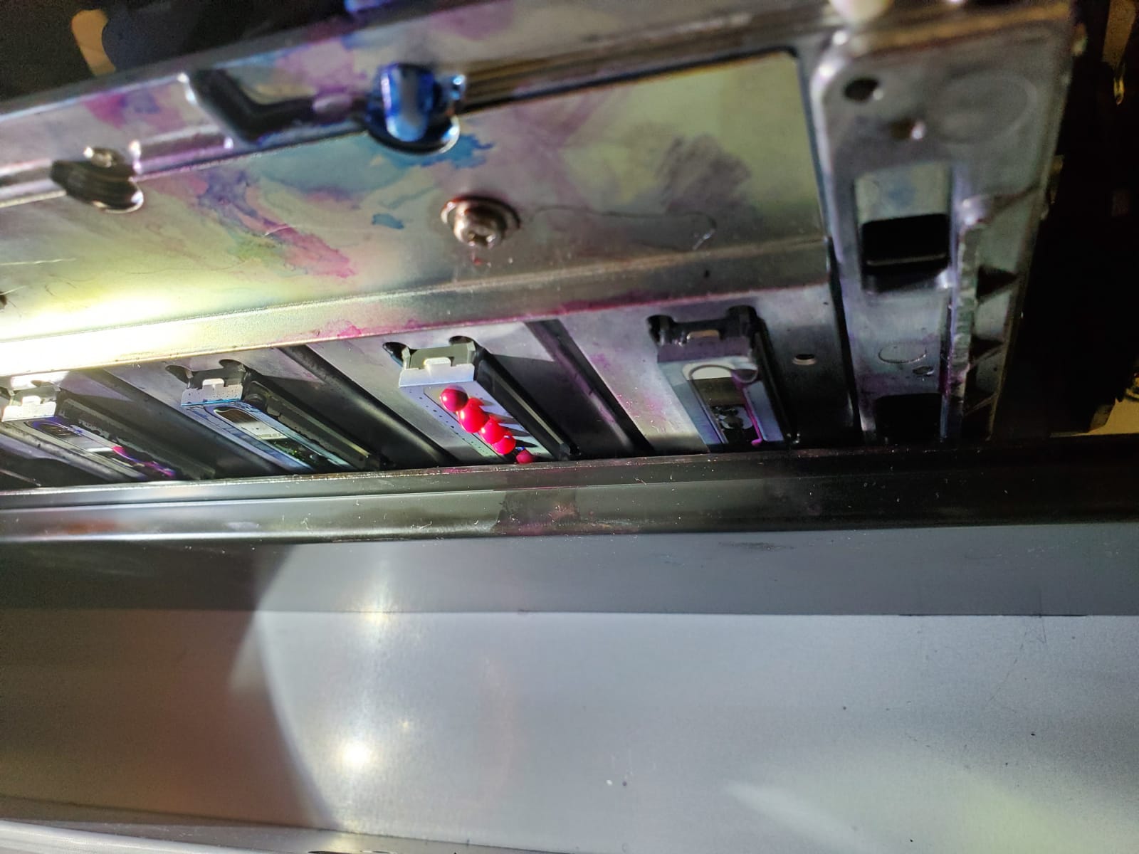

I have a VG-540 and the ink keeps bleeding through my magenta head. Roland certified techs came to replace the cap station but the problem persisted. They came again to replace the head & dampers and a day later the magenta ink again started bleeding through the new heads again... If I let the machine sit for some hours, I can get about an hour of printing before bells & alarms start going off. I have also spent about $2000 on these part changes that have fixed nothing & have no clue what is wrong with the machine or what to suggest to these technicians who are just making costly assumptions. I am actually tempted to think my choke valve may be the problem but I have no idea if these are symptoms of an ink choke valve gone bad.

They just replaced the choke valve & I printed once, turned it off & turned it back on again & bam! Third head Light Magenta leaking again.
