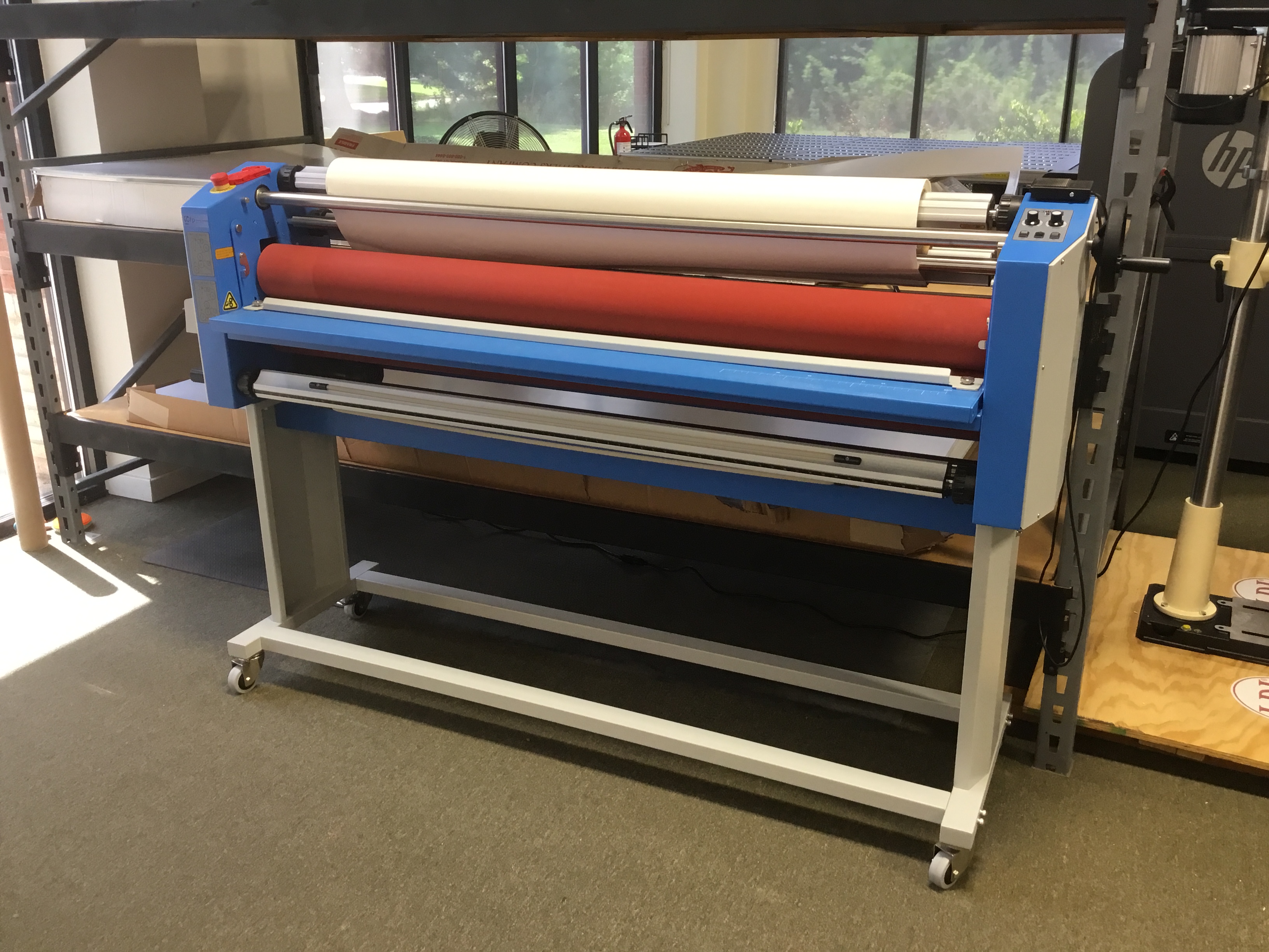

    I have a new GFP 363TH roll laminator but am thinking about getting a CWT or Rolls Roller table. Would there be a reason/need to keep the GFP or would the table make it obsolete?
