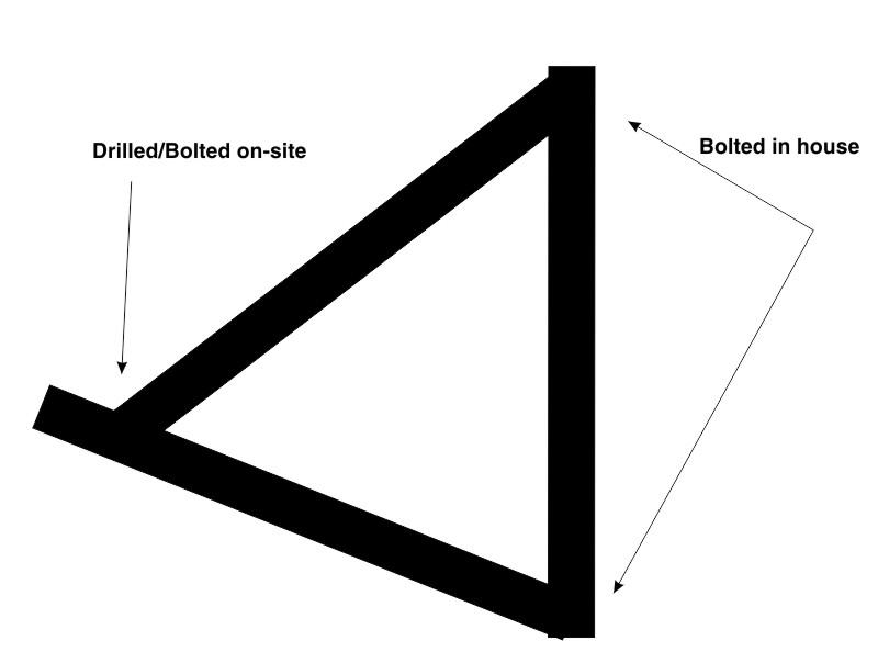

Does anyone know of a supplier of brackets for mounting signs on a roof?
Every time we have to mount a sign on a roof, we design brackets and have them made. The difficult part is getting the pitch exactly right so the sign is plumb, or making the brackets adjustable, which is much more complicated.
What do you all do when this comes up? Do you custom make each bracket and shim if required or do you make them adjustable?
J Hill Designs
adjustable

I guess I'm a hack since I have used slotted angle on more than one occasion.
Also have used steel angle and aluminum angle with the final hole drilled on site.

installed with lags into truss's or the preferred method of through bolting and plating behind the truss
Billct2
We usually put a piece of adhesive back roofing membrane under the bracket and either roof tar (from caulk tube) or clear silicone on the penetration then over the head of the fastener.
