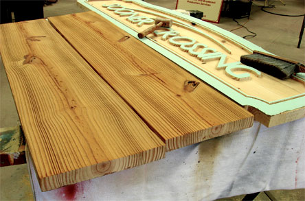

Here's one of the opportunities. At one time all my signs were blasted but when Clear Heart Redwood became so expensive and rare I was left HDU. That material has no qualities of it's own and has it's own limits. Never before had I even considered using Yellow Pine or Rough Sawn Red Cedar. Now that's my main materials. It's available at the local Lowe's and is cheap.

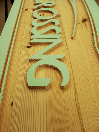

I had mentioned earlier it's necessary to have good depth with letters standing above the background. With most lumber that's almost impossible by sandblasting alone. Blasting works best on soften woods. With the router it's possible to hog out the background and lightly blast. This gives the best of both worlds using otherwise lumber that wouldn't work.
When I started this adventure, three years ago, Yellow Pine would warp, split, and bugs would eat it alive. Nothing could be further from the truth. Same goes for cheap rough cedar.
Another advantage is I no longer use sandblast mask. If there's a need for blasting I cut 1/8" pvc and brad nail it down. What a good resist for blasting.

Nice tip.We don't sandblast any more but when we did we used a technique that was similar.We would coat the blank out lay down a low tack gerber mask ,spray glue (with photo mount)1/8" pvc onto the mask rout the first pass with a v bit or a down bit then hog the rest out with an up bit staying away 1/64 from the letters so as not to tear the mask ,blast the b'grnd ,paint then remove the mask and the sign was done.
