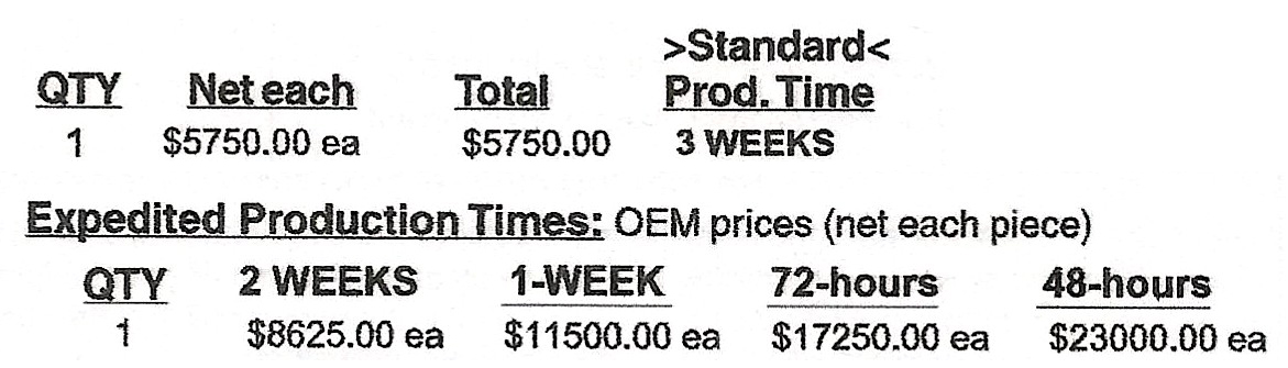

Thought everyone would like an update to fixing the RS. Just received a quote from a custom CNC company to manufacture a custom gear for the RS Laminator. Make sure your sitting down! Clip is scanned from a quote we received, I didn't want to show the company or other information, so I just clipped it.

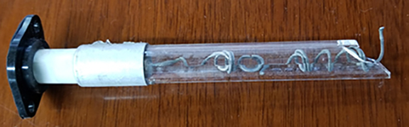

1. Bought the laminator (RSC-6500H), received an extra heating element glass tube...couldn't understand why. Heat wouldn't work and notice noise from the rolls. Opened the laminator up and found the glass tube was already broken inside of the top roller. That's why they shipped the extra tube. Found out accidentally RS knew it was broken and didn't say anything. Had tech come out, took the top roller off, stood it on end, then the tech, me and another employee had to gently roll and shake the roller to get the majority of the broken glass out of the inside of the roller.

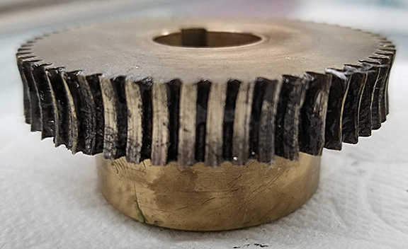

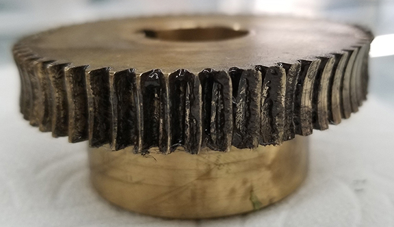

3. Roller would not raise up anymore. Would go up a certain distance, then drop back down. Opened up the side...the worm gear was already worn down. Never in 30 years have I seen a laminator gear get worn down, especially in less than 2 years. Warranty up, $1300+- for part and tech to fix. Talked to RS tech, stated I am applying too much pressure :mad:. "I don't think so!" I know the pressures to use, plus this laminator has a beeper that stops you from going over too much pressure and makes you lower the pressure if needed, plus I'm following the "user manual specs".

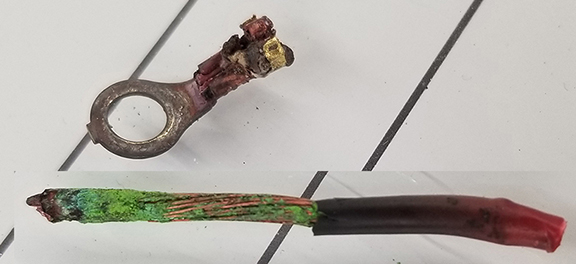

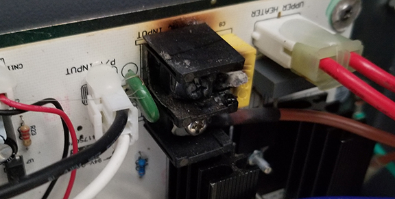

4. Kept smelling like something was burning. Opened up the laminator and found that the heating element wire connector was all burnt. Needed a electrician (customer) repair the wire and add a new fuse. Tried to get a hold of RS to get a new part for 2 months, finally got an automated phone message that they are closed...so no more tech. :thumb:
5. AGAIN!!!...Roller would not raise up anymore again! Would go up a certain distance, then drop back down. Opened up the side...the new gear was worn down again...after 8 months this time.
