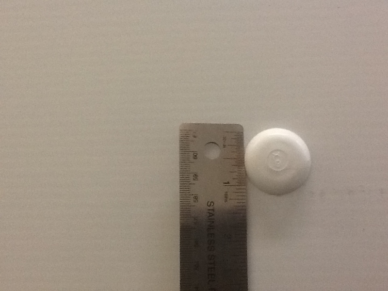

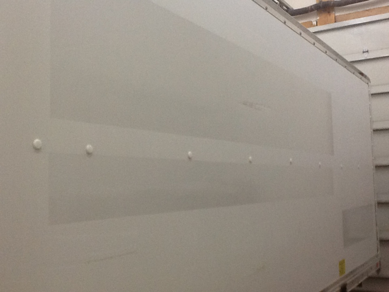

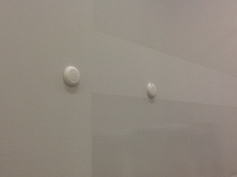

Anybody ever wrapped a box truck with what I can only describe as rubber or plastic rivets? I assume I can use primer 94 on these. Any other suggestions for good adhesive bond on these?

They are plastic. I would not recommend using P94 on them. If you don't own one already, go buy a Rolle Pro and practice. Otherwise, with the large flat surface on the tops of these, simply wrap over themand then come back with heat and a pop-pen and work them down.
jfiscus
Rap Master
I've used primer94 on them with good results (with 3m vinyl). Vinyl does not stick well to them at all otherwise in my experience.
