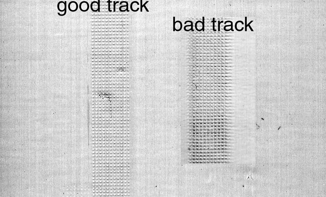

Tracking issues: shure you have autoload enabled? With this option enabled (is enabled by default) the plotter will spool media off the roll before plotting, to avoid running into roll weight while plotting. Do you use the media flanges? Check the backing of the media you use, and compare the grit roller tracks with the attached image). Do you reduce the pinch roller pressure?
