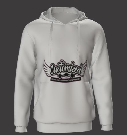

HP Applications Center is a component of PrintOS, and today it consists of 18 separate cloud-based modules, across four application disciplines:
  • Wallart Suite (6 decor-focused modules)
  • Signage Suite (10 display-focused modules)
  • Retail Suite (custom gift wrap)
  • Premium Apps (face masks)
Many of these have 3D rendering capabilities to enhance presentation and help drive sales (see attached screen grab).
These are all available for use at no cost to users & customers of most HP large-format printers - free availability is not limited to a 12-month (or any) term.
