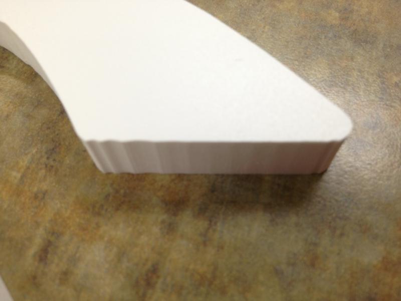

    This is 1/2" sintra routed with a 1/8" bit on 3 passes, I get this consistent chatter in a few spots. Could this be a mechanical problem, or is it the file (we can not see the chatter in the file). Thanks all, balmy 117 today!

    Sorry here is the pic

    I wonder if the bit is too small - 1/8 doesn't allow much of a kerf width to clear the chips away, they could clogging the bit?

    Looks like your material is moving on you, even slight movement up and down will cause that - especially with a an up cutting bit.

    +1 for material hold-down issue

    it looks like to many nodes in the arc. I cut 6m 12m 18m and 25m sintra all the time with a 1/8 bit and don't have that problem unless the file needs cleaning up

    are you using a single or double flute bit?
    I've had chatter like that using a double flute on 1/2 pvc before

    The material is moving or somethin' is loose on the machine. Check if you have any play in the X and Y axis. If you can move any of the axis simply by pushing back and forth, it's the machine. Play can develop over time in the rack and pinion. A driver card can burn out. Try cutting small circle and check if they are round. If not, for sure it's the machine.

    We changed the acceleration from auto to slow.....now it's smooth as a baby's butt!!!

    +1 Starsign. I had the same trouble with 3/4'' MDF using a 1/4'' bit. I contacted Gerber about it a few years ago and was told it is caused by lead-screw wear (the problem didn't show up until after many years of machine use). I've found the "Auto" setting sometimes doesn't slow down everywhere it should imo. I also now use the "slow" setting exclusively for cuts where appearance matters.

    X and Y axis lead screws is a costly repair. I know because we just went down that road w/ our gerber vendor. 3 passes on 1/2" sounds excessive w/out knowing the material in question.

    Which doesn't mean the cause wasn't the material moving around during cutting. All your doing by slowing down the acceleration is slowing down the speed. I don't know about you, but I can't afford to run my machine with slow accel. It's also tough on the tool bits.
    When my lead screws were going bad I didn't see any decrease in edge quality, just constant Y axis failures coming back to Y0.
