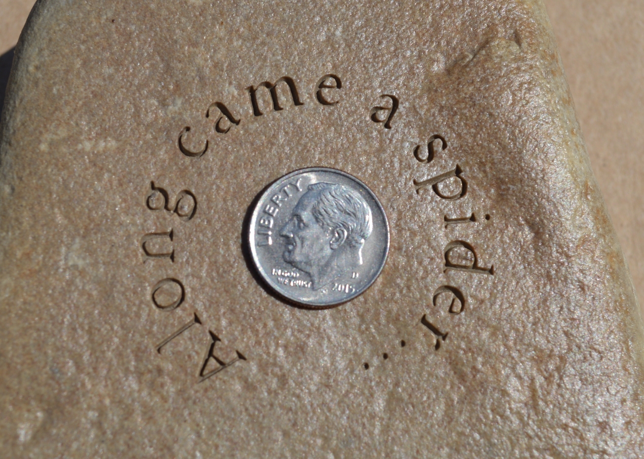

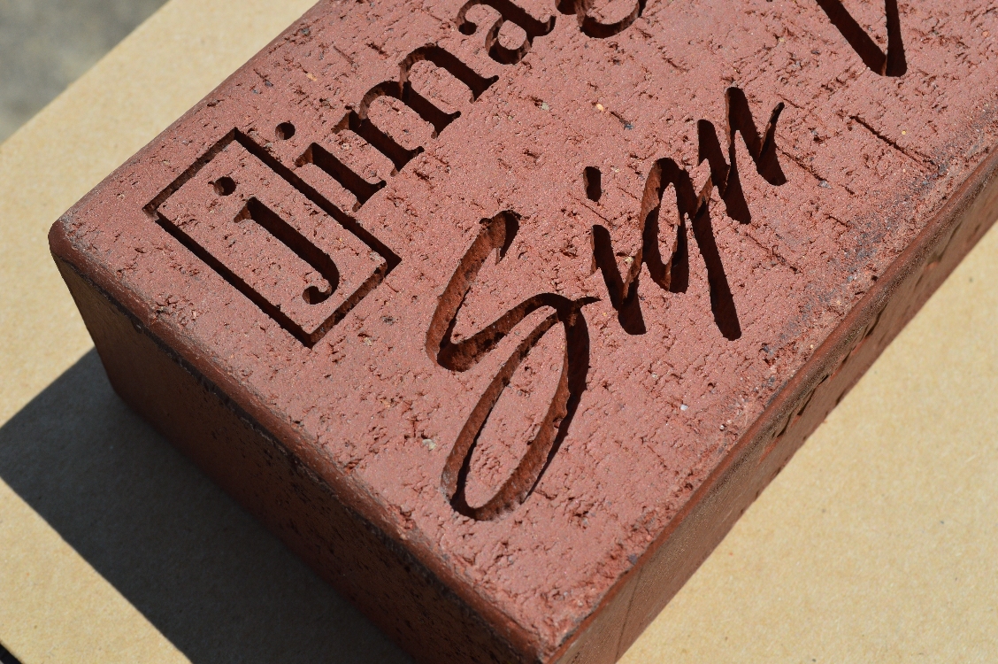

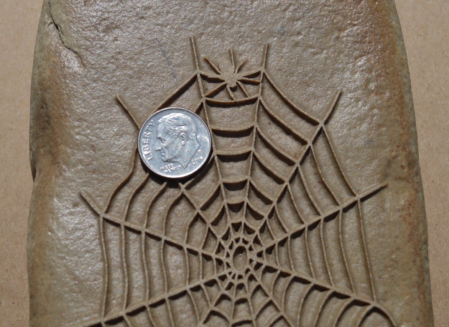

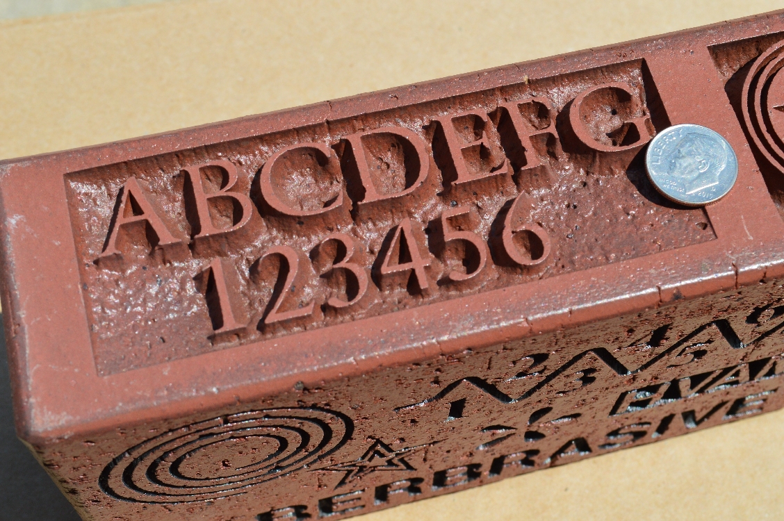

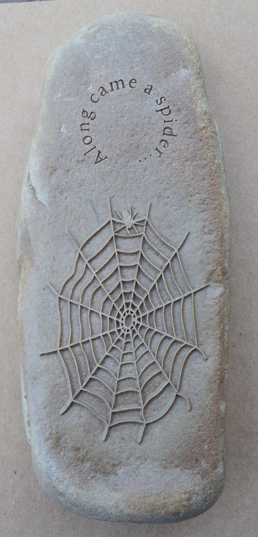

Here's a few projects where I used plotter-cut sign vinyl for stencil. I've posted these before in a couple of the other threads...just thought our big bunch of newbies might find them interesting.
JB

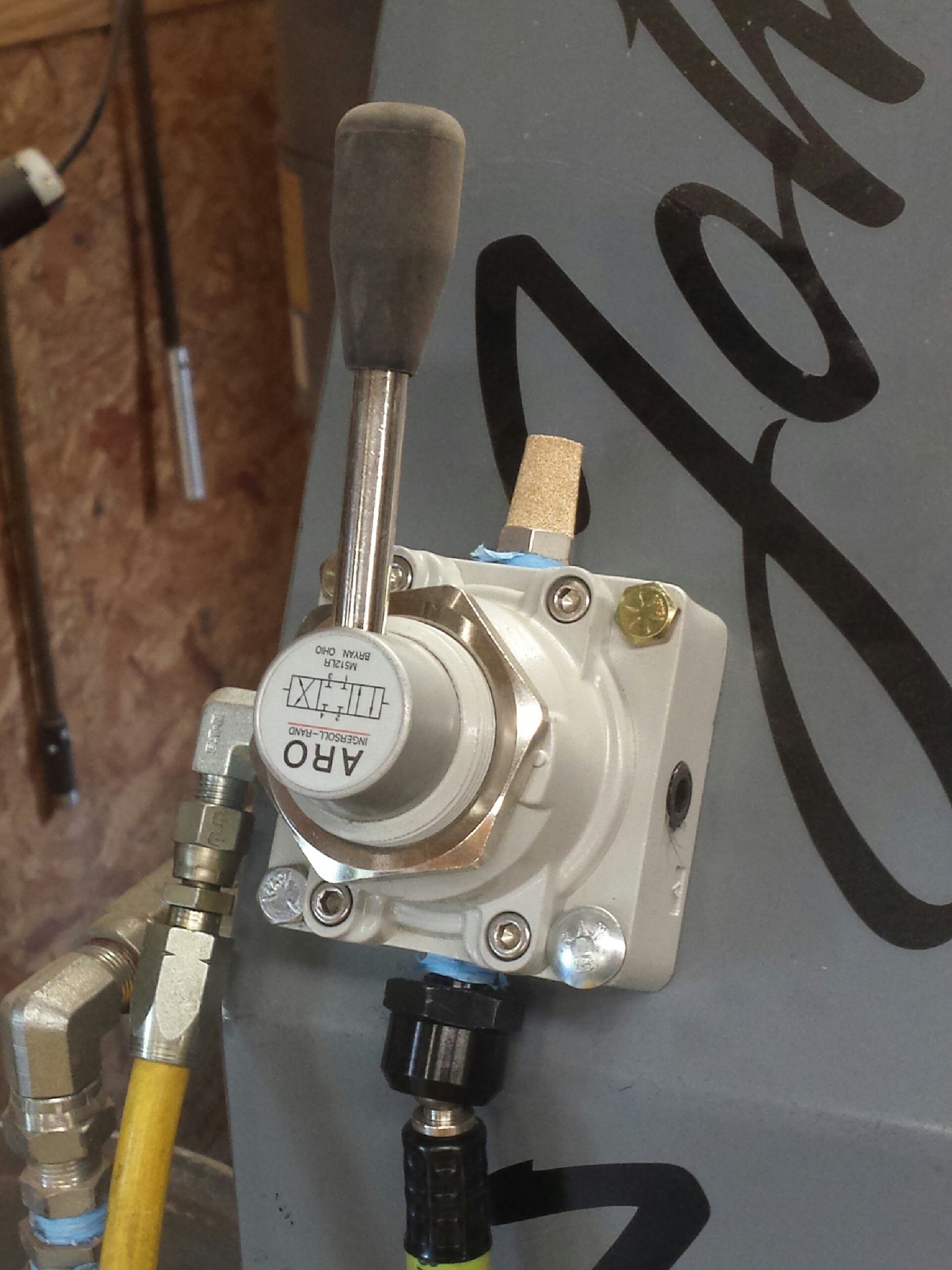

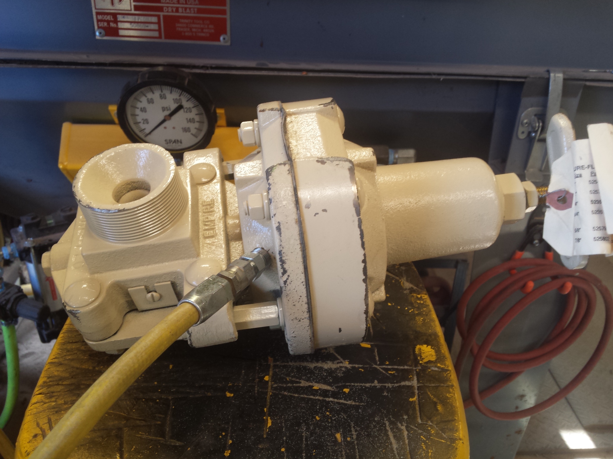

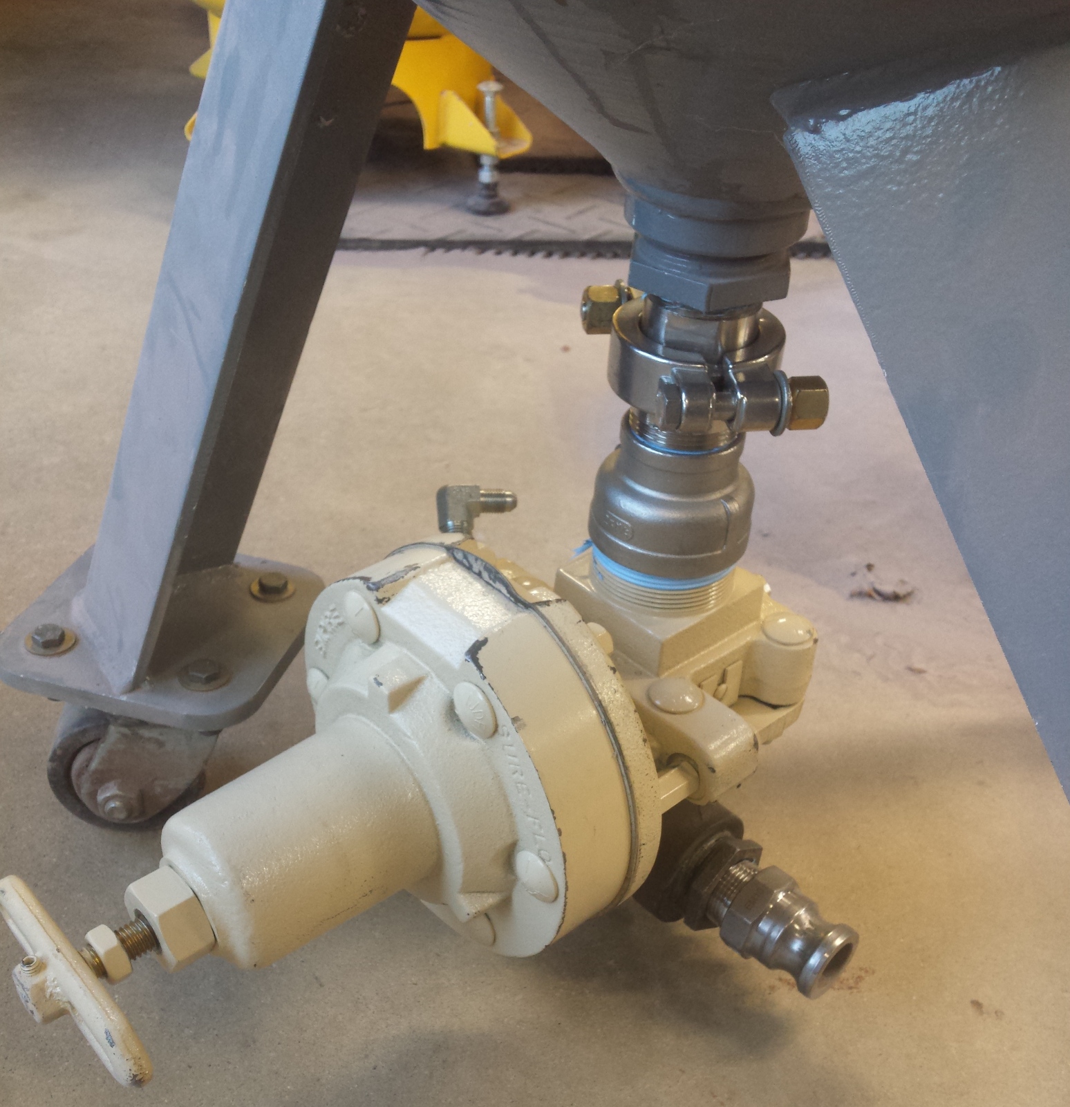

I'm running a Clemco pot with an air-actuated (diaphragm) Empire Sure-Flow metering valve, shown below. It runs on a 3-way manual rotary air (valve) switch shown in the last photo. I start the blast air first, and then throw the abrasive switch once the blast air gets up to full speed. When I"m done blasting, I shut off the abrasive flow, then wait for the hose to clear and then shut off the blast air. This process eliminates the sputtering and surging associated with most blast pots starting up.
Again, the abrasive falls from the bottom of the pot in a perfectly straight line through the pinch tube valve and then into the jet stream of the blast hose. The cam-lock nipple is the "air inlet" side of the tee...it's also called the pusher hose. The blast hose connects on the opposite side of the nipple.
In the second photo, I was bench-testing the valve with an air hose to make sure it opened and closed correctly. When the valve is opened, the abrasive falls down through the large chamfered opening...which is another reason this type of valve is so crazy good. The hole leading into the pinch tube at the bottom of the large chamfer is approx. 7/8" diameter (outside diameter is a 2-inch pipe thread for reference).
Now the "bad" part...an OEM valve runs just north of $700. Mine paid for itself in just a day or two...seriously, it's that effective.
