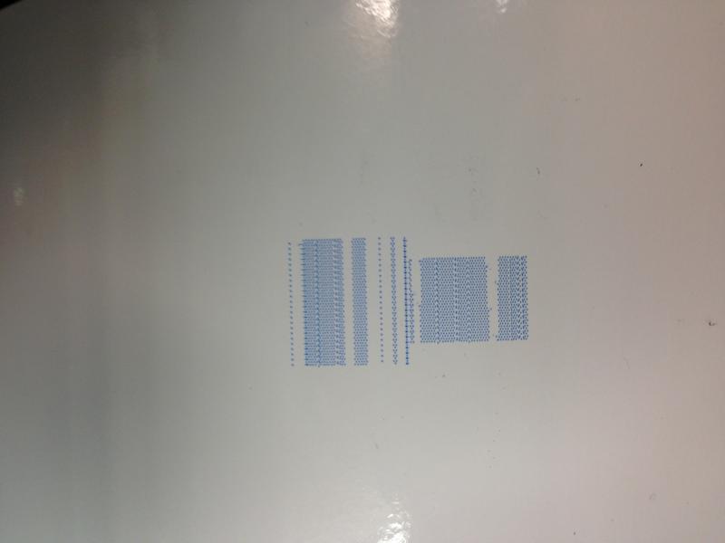

I'd still like to get this machine working though, here's a test print from today.. still the same thing, and more suggestions?

Noticed something new yesterday.. if i move the head all the way over to the end of the paper(base point 12" or so from end) the test print comes out almost perfect. if i start in the middle it's better than the ones I've posted but not as good as if I start all the way on the left side. So going to replace a few cables as the tech says I need to and see if that helps

hi all, sorry for my english i write from italy. I have the same machine!! you can clean the transparente string rear the carriage. In same times when i clean the entire string in trasparent plastic che quality return to normal. the string is very small, long 1.30m e height 2 cm. If you have problem contact me without problem!!
tomasimattia
sorry i forget!! small residual powder in the string cause a read error of carriage and the printing create banding.... the string is use for the machine to read the position!!
Papajo
The problem you have is that your machine cannot clean properly. Given the problem is present on every head, that's probably because the head carriage isn't properly aligned with the cap tops during cleanings.
You should watch from the front side if your cap tops are properly centered on the heads. If not you'll have to loosen the four screws that fix the capping station on the bed of the machine, then move slightly the whole capping station to the left or right so that the heads are aligned to the cap tops during cleaning.
Then you try a medium cleaning & test print to see if things are better, if so you can tighten the scews, close your machine and smile happily...
EDIT : Another way to check if your cap tops are properly aligned is to plug a syringe at the bottom of a cap top (just unplug on the Y junction and plug your syringe). If you feel no resistance and the syringe fills with air, the cap tops are either leaky or misaligned.

When the first pass is OK and the second pass has missing areas, it is usually indicative of ink starvation. I had similar problems. Because our print room is really not warm enough in the winter, it makes things worse. The first major improvement I mades was to replace the standard dampers with the larger versions which are available. This increased the ammount of ink immediately available to the head.also in cold weather I have to run the printer at a slower speed (typically 750mm/s instead of 1000mm/s on our 745ex) particularly when printing large areas of the same colour. to see if inkstarvation is your problem, just run the printer at a slower speed (no cost, no effort!) or at the highest resolution which runs more slowly.and see if that solves the problem. If it does, then larger dampers may alleviate the problem.

Just noticed your comment about the test being OK if it is further over to the left. This definitely points to ink starvation. The first pass is OK but the ink is not replenished quickly enough for the second pass. When the test is further across, it takes longer for the head to return home then come out again giving the ink enough time to replenish the head before the next pass.
I should add that I use third party bulk ink which appears to be more viscous than the Roland ink so precipitating the supply problem particularly in cold weather.

I've soaked it over night twice now, didn't help the print one bit :banghead:
I've cleaned the encoder strip and replaced the sensor.

I've checked this with a syringe, and it seems like it's aligned correctly.
Thank You!! I actually tried printing at 500mm/s and it got better but still not good enough, at 250mm/s the print looks PERFECT as it did before this problem started, but it takes SO long to print! I ran a few jobs at this speed and all is well, so now I just have to figure out the ink starvation problem.
Where can I get the larger dampeners? Mine were all just replaced but it's worth a shot to try the larger ones.
